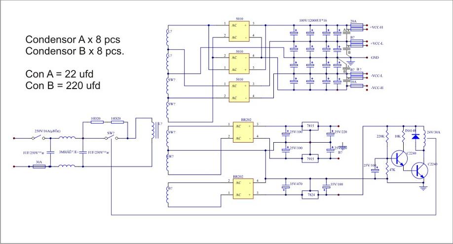

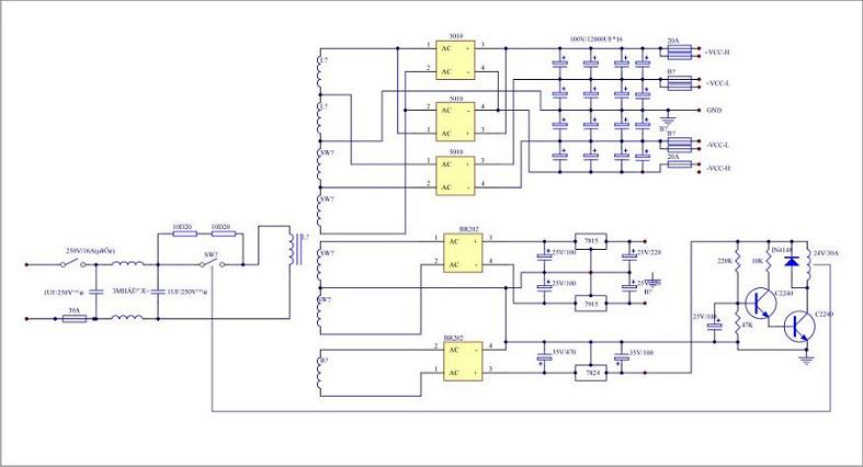

Thanks djk!
U r helpful as usual.
There r 16 electrolytic capacitors in the amplifier.
This means i hv to use 1nos. 6 22~100 ufd capacitors. For kick bass what value between 22~100 ufd preferable.

Most big amps have a ±low rail and a ±high rail. The caps on the low rail must be on the outside of the OR-ing diodes, right on the main filter caps (the outputs are connected on the inside of the OR-ing diodes).
A Crest CA12 uses four 30,000uF (actually eight 15,000uF) in the main supply. The high rails have 22uF electrolytic plus 1.5uF film, the low rails have 220uF electrolytic plus 2.2uF film.
Sometimes you may have to place a small resistor (snubber) in series with the film caps. They may cause oscillations if the grounding scheme is not right. I generally try around 1R, or omit the film caps if I have a problem.
D3, D4 are the OR-ing diodes.
