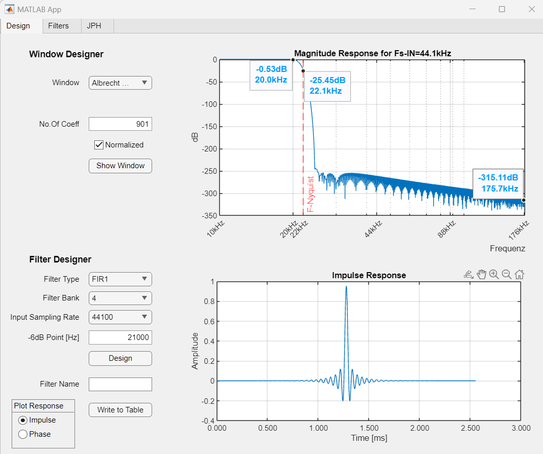

This app is for designing FIR and IIR Lowpass Filters for Soekris dam1xxx (in next release also dam2xxx)
The type of Filter, wether it's an interpolation Filter, an decimation Filter (for DSD) or just Lowpass(IIR) is selected automatically.
Currecntly you can design FIR Lowpass Filters with the following techniques:
You can verify the designed filters right away with:

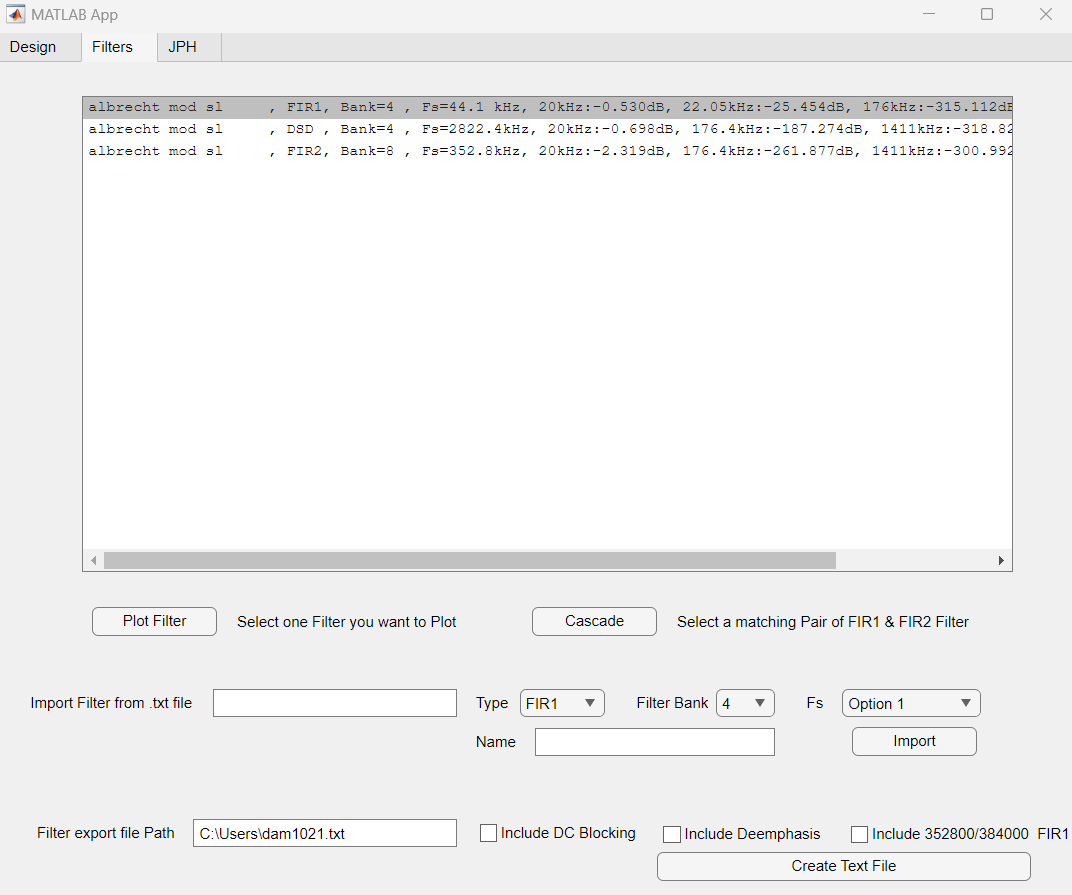

The designed filters can be stored to a list inside the app that does all the sorting for you.
In this "Filter List" the filters are shown with their properties:
The magnitude response estimate however does not work for caseded filters...
Next feature is the import of .skr filter Files:
You can import ANY .skr filter file, no matter how old, plot the responses and add them to your "filter list".
This way you can import your favourite old filters and mix and match them with new ones.
Of course you can export the designed Filters as a .skr file!
As filter design is not done in a day you can save your "filter list" as a matlab workspace (.mat) file that can be opend up later to resume your work.
- Spectral Windows (Standard windows like Kaiser, Hann, Blackman-Harris... and Albrecht 3-11th term, and Albrecht Minimal Side Lobes)
- Halfband linear and minimum phase
- Nyquist linear and minimum phase
- least Squrare
- ParksMcClellan
- Equiripple linear and minimum phase
- LeastPthNorm mixed and minimum phase
- Butterworth
- Chebychev
- Elliptical
- Quasilinphase
- Magnitude Response
- Phase Response
- Impulse response
- Step response
- Group delay
- Magnitude Response Estimate only valid for dam1xxx at the moment
- Filter type FIR1/FIR2.. ,
- Filter Bank F4/F5/F6/F7..
- key values (like attenuation at 20kHz)
- Input Sampling Rate
