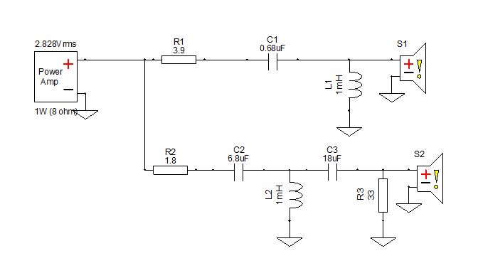

Hi Vortex,
I googled around and found this picture:
If this is correct, then the top board (in the pic) is the probably tweeter and super-tweeter driver. The coils are probably Jensen air-core, no reaason to change them. The caps you will be able to read the values off of them, and same for the resistors.
Given the hot glue, you may be best off making a new board and salvaging the coils, maybe not. 🙂
In any event, the important parts are the caps and resistors. My recommendation is to replace the resistors with Mills of equal or greater wattage, and use Clarity CSA or CMR (depending on budget) for the caps.
Best,
E
Below this board, you will probably find the midrange (the smallest cone). Again, if you want to, I'd suggest you replace electrolytics in series with the same caps as above, leaving the coils alone, and leave any shunt-caps alone too.
Best,
E
I put together a quick XSim from what I can see you'll find it attached. This should be treated as guess-work until you can validate the ins and outs yourself, but I thought it might help you get started.
C1 is the yellow cap which I can't quite read. I am guessing it says 0.68uF
The coils you should keep as-is. No reason to change them, plus you'd have to measure them to find their values.

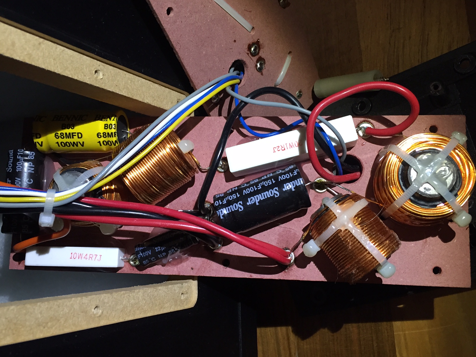

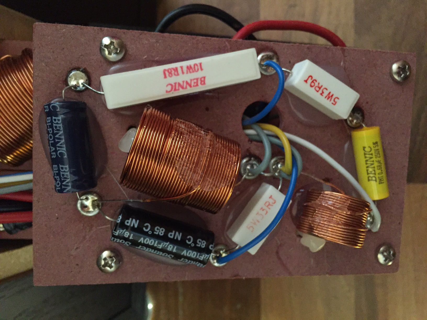

Hello!
Today I opened one crossover and there is pictures...

Hi Vortex!
Good job.
Seems like I got it pretty close. 🙂
What will you do next?
E

Mundorf MKP are my go-to caps for cheap but good. In the schematic I drew, C1/C2/C3 are your most important caps.
For the midrange, I might suggest you try bypassing the 2 caps in series with Mundorf caps about 1-3% of the value. So if you have a 100uF cap, use about 1uF to 2uF as a bypass cap. This will save you a lot of money. 🙂
Also, consider replacing series resistors R1/R2 with Mills of equal or greater wattage.

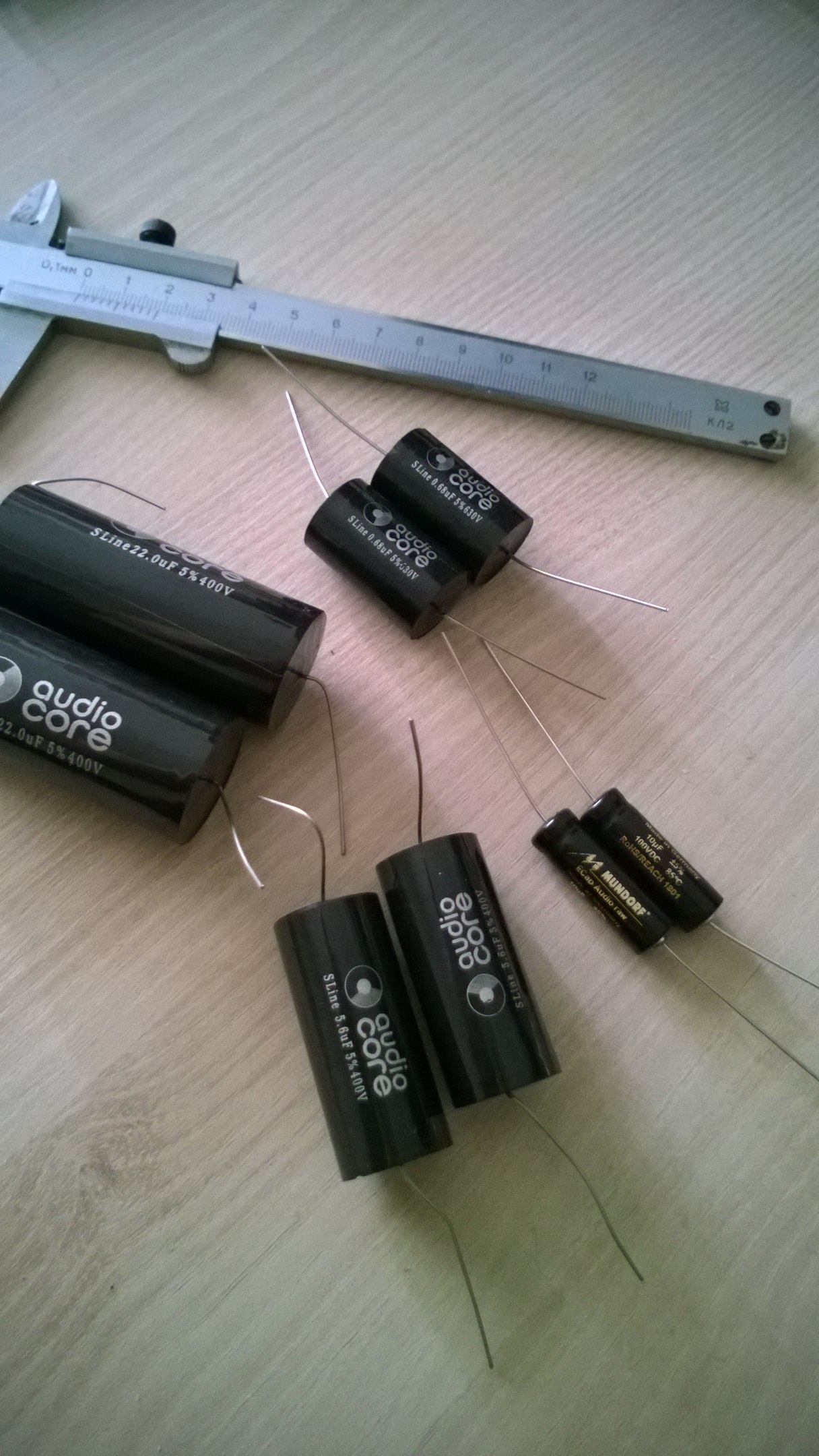

Some capacitors are Bi-Polar,do I have to use same or can I use other types?What you thinking about TEFLON-HYBRID capacitors?

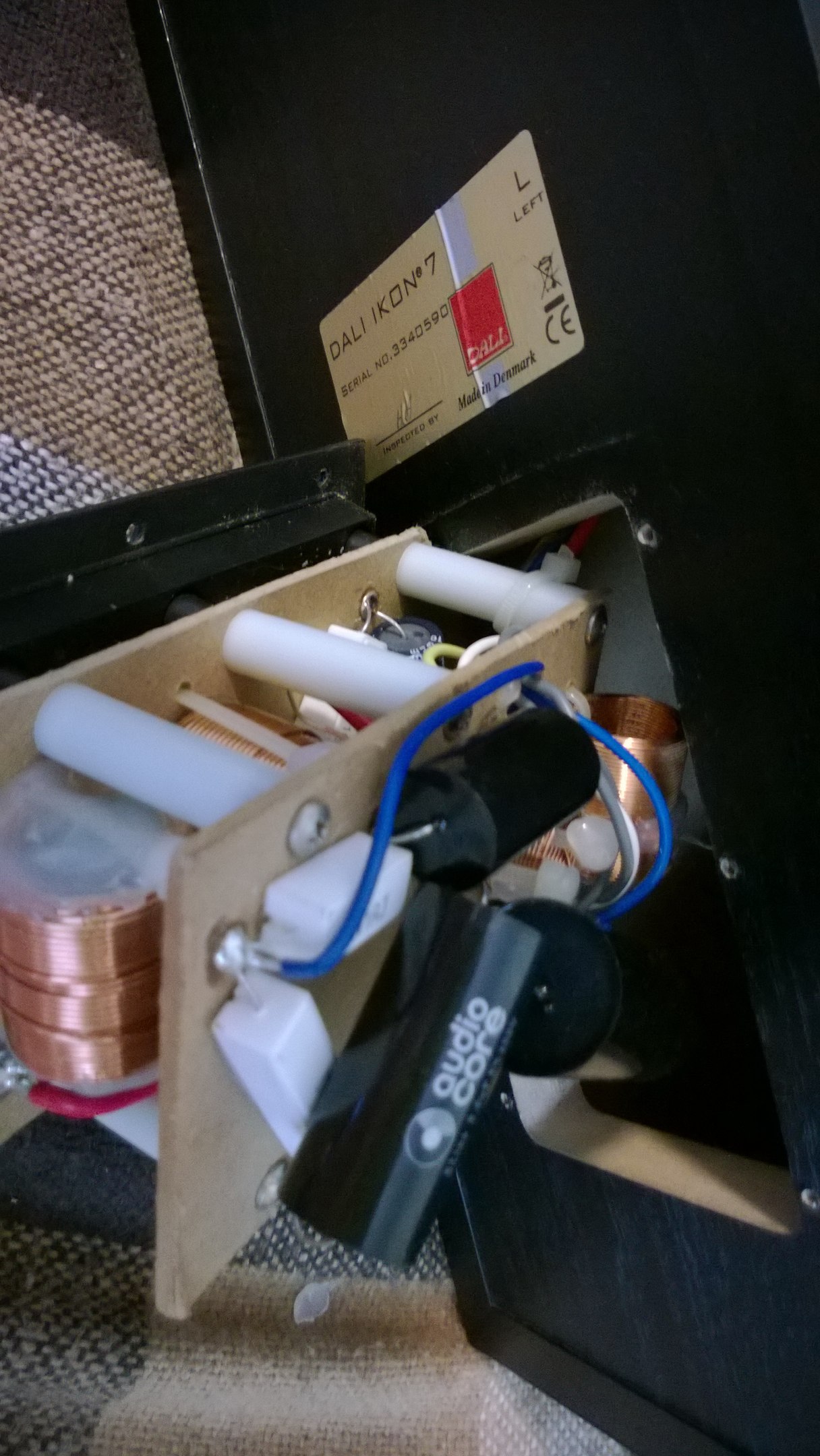

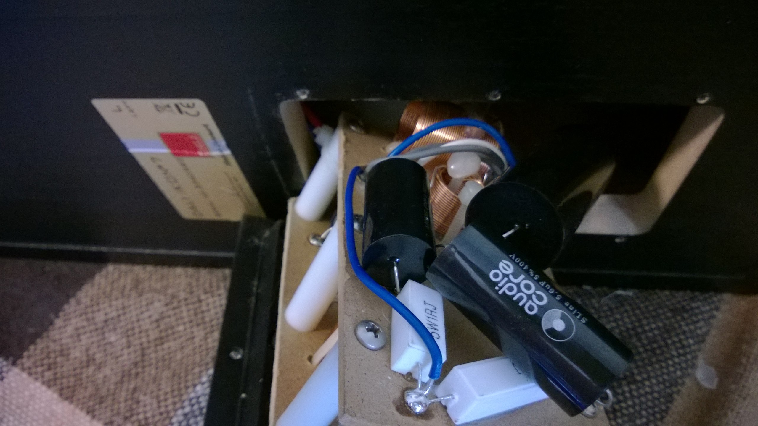

I made upgrade on my Dali Ikon 7 Mk1. Got an awesome sound by the way ! I also want to upgrade my new Opticon 8
