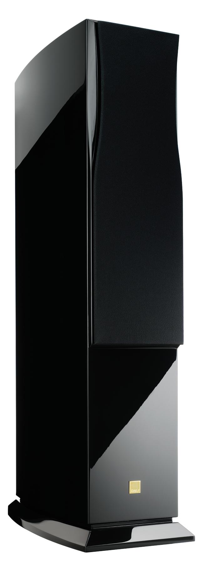

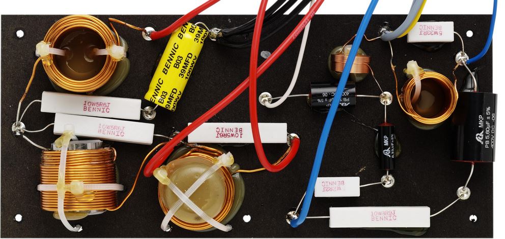

I have speakers DALI HELICON 400 MK2 LE25
Right speaker
lower drive unit mid bass not working
Something know where to buy the part please
Right speaker

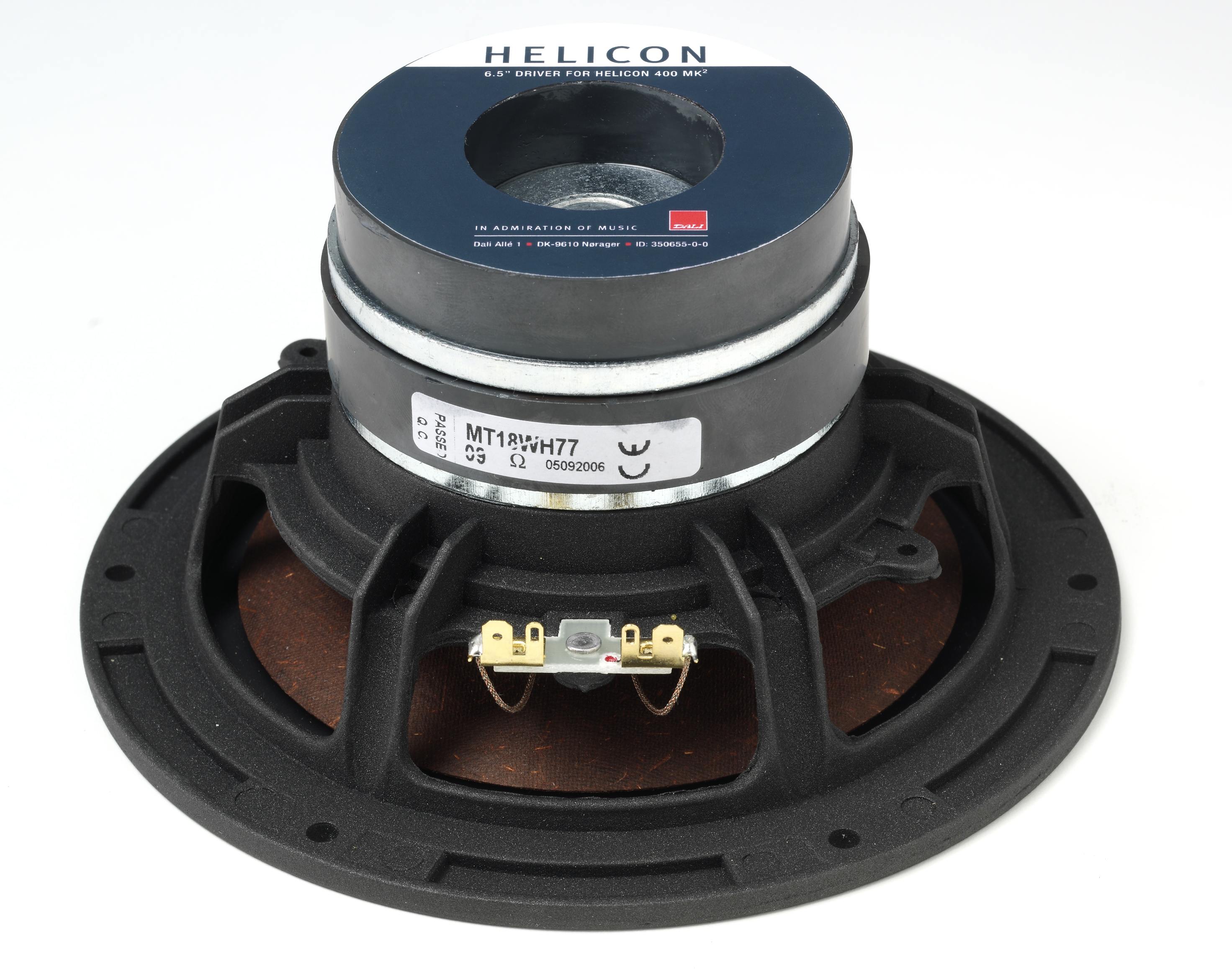

It must be a proprietary 6" woofer, though it looks like a high quality Vifa part.
Contact your dealer, I'd say. Perhaps it's under guarantee for defective parts too:
DALI Dealers in Israel
For all that, a loose connection or bad solder joint is more likely on a newish bass. I'd remove the drive unit, noting wiring polarity, and look at the soldering on the crossover.

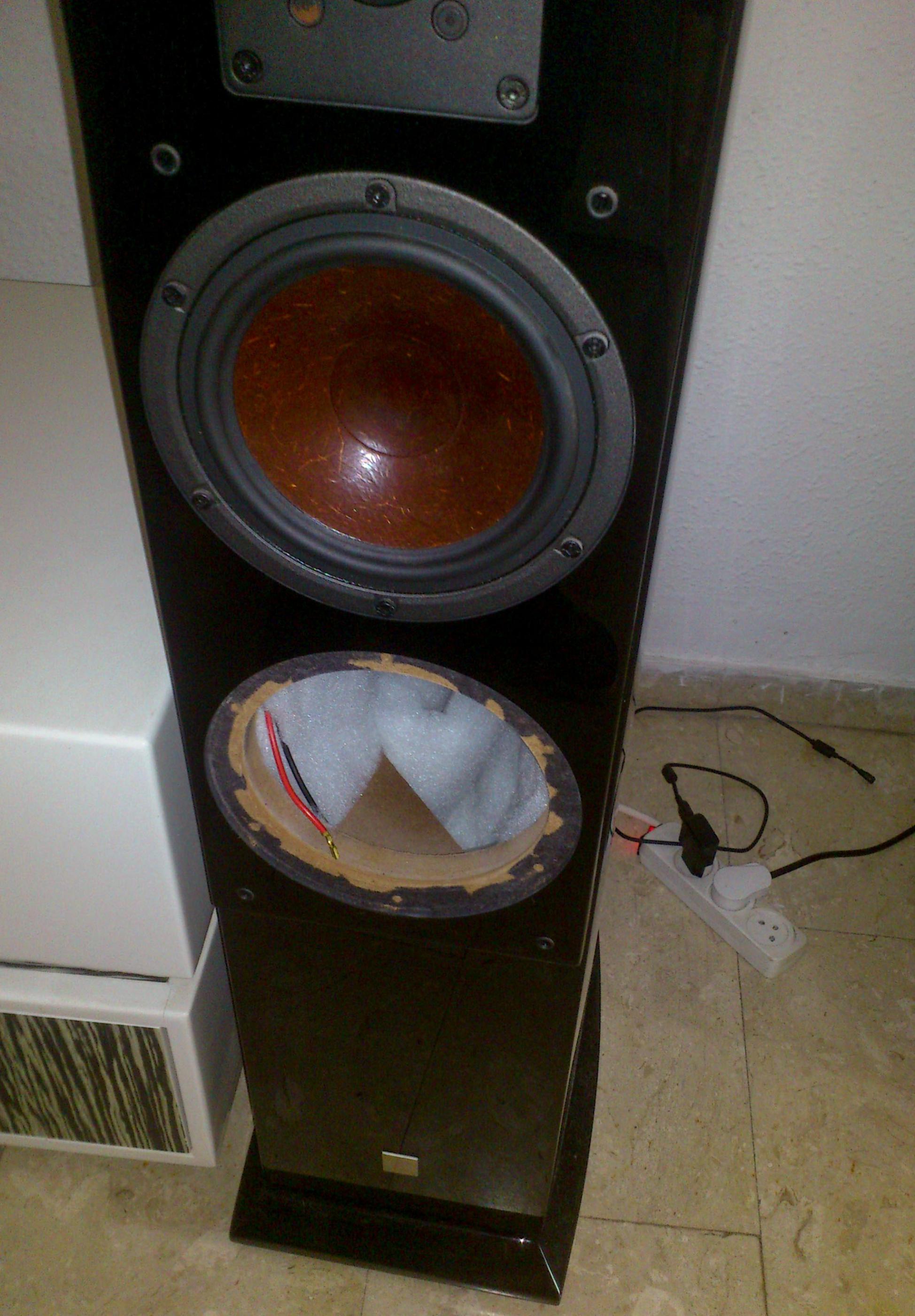

If I was a betting man, I'd think a wiring fault is the likeliest contender here.
It's not inconceivable the crossover has been wired wrong too. I haven't got the patience to extract the wiring diagram, but it's a 3.5 way I think. One of the basses provides bafflestep correction rolling off at 700Hz. Probably the lower one.
Traditionally you wire a 1.5V battery to a moving coil speaker and listen for a crackle to see if it lives, positive to positive and the driver should move outwards. Don't do this with a ribbon tweeter though. They are fragile with DC.

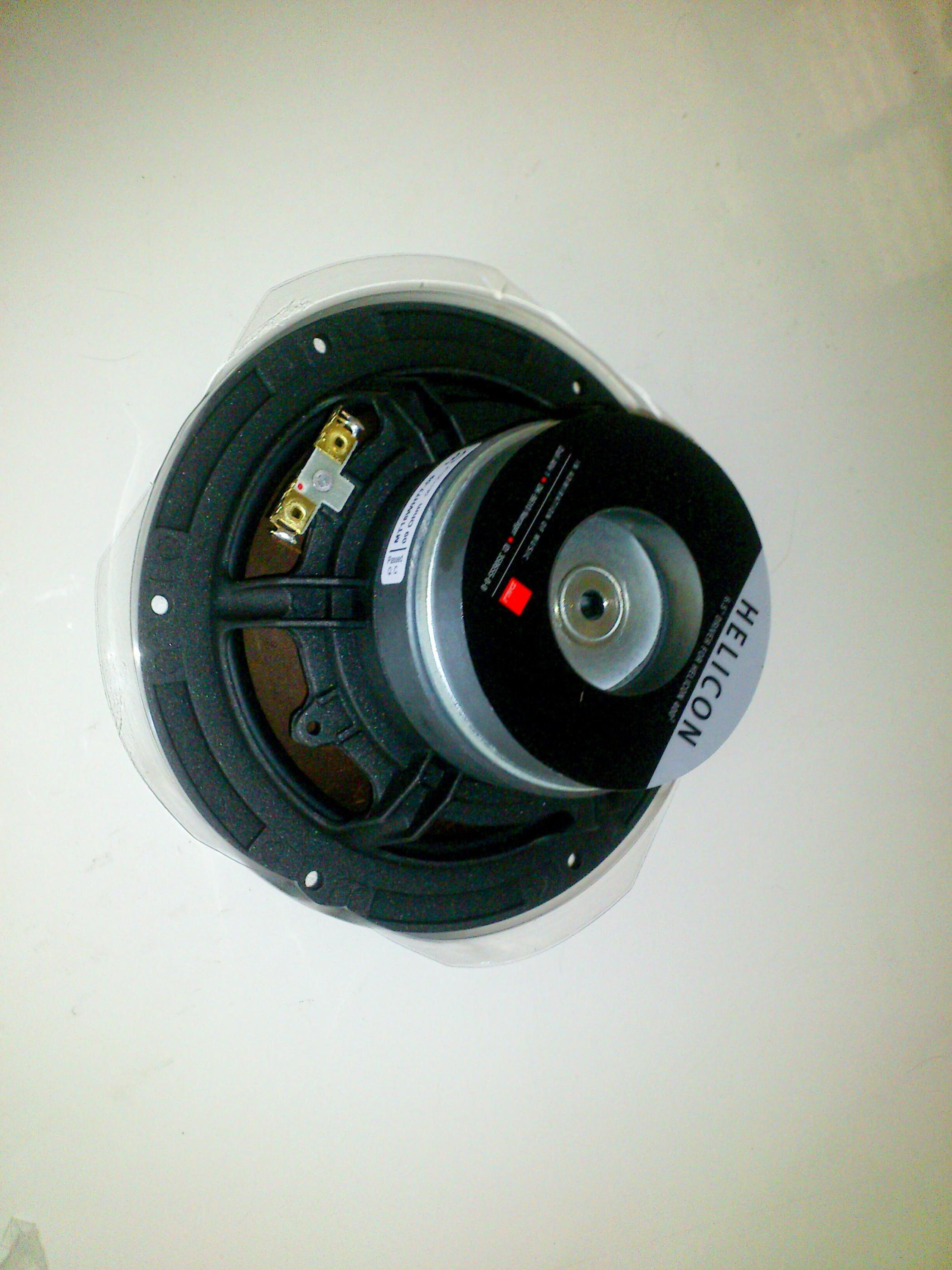

If the unit mid bass when I measure the resistance in multimeter
Show me infinite resistance
As should be the value of about 4 ohm
And when I plug in a battery of 1.5 volts to the mid bass unit no response
So I conclude that it is burnt
