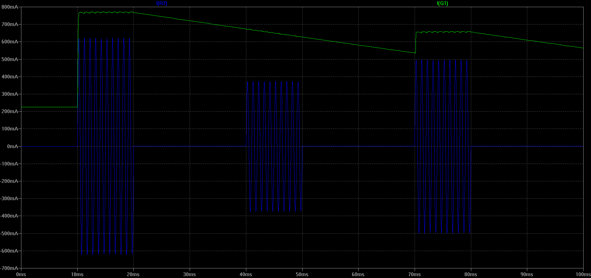

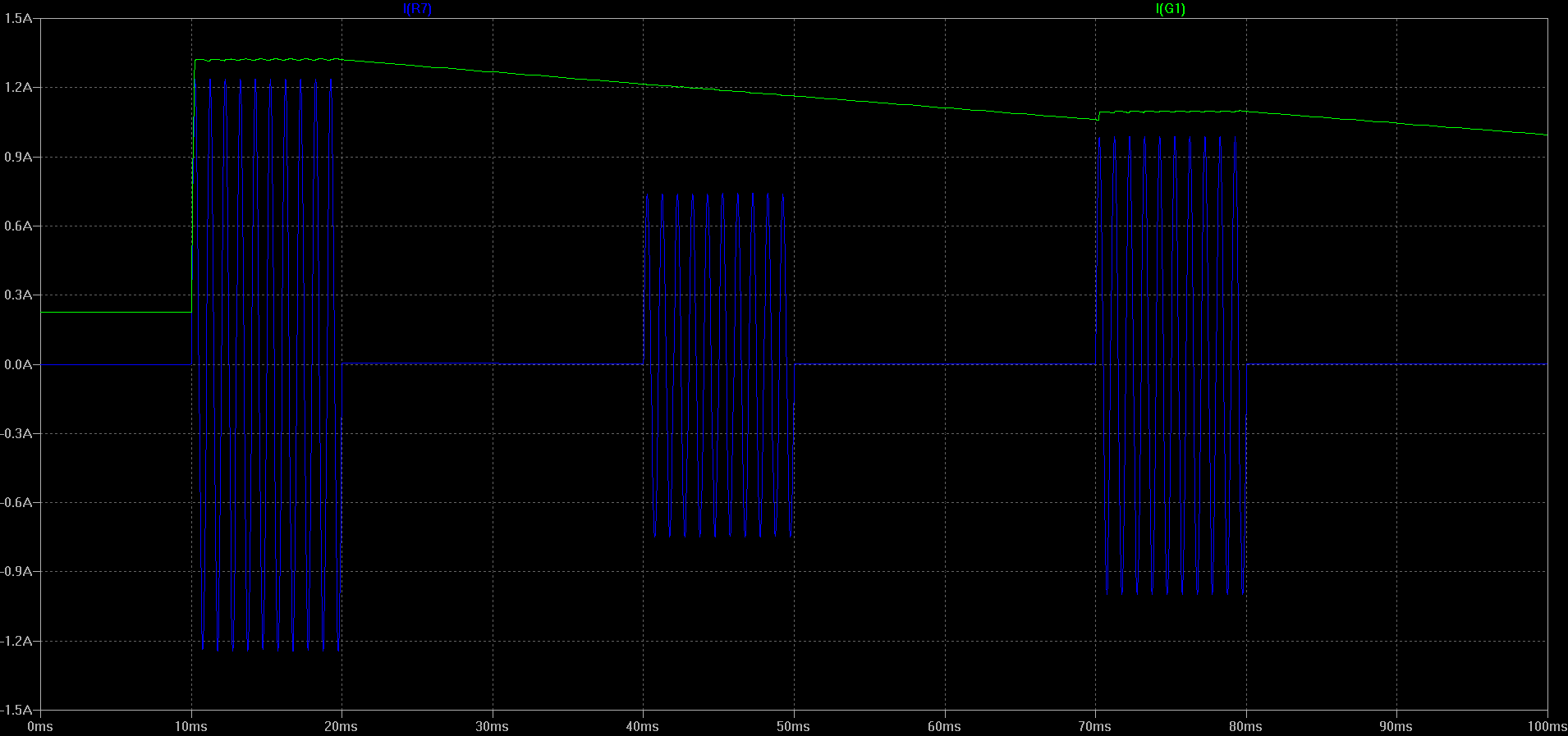

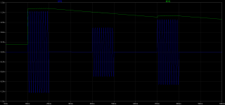

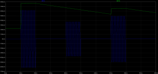

Maybe it is best to show how the bias current varies with some simulation plots. The first plot shows Dahlia driving an 8 ohm load. The blue line is the current through the load. The green line is the current through the current source, this is the bias current. The plot shows how the bias current varies when 3 successive 1kHz sine burst are fed into Dahlia. Initially, the bias current is low, ~220mA. When the first burst hits, the bias current is immediately ramped up to almost 800mA and stays there for the duration of the burst. So, the first edge of the first sine of the burst may see some distortion as the current through the emitter follower has to change very non-linearily. The rest of the burst is clean however. So this distortion, even though it is very small, only exists for a very short time period. As a result, this distortion is not audible (at least to my ears). The plot also shows how the successive burst are handled, the bias is lowered slowly and is still sufficient high to handle the second burst. When the third burst hits bias is again slightly raised. The second picture shows the same signal but then for a 4 Ohm load. As you can see Dahlia will adjust bias accordingly.
So, Dahlia adjusts the bias dynamically based on the peak level of the bias current needed by the load. In practice this results in a much reduced power consumption and hence smaller heatsinks are needed. I think this is pretty neat! Maybe it has been done before but I couldn’t find any design that does something similair.

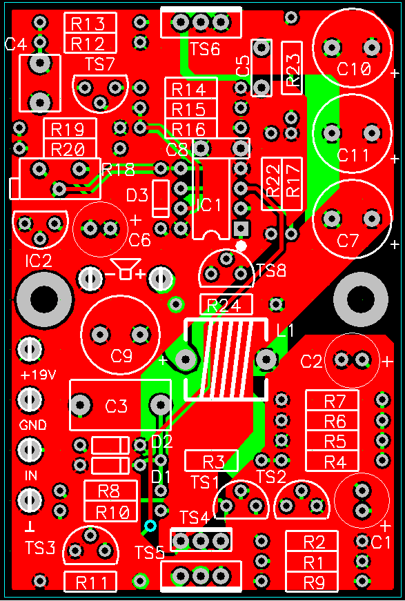

Block diagram and PCB's
This is the final installment on Dahlia.

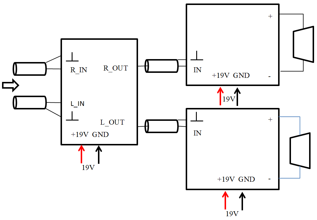

As said before, Dahlia consists of 3 modules (or actually 4 if you include the power supply):

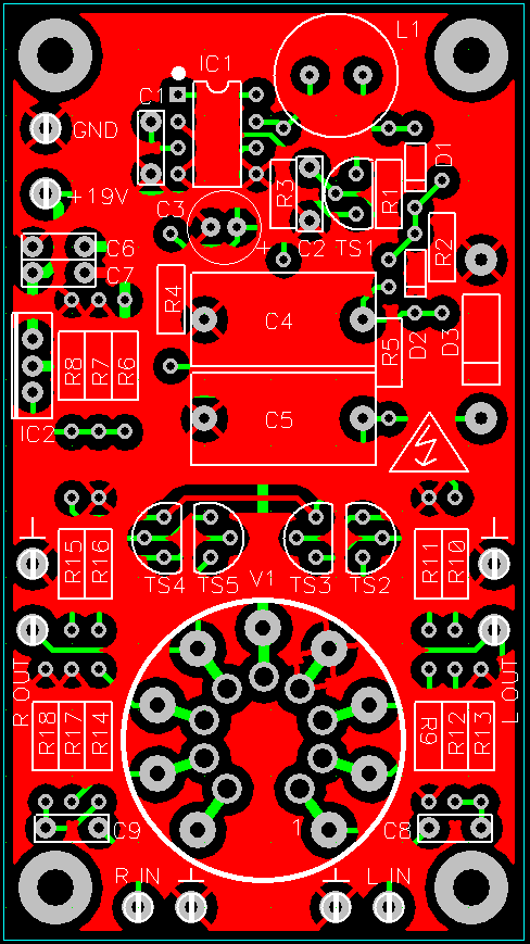

The PCB's are also shown, note that the current amplifier PCB's are designed to be mounted against a heatsink. The MJE3055 and the IRF9540 must be properly heatsinked as each can dissipate about 20W during peaks. Most of the time however, when quietly playing music, Dahlia will turn the bias down so that each power transistor only dissipates about 2W. I have measured the total power consumption of the amplifier at about 15W when idleing. This is actually quite a "green" amplifier 😀 The voltage PCB contains an LM317 that also needs to be cooled. I screwed this part to the metal bottom plate of the cabinet. Also, note that all of these parts need proper isolation and grease (mica, plastic washer and cooling grease).
So, what do you think of the design? I have spend quite some polishing this. The dynamic bias circuitry for example is a simple idea but to get it working properly is not easy. The same goes for the DC/DC converter. To get this to run without interfering with the audio signal is not simple. 🙂
Any comments? Anybody interested in building the design as well?
- A stereo voltage amplifier
- A current amplifier for the left channel
- A current amplifier for the right channel.
- A 19V...19.5V laptop power supply of at least 90Watts

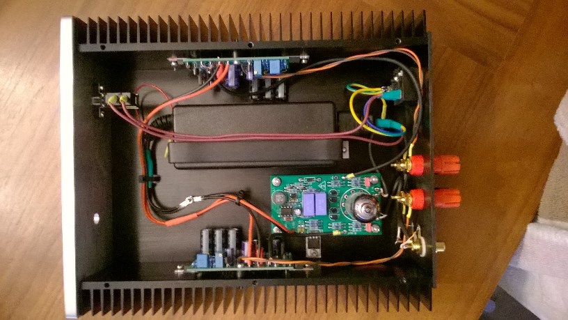

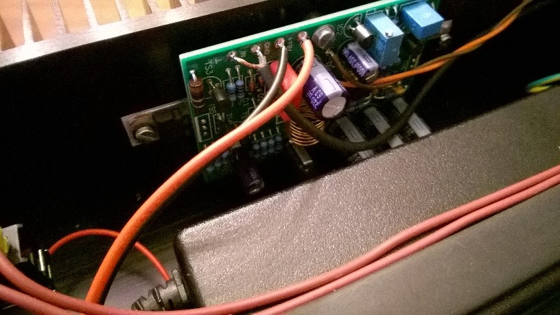

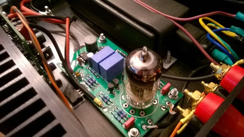

I have built the amplifier as well, I know the designer personally, a skilled man 🙂
The amplifier sounds really smooth, it has the character of a full tube amplifier. The output power is slightly too low for me. (That may also be because of my, well, inefficient speakers...)
If you would ask me whether you should build it or not, I would say give it a try! I built the amp mostly out of used (desoldered) components, it cost me about 25 euro's. It is very hard to beat the performance of this amp by a commercial amp (especially for the money).

Hi Joris
Your amp sounds good 😎. I especially like the case 😀.
How are the other builders doing (Cgraph?). I hope you also like the sound of this little amp...
