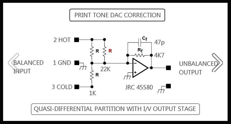

Stee Member Joined 2005 esafono.it 2012-03-17 8:33 am #1 2012-03-17 8:33 am #1 WITH THIS SIMPLE CIRCUIT YOU CAN HAVE A RCA PURE SIGNAL SOURCE FROM CANNON XLR DAC OUTPUT 😕 Attachments QUASIDIFFERENTIAL2.PNG 77.2 KB · Views: 96 pinkmouse Ex-Moderator Joined 2002 2012-03-17 9:11 am #2 2012-03-17 9:11 am #2 Please don't shout Stee. Stee Member Joined 2005 esafono.it 2012-03-17 8:02 pm #3 2012-03-17 8:02 pm #3 Sorry Status Not open for further replies. Share: Facebook X (Twitter) LinkedIn Reddit Pinterest Tumblr WhatsApp Email Link
