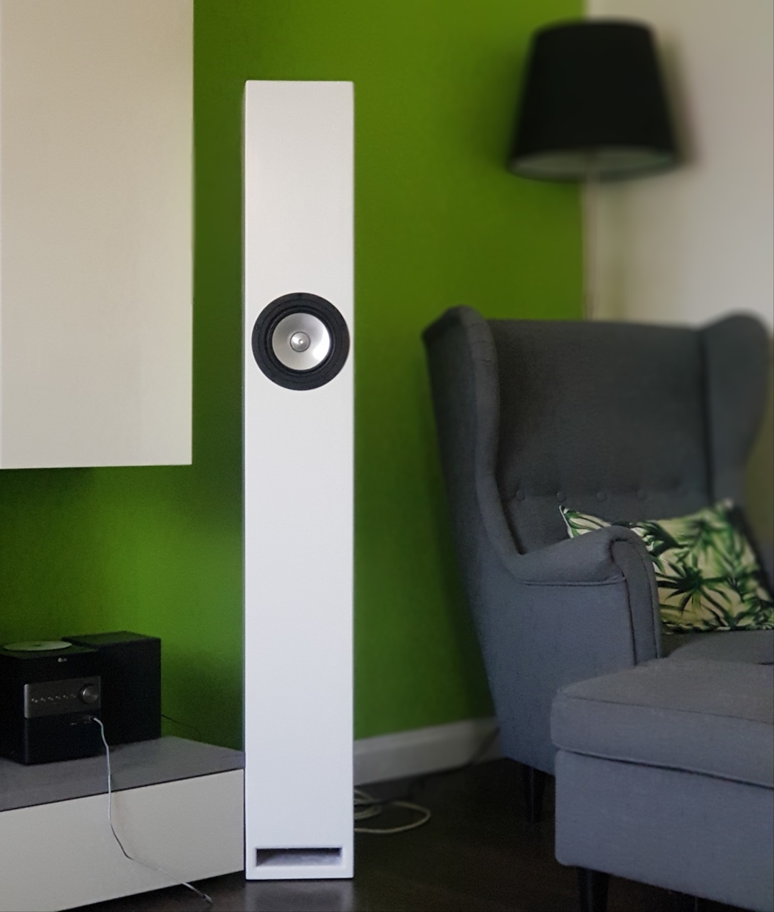

Finally I finished my Tabaq tl for the Markaduio cnh110 tomorrow I will also receive the DACBerry AMP² and I will start to do some rehearsals ..😀
