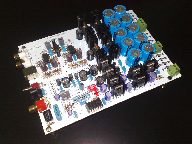

I have a DAC7 (V1.0) ( SDAC 100 v1.0) with a white board.
I lost the opamps that came with it ( 2 years ago !). What are the opamps that one can use. I was told the two presets on the board should be set to give +/- 15 V at the opamp supply pins. Apparently all three opamps are dual opamps.

I suspect pretty much anything will "work". They all look audio related, I would try either LM4562's or perhaps FET OPA2604. TL072's would be a good cheap replacement.
Thanks. I emailed another supplier who's picture showed V1.0 . Most others are V1.1 .
He said it was three TL072's though I'm sure I got far better opamp's with the kit ! I will try out the TL072's as I have many. After it works out OK I'll plug in better opamps. I have LM4562's.

The "usual" upgrade for the tl072 when a jfet input is needed is the opa2134. It looks like the output stage is a classical balanced to unbalanced converter and jfet inputs aren't required. If the dac output stage uses lowish values resistors (as often seen in datasheet to keep noise low), opamps made to drive 600R, such as the lm4562, should be better than the tl072; those are really awful driving low impedance loads.
I have some OPA2134 also and the NE5532 . So first it will be TL072 and NE5532 ! I can try the 2134 or 4562 later .

The circuit is based on an Arcam design, and those came with AD797, and OP2134 FWIW.
I have a similar one and it came with NE5532, and TL072 as delivered from Weiliang.
And I believe the supplies are closer to 12V also.

Oh, I have some AD797's also. Looks like I have plenty to try out ! 🙂
I'll set the supplies around 12 V.

Just found out the problem with the negative supply. Fixed it. Set supply at +/-12.5V ! Filter using TL072 and output is NE5532. Will listen to that for a while and then change chips . Only 2 days left. After that it's a 7 day holiday !🙂
Well, the DAC7 received the TL072's and NE5534.
I must say I never expected it to sound the way it did. It IS good even with the TL072's ! But on complex sounds it's a bit noisy to my ears. So after an hour or two I searched for the OPA2134 and found them. Put that in. It became much smoother. Bass is well defined and deep and HF is very good. On very good recordings the HF sounds great. So far I didn't hear any vocals that didn't sound nice. Very nice.
BUT there is a spanner in the works ! If you stop and start a cd or pause and start a song or skip songs you get a sharp hiss/crackle from the speakers.Sometimes short but sometimes a bit long. Destroys the start of a song ! What is it due to ? Junk going to the DAC during those periods?

Not sure what a solution would be for the noise problem. Your correct as to the causes though. Normally a CD player has all the logic integrated into the system control to take care of this. I suspect the DAC "firmware" doesn't do the necessary when it detects a pause or break in the data stream.

The Wolfsen WM8741 DAC chip has a pin for mute. Pin 25 which according to the circuit diagram that I got, is unconnected.
I looked carefully at the LED on the board which I think shows the presence of a digital signal. It flickers very briefly when the noise comes. It is normally on when connected to the player.

If you've seen comments about a noise issue then you can be pretty certain that its a design flaw of some sort... and a fair chance that the DAC9 may well have issues too.
The question is , is it just because they have not implemented any muting at all. They haven't, you can easily see it from the board. The mute pin is also unused. So if I implement a mute will it work well ? Use transistors ( like most CD players) or a miniature relay ? Most guys remove the transistors used for muting claiming they degrade the sound. That way the player does have switching noise but I don't know if they are similar to what I hear now.

Hmmm... I wouldn't like to say. Perhaps try transistors first and see if it works... in fact just use an LED and see if the mute line would be active when needed before rigging anything up.
Transistors if used correctly (and the correct devices) are fine. If the switching levels permit then use FET's.
