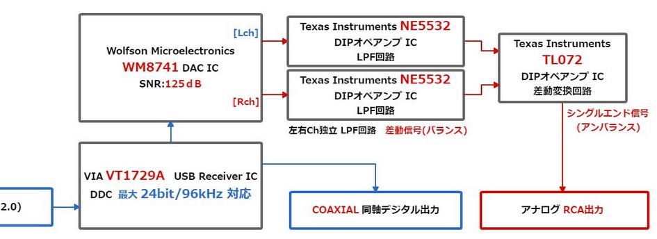

I saw a DAC's circuit, and the description for this DAC says (among other things)
"Triple Op-Amp Drive System".
The circuit contains
2x NE5532P
1x TL072
Anyone knows why is that needed?
Thank you

That diagram is a bit confusing. The WM8741 DAC chip features differential outputs for each channel. An NE5532 dual op-amp is being utilized for I/V conversion of each channel's complementary output phases. The TLO72 dual op-amp is being utilized to combine each channel's differential signal phases in to left and right single-ended signals. These then are sent out through RCA connectors. It's likely that those op-amp circuits also incorporate low-pass signal reconstruction filters. Where the diagram maybe gets confusing is that the TLO72 should depict two output signal arrows, one for each channel. Instead of appearing to incorrectly depict only a single channel.
Based on my own experience I reckon they got the opamps in the wrong order - better use TL072 first because its JFET and able to present a much lighter loading on the DAC without incurring noise issues. The 5532 has much better drive capability than TL072 so is much better suited to facing the outside world.
Yes, the DAC outputs 2x RCA,Where the diagram maybe gets confusing is that the TLO72 should depict two output signal arrows, one for each channel. Instead of appearing to incorrectly depict only a single channel.
the diagram's end is not showing it.
(or maybe it does, just in Japanese.. because thre's some Japanese text there in the box)
Interesting.Based on my own experience I reckon they got the opamps in the wrong order - better use TL072 first because its JFET and able to present a much lighter loading on the DAC without incurring noise issues. The 5532 has much better drive capability than TL072 so is much better suited to facing the outside world.
Makes me consider giving up trying this DAC..
Yeah, and there is zero need for a FET input there. Better off with 3 5532s.
Well, actually I’d pass on a purportedly high end design done after 2010 if it uses those op-amps.

WM8741 DAC chip
Are you sure about the I/V?
https://ctrlv.cz/shots/2019/05/22/Wqah.png
The first opamp NE5532 is working only as a filter (perhaps as LPF of a sallen-key topology).
The second opamp TL072 is doing job as an unbalanced output.
This sallen-key filter (or any active) will affect the sound and you will not get the true output of WM8741 (I prefer a passive filter).
Once again, it is not the way how to test the WM8741 😀
You will test another DAC with another implementation of the WM8741 😀

😛 Miro, yes, you are correct. I see from it's data sheet that the WM8741 has 2VRMS voltage outputs. I wrongly assumed it to have current outputs. I just now also notice that the NE5532 circuit blocks are labeled LPF, for low-pass filter. I would guess that the entire three op-amp per channel analog section exhibits little or no voltage gain, but performs filtering plus differential to single-ended conversion.
DACs don't just put out the wanted (audio band) signal, they output ultrasonic signals too. An external LPF is also known as an 'anti-imaging filter' to remove (or at least strongly attenuate) the ultrasonics.
Hmm..DACs don't just put out the wanted (audio band) signal, they output ultrasonic signals too.
If this is a common problem, why isn't that filter built-in the DAC chip?
Many DACs do build in some kind of filtering and those with the most filtering suggest just a simple RC on the output (e.g. PCM5102) but I find they usually sound better without.
