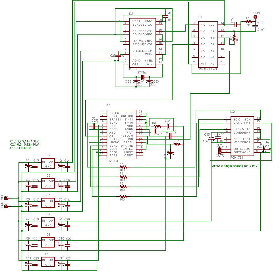

i would like to know if i'm correct for this dac and if somebody have a suggestion. Thank You! Maxpou
