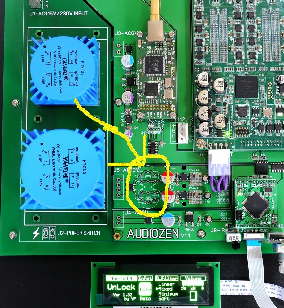

The Audiozen control board for my Soekris R2R dac has the option to add additional filter capacitors. Given the size allotted for capacitors I can add two 25v capacitors which range from 470uf to 11,000uf. So in other words up to 22,000uf.
At what point do I need to worry about capacitance being too much for a DAC? I'm concerned about pops, current spikes, etc.

I cannot think of any good reason to use 22mF to power a DAC. Calculate the value to give low enough ripple, then double it.
Well since this is DIY I have no problem with taking a sledgehammer to the problem. The cost difference in caps is equivalent to a McDonalds cheeseburger.
Not sure how to calculate necessary ripple. Would 22,000uf pose a problem in reliability, turn on surge, etc? If so what value max would you put?

Don't lump all your capacitance together in one can. Distribute it into two or more units and provide some series resistance between the two. Ripple, most especially HF ripple will be attenuated better and in my experience the reduction of HF ripple correlates with improvements subjectively. Though reading again you say that the board is a control board - so is it purely digital? If so then I very much doubt you'll get improvements subjectively from adding more uF.
In that case you are not in a position to determine what cap value to use.Pegasus123 said:Not sure how to calculate necessary ripple.
Possibly a surge problem. Possibly poor at filtering HF - so you get less ripple but more HF noise getting through.Would 22,000uf pose a problem in reliability, turn on surge, etc?
As I said, I would calculate what value I need for sufficiently low ripple then double it.If so what value max would you put?
Generally in engineering, over-engineering can be almost as bad as under-engineering but the damage done can be more subtle.
The resistance of (those small) transformer primaries is enough to ensure that you won't get a spike at start-up. The capacitors will progressively load up.
