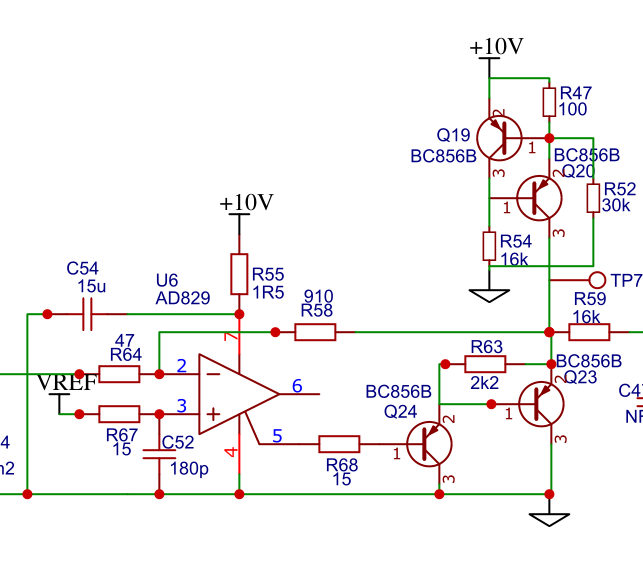

No options ? I am also searching for a discrete output stage, that does not rely on very old transistors, that are hard to buy. Best would be smd, if possible.
Here's the I/V stage I'm using - classA discrete output stage with cheap SMT transistors. Note the AD829 will need extra compensation to use it without the input resistor (R64) I have that resistor because I'm using an LC filter prior. Compensation is easy with 68pF from pin5 to GND.
