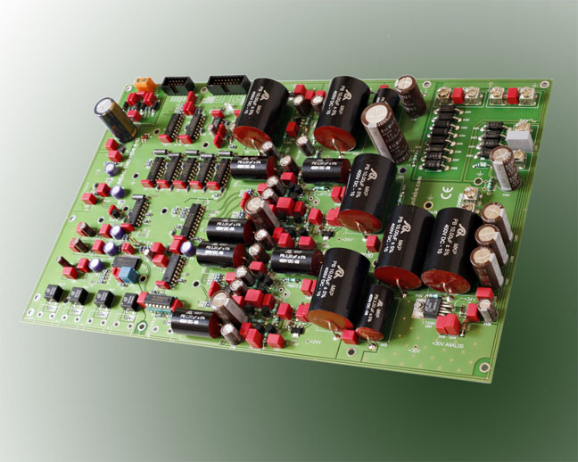

You could try the Audiosector dac. Peter Daniel who designed it is a forum member and he sells it in kit form or ready made in a number of configurations. It is a nos dac which will give you that close to vinyl sound, much better than an upsampling one imop.
Had mine ready made. It uses Blackgates/Rubycons and i have read Blackgates take quite a while to burn in (if you believe in it). Bass from this is impressive.
