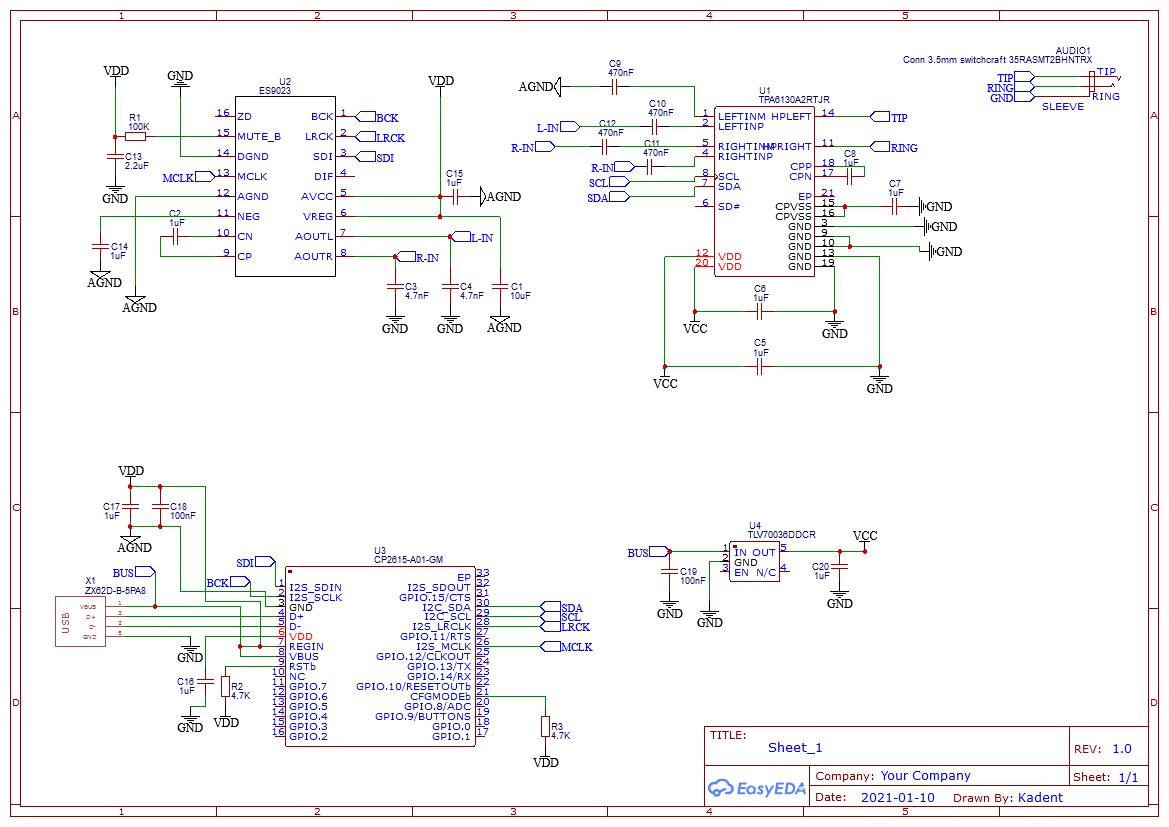

RIGHTINP and RIGHTINM of the TPA6130A2 are both connected to same output of DAC...
Good eye on that. The ES9023 outputs single ended, so the idea is to run the TPA6130A2 as a non-inverting single ended in, single ended out amplifier since there's no point of converting a single ended output (on the dac) to a differential to go to the amp, then get converted back again to single ended.
Thanks for the point out, I'll get that fixed 🙂

Re-check the DAC datasheet again.
Ground connection should not connect this way. Also the DAC output why there cap to ground?
Vreg short to AVcc?
Vreg short to AVcc?
Vreg short to AVcc?

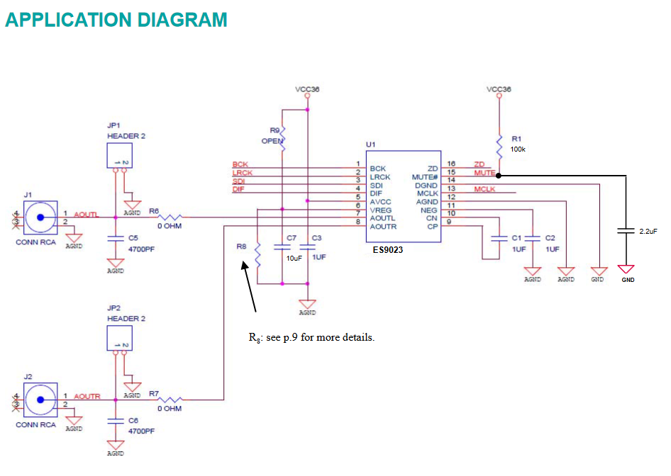

I uploaded both the datasheet example and my schematic. They seem to be pretty similar but maybe I made a mistake in the schematic.
This DAC is a voltage-output DAC, so it there will be a little bit of DC voltage. The caps are AC-coupling capacitors to block the DC voltage.

I was hoping you have the complete datasheet. Normally all ground are shorted in 1 location. Datasheet will tell you where to short for best performance.
1st time sees 4.7nF connect to output without any series resistor.
R9 is open, R8 need to read datasheet.

It mentions separating digital and analog ground for the charge-pump.

I only looked at the amp.
https://www.ti.com/lit/ds/symlink/tpa6130a2.pdf
just copy the layout and done.

Ok.
So for the Vreg, do follow the datasheet with 2 resistor.
Unmount the one that connects to supply.
You may still want to short both Agnd and Gnd somewhere on the board using resistor.
I recommend using 0 ohm resistor at you star ground. If don't need still can be remove.

I think you have the MUTE line on the DAC connected incorrectly. The data sheet has the 100 kΩ resistor to VCC.
If you haven't already, I suggest that you go through the documentation for the TPA6130 EVM. There're usually good tips in those. I'd also make sure that you can wiggle the I2C pins on the USB chip.
