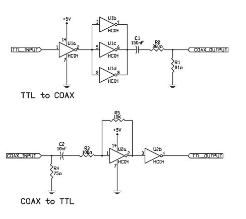

I assume the digital output from the back of the ROM would would need some sort of convertor to make it work with an external DAC.

If you must use spdif you only need to get the TTL level out of the cdrom to match the spdif specs. A buffer+resistor divider+transformer would be my preferred solution. Most DACs would probably work with a TTL signal anyway.
Forget about the usb converter. It's completely irrelevant.

Thanks Analog, that helps, any idea where I can get a circuit diagram for that.

What is your dac? You may wish to examine the existing DAC in the cdrom and consider using the input signals already present instead of spdif.
The TTL levels are not really a problem with most receivers. If anything the CS8412/14 are happier with TTL input. The lack of 75ohm output seems more detrimental. The attached circuit will do the job and will work better with an isolated output. Spencer is still selling extremely cheap Midcom transformers suitable for the job.

If the cd-rom is old enought (not one chip solution), then EIAJ lines can be found on decoder chip (CXDxxx), and contected to TDA1543A without receiver (CS8412/4). Better than SPDIF, pure and simple.
