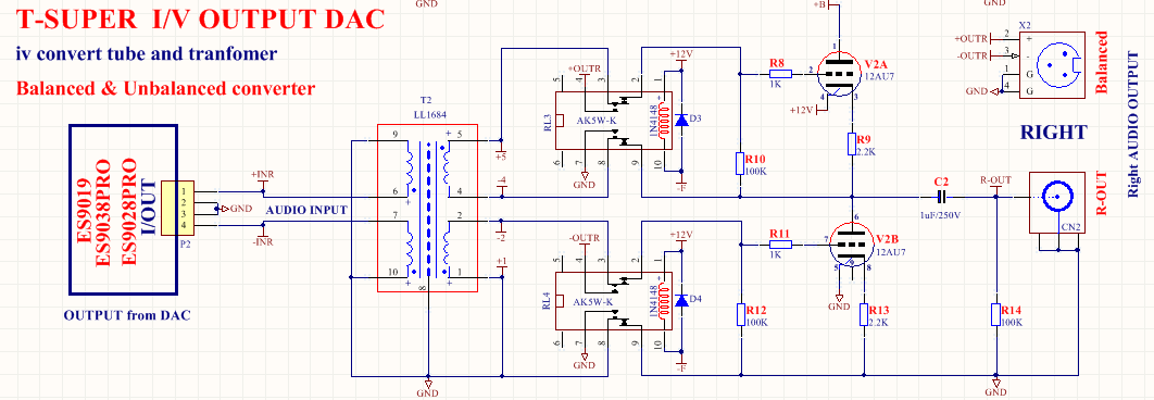

I like this project, just a question: if I choose options 1,2,4,5 (i dont need usb) what else do I need to complete it?...I saw pictures with an output tube stage in the older thread but it's not in the list here. Thanks!
this IV for layout now!
Balanced ouput with Tranfomer LL1684
Unbalanced converter with Tube
thanks
