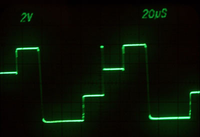

I have made a DAC that directly drives headphones. See http://www.diyaudio.com/forums/showthread.php?threadid=24992&highlight=
for details.
This project was completed over a year ago and has been in continuous use since. It's been very worthwhile as filterless direct drive makes a real improvement in the sound.
However, this design only really works with Sennheiser HD25 phones (70 ohm and very high sensitivity). I'm working on a 20 TDA1543 version with higher power supply voltages which should be compatible with a wider range of headphones - I'll report back when it is completed.
Enjoy!

I'm working on a DAC that will hopefully drive headphones directly. A 16-way paralleled DDDAC1543. I'll know in a few days what it'll do to a set of regular Sony MDR-V6s. After that I'll try some more difficult to drive headsets.
I'm driving these TDA1543s at 8.5V so there will be a lot more juice coming from them than in the other unit linked above. How much better it'll be I don't know until trying it.
Peter

If it is A., then pburke and intermod have already done the work for you with their multi-dac designs. Personally, I'd take a leaf out of Wadia's book and let the I/V stage do the hard work.
If it is B., then I have to ask if you have actually thought about what would be required. Perhaps you have scribbled a few numbers and done a calculation or two. Perhaps you have read the odd paper or two on current driven loudspeakers. In short, do you know what you are asking for?

Assuming you mean option B., then it is possible in much the same way it is possible to walk from Le Harve to Vladistok.
Frankly I am amazed that one would ask such a question. Consider what you wrote; 1W - 100W, Multibit ,No I/V. It is simply beyond me how you came to put the three together to ask the question in the first place. At this point I must stop 'cause I fear my head will explode if I try to put myself in a position where I am capable of understanding how one can ask such a question.
