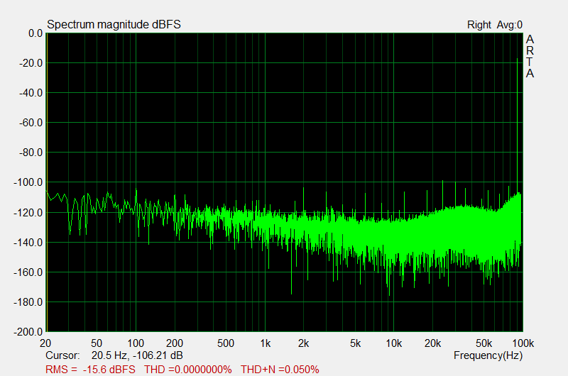

Initial tests had a sligtly distorted signal and analized with my E-MU1820m showed a really bad signal. I did replace the 5532 that was on board with LM4562 that I hade around and everything started to look better. I suspect that the 5532 was either a fake or a damaged exemplar. There is no capacitor or resitors on OpAmp outputs, so it is easy to be damaged.
At -2dB looks decent. The output stage overloads my ADC input at higher than -2dB (all the other DAC's that I tested didn't manage to do that).

All in all, sounds decent, especially for the price. THD+N with LM4562 is at -94dB. OpAmp upgrade is strongly recomended and looks like some of the AC grid noise could be reduced by better filtering.

I don't have measurements saved, but it was OK with the LM4562. For some reason, the original 5532 sucked bad. I still have it in a bin 🙂 I will do some measurements latter.

Your graph is weird, looks like noise... I will try again, with another source.

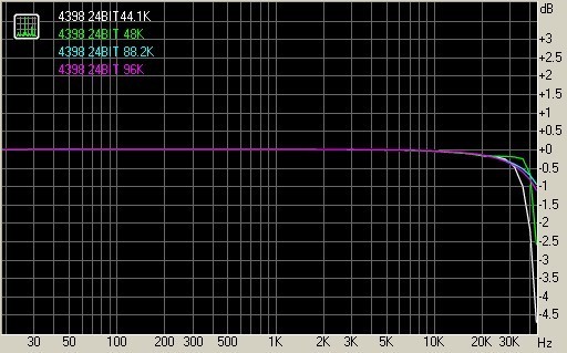

One thing that stood out to me was the original graphs shown by the seller had the frequency response going past 40KHz at -3dB with the sample rates at 44.1KHz and 48KHz.
I thought that was not possible according to Niquest-Shannon sampling theorem.
Certainly the LP filter could allow it and the plots for 96Khz and 192KHz would be accurate in that region.
But would the 44.1 and 48KHz plots?

I think those graphs are wrong. Plus they are useless to me, I am more interested in distortion level.
That's why I did my own measurements.

Near 100 years of sampling theorem says it is impossible.
You have to sample twice the highest frequency of interest to reconstruct it without massive distortion.
At 44.1KHz, the highest frequency that can be passed undistorted is 22.05KHz (minimal distortion actually because one can not guarantee synchronization between the frequency of interest and the sample clock). In reality 22.05KHz will be distorted as well so normal procedure is to filter below this.

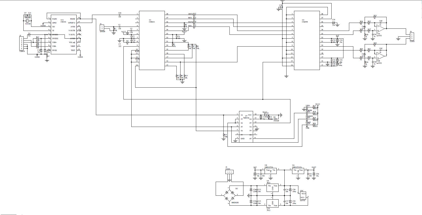

And the SCHEMATIC which is a little old and it's missing D+3,3 PSU section, but the rest is ok...

Schematic w/ 3.3V supply
Since there is no copyright on the schematic I'll upload it.
Oops, schematic too big. I'll downsize it and upload it.

The analog stage in the schematic is not really as recomended by CL. It "works", but I have a feeling that it could do better.
It should be pretty easy to change it to the one in the data sheet. most of the component placements are the same, so it is mostly value changes. IIRC two caps and one resistor are different topologically.
I did a sim of both and they are quite different. On the other hand, I understand the values on the schematic may not be what is on the board. The same filter is shown on some other schematics (4793/6?) from what I understand, and they did not match the boards values.

The AMS1117 datasheet recomends as minimum output capacitor a 22uF tantalum.
I guess bypassing the electrolytic with 100nF is a good alternative, but I will increase the capacitor to more than 10uF. Datasheet says that bigger capacitors are not a problem due to internal reverse diodes, so I am looking to something in the 47-220uF range.
The 7812 and 7912 that take care of the OpAmp power could see some improvement too...

I'd skip the Tantalum and go with some good low ESR Al caps bypassed with film caps at 1/100 the value of the Al cap. I think I would have been better off with a kit in that regard so I wouldn't have to remove the caps and re-solder new ones. But I got the built one at the cost of the kit....
I'm not quite sure what to do with the 78/7912s. LM317s are better, but if you are going to change the topology it might be worth it to go shunt reg.
A small pc board with a shunt regulator that pin-d the same as the 7812/7912 would be neat.
