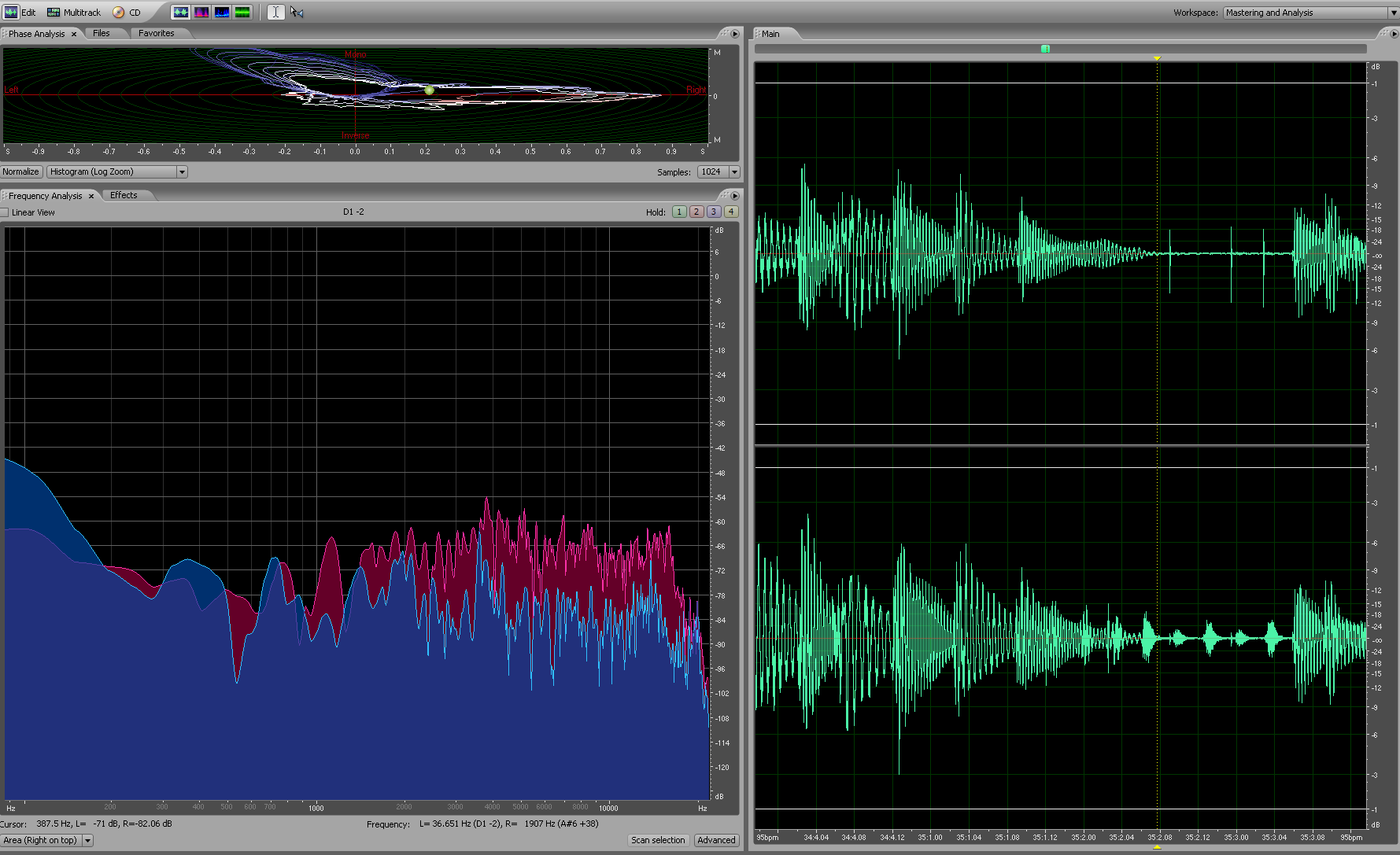

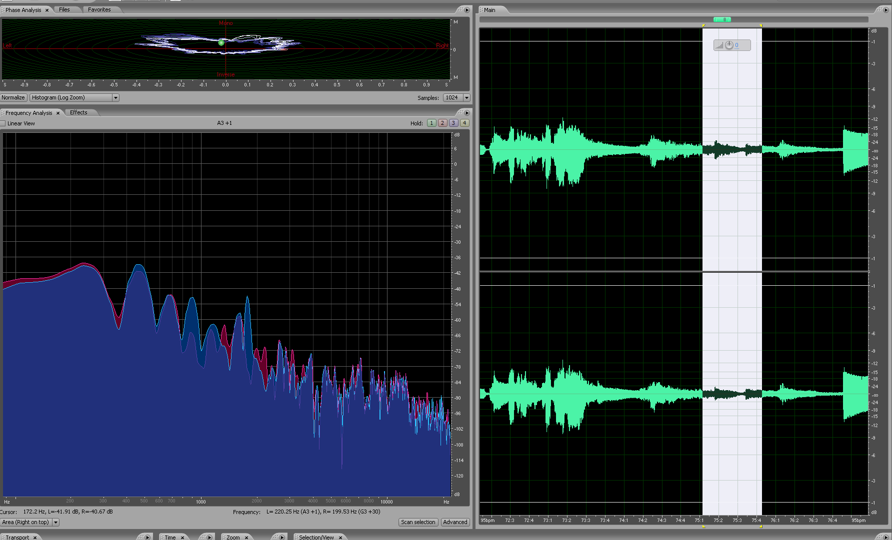

Two screenshots, one is from CD and another is from DSD file. Second has information below -110dB.
CD-recordings do not contain information below -96dB. Think about that for a minute and work out why this is so.
Even better, think about it for two minutes and realize the error in your logic.
Information - or HF noise?
What is the actual SNR of that DSD file?
