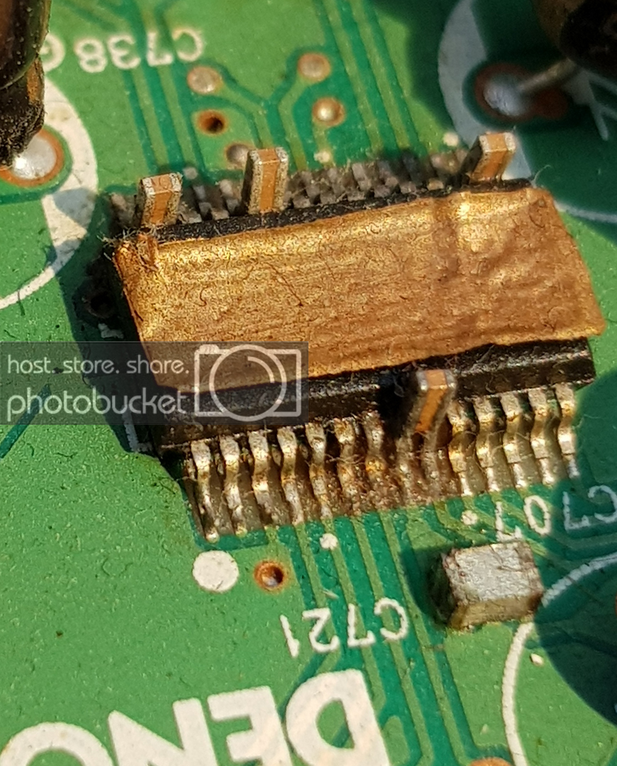

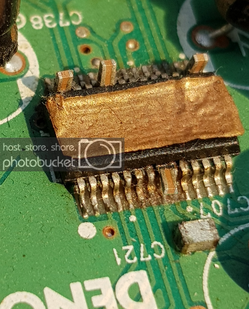

DAC chip decoupling
I tried reversed geometry 0306 capacitors, standing up on the short side, directly on the DAC chip legs of 1706 DAC
Ended up with Murata 4,7uF cap with actual PCB trace length of zero.
Only the internal bonding wire and leadframe left.
Since the inductance is getting reduced to approx 1/3 and capacitance 47 times bigger than 100nF original cap i assume the ripple was reduced.
My Denon CD player sounded much better.
I have a Pro-Ject pre-box s2 where i have not yet tried this.
It is not easy, you need really good soldering skills, a steady hand, microscope etc.
Will i risk anything modifying the Pro-Ject?

Thanks John for quick answer!
So IF i want to use a 0306 reverse geometry cap, directly on AVCC where the leadframe legs is entering the encapsulation of the DAC chip, should i go for a 4,7uF or 100nF?
I will try to take a picture from my Macro lens later tonight, so that everyone knows what i´m doing, English is not my native language so sometimes i feel limited in my way to express myself.
And if anyone want to experiment with this further i highly recommend to buy ten caps extra and practice on some scrapped circuit. The reason for saying that is that ended up Buying 3 DVD players of Denon 3930, to get one of them working. I destroyed the PCB, with extensive rebuilding, and trial and error.
Solder paste and hot air gun could be a faster and easier way to go but I have not tried that.
The board is one of my trial and error boards found in the garage.. oil and dust.
But you get my point. The inductance is extremely low... and tha cap is 47 times bigger (4,7uF) than the 100nF you find a mile away from the DAC.. The cap is a 0306 package "rewersed geometry" developed for extra low inductance, and high frequencies.[/IMG]
Inductance is not lowest the way you are using the caps. You have current flowing up one side, sort of branching out across, then back down the other side. That makes the effective current path higher inductance, folded around in a loop. For the low inductance specified, all current needs to be flowing principally in the direction of the shortest cap dimension. Not saying its a problem, however.
But you get my point. The inductance is extremely low... and tha cap is 47 times bigger (4,7uF) than the 100nF you find a mile away from the DAC.. The cap is a 0306 package "rewersed geometry" developed for extra low inductance, and high frequencies.http://s806.photobucket.com/user/kallekarr/media/Decoupling1.png.html
As Mark is getting at, the mounted inductance is swamped by the trace length / layout. I doubt it even makes a difference to use reverse geometry caps like this, but it does fit better I guess. Still, holy hell, clean that PCB with some alcohol and a toothbrush. It looks like a cat slept on your flux residue. 😀
My current board (the third one) the cap is laying more on the leads. Cant hear that the sound is more relaxed but maybe...
If you find a better way to get 4,7uF CLOSER please share it below, i will certainly take all new ideas into consideration

As Chris719 writes, the upper frequency is only limited by the form factor, which is the geometry. The current length is the inductance! So if you can squeeze in 100uF in the same capsule size as 100nF they will have same inductance and the same upper frequency limit. That´s why I want the biggest possible cap with lowest inductance (smallest encapsulation, or most narrow with) as close to the DAC as possible.
