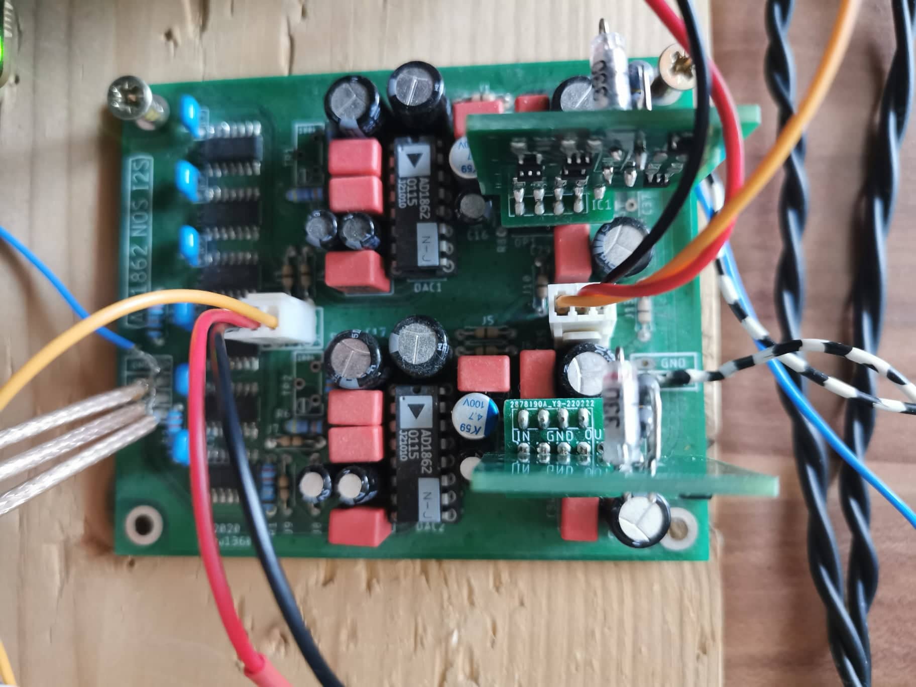

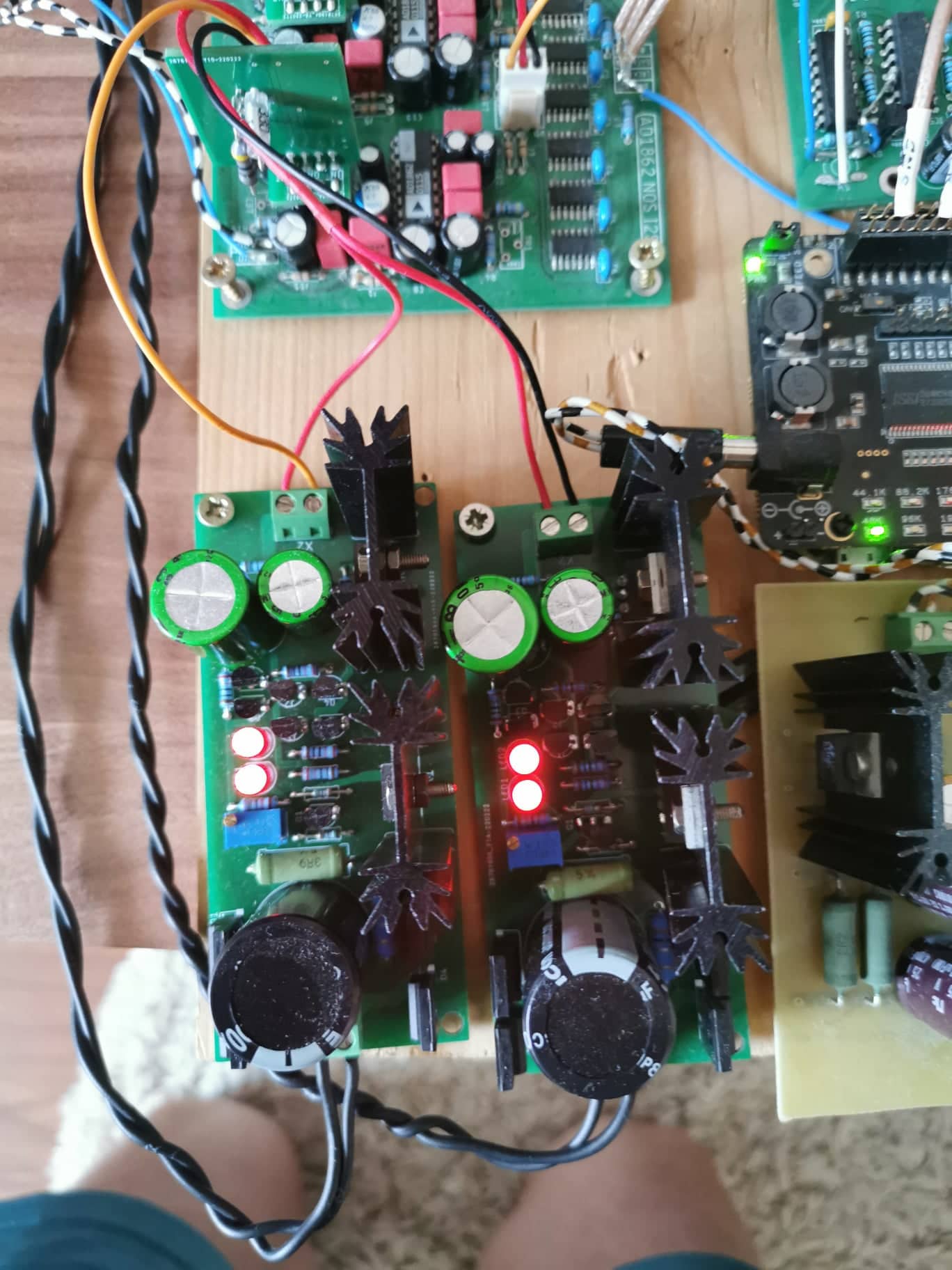

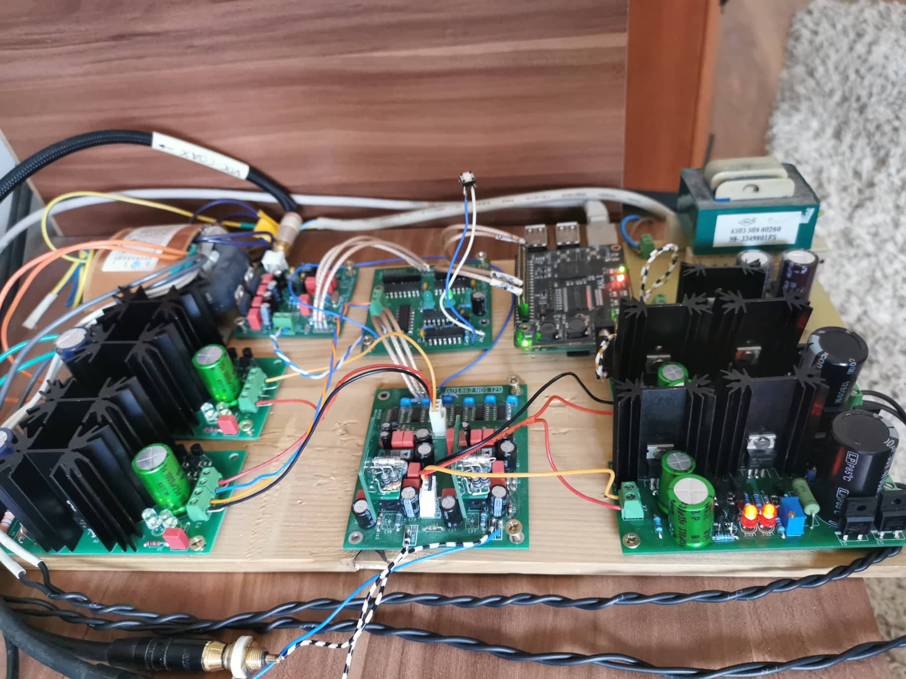

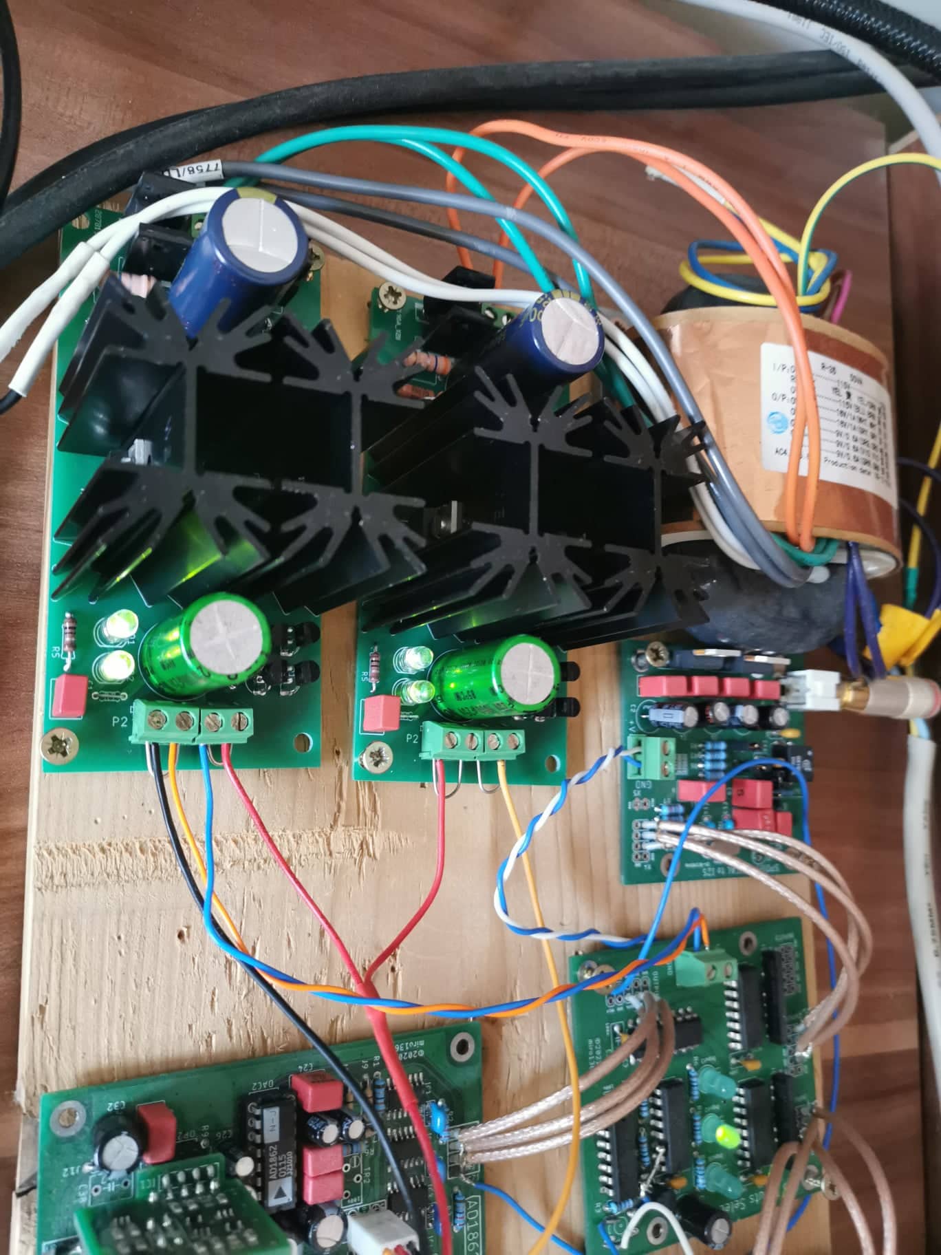

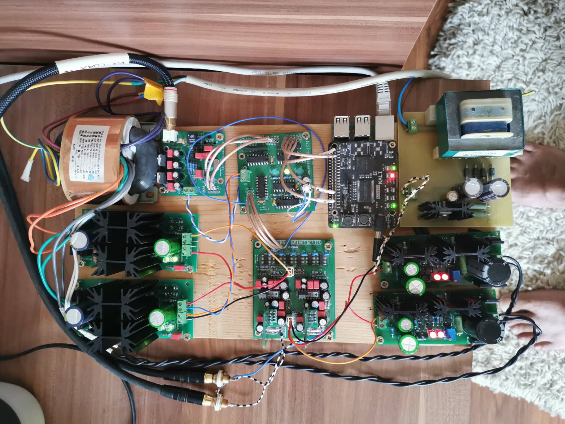

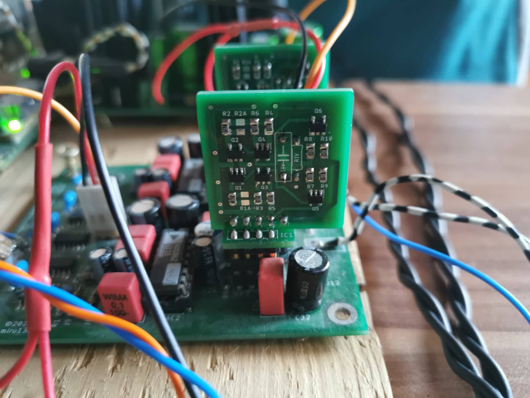

DAC AD1862: Almost THT, I2S input, NOS, R-2R
AD1862, Salas UBIB 1.3, Salas Reflektor-D, EUVL CM IV.Source RapberryPi (Moode Audio) and Allo Kali reclocker or CD player.
The Salas shunt resulted in more precise and tighter lows. The imaging is almost the best for me so far. I also tried the SEN IV, it's very good, but due to the complexity of the power supply, I stayed with the CM IV.
I just need to box it up, I'm completely satisfied with it at the moment.
Thank you Miro, EUVL and Salas. 🙂

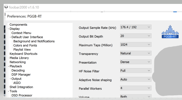

2. Use this super filter to feed your DAC (it wont work for everyone but it can be as significant as changing an output stage):

1. Download a digital hires ADC of the original vinyl of a problematic song. Does that solve the issue? If yes it may be the ADC back in the day had filtering/ADC issues. If it still sounds bad in the same way then:
I usually play digital rips in wav or flac format through allo digione signature powered by allo shanti into ad1862 (lm6171 as i/v). Amp is Sansui au alpha 607xr and speakers are xavian giulietta.
Regarding the old songs, the music is sharp & edgy and after a few songs either I have to turn down the volume a fair bit or change the music. It seems either the songs were poorly recorded or mastered as even the new CDs of those songs sound like that.
No, I don't plan to dump the 1862. Nah never. I just want another dac which mellows down the sharpness and smoothens the edgy signature.
maybe the lm6171 is the culprit especially if mounted on an adapter or dip socket
from lm6171 ds;
Components Selection And Feedback Resistor
It is important in high speed applications to keep all component leads short because wires are inductive at high
frequency. For discrete components, choose carbon composition-type resistors and mica-type capacitors.
Surface mount components are preferred over discrete components for minimum inductive effect.
Large values of feedback resistors can couple with parasitic capacitance and cause undesirable effects such as
ringing or oscillation in high speed amplifiers. For LM6171, a feedback resistor of 510Ω gives optimal
performance

Can't say with certainty that the opamps are the culprit as it is the old songs only that are unlistenable For well recorded songs especially the new releases, I have never heard them sound so euphonic.

For any recordings to be literally unlistenable strongly hints at an electrical issue, or some horribly bright and rough sounding speakers/headphones. Unusually euphonic, forward sound has been classic symptom of oscillating op amps, I guess it comes from high THD up to high orders, but if the op amp's operation is broken who knows what disaster is happening in real music beyond the THD.
