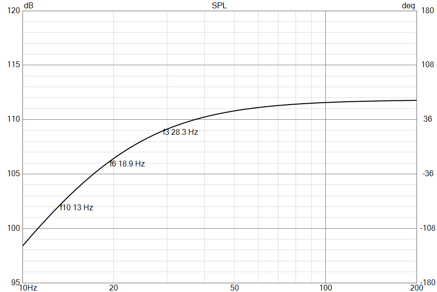

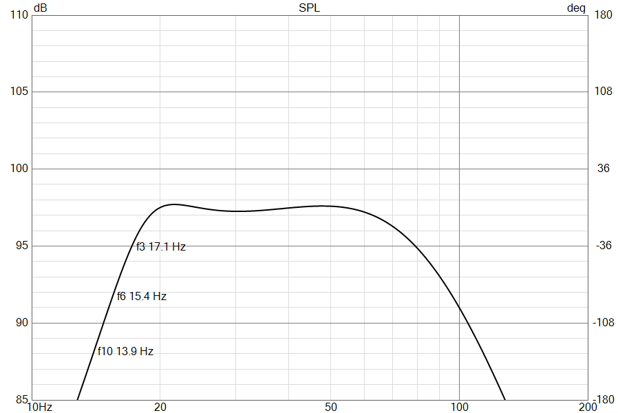

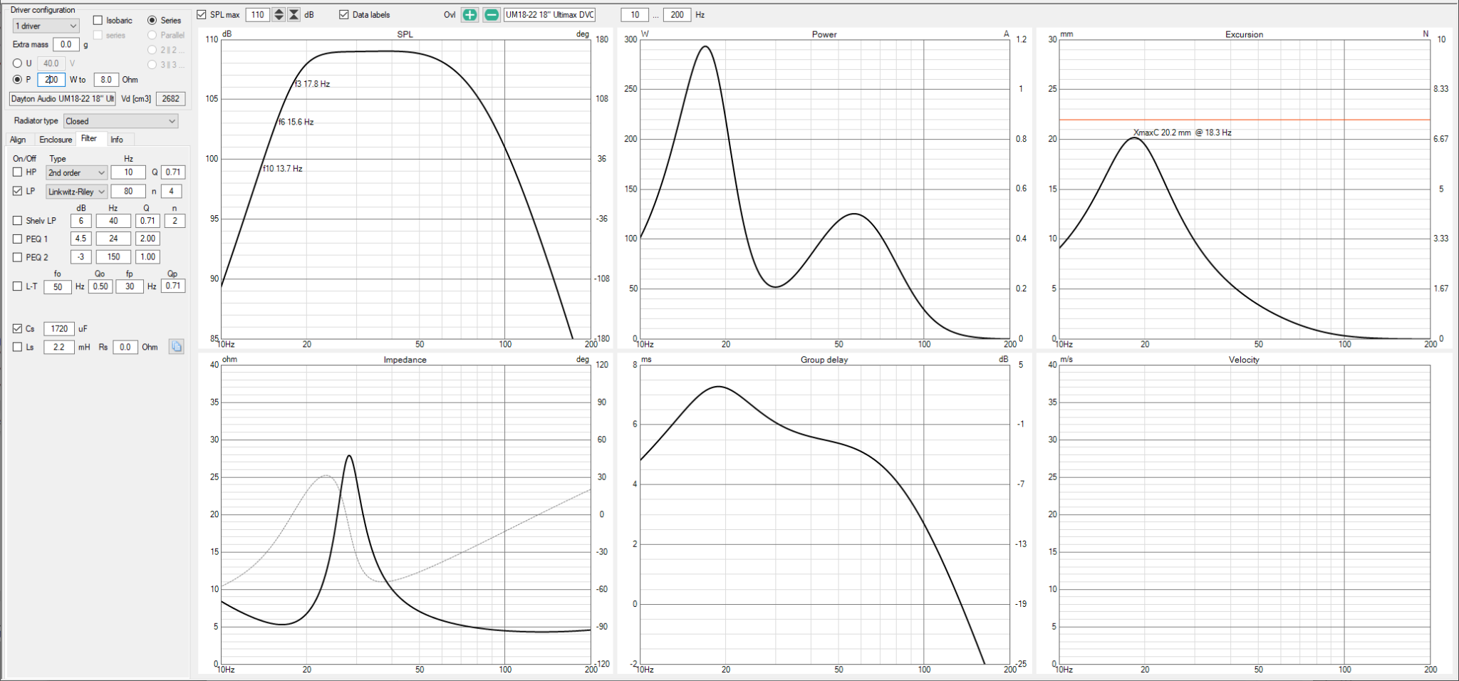

The UM18-22 18" Ultimax DVC 2 Ohms/Coil driver has a Qts=0.53 with a low Fs=19.5Hz. This is a driver that could be used quite well on its own in open-baffle loudspeaker systems. Its simulated response for 200W re 8Ω of power input under those conditions is shown below.

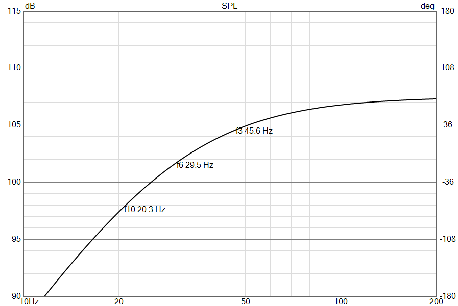

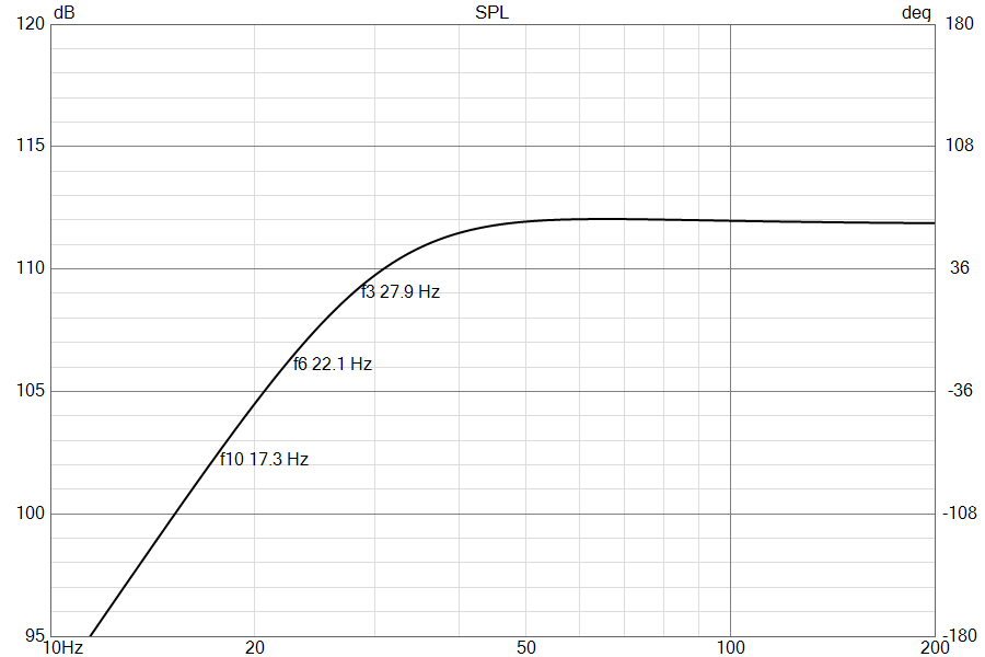

If we place this same driver in a 150-litre sealed box enclosure, then we get the following simulated response at 200W re 8Ω:
Note that we now have a faster rate of roll-off, and the f6 = 22.1 Hz instead of f6 = 18.9 Hz. If we add a 2000µF series capacitor to the circuit, as well as applying a 4th-order Linkwitz–Riley low-pass filter set to 80Hz, we get the following response. The −3dB low-frequency point is now a very respectable 19.7Hz, which seems to be quite a good result for a 150-litre enclosure. The results are for a nominal 300W re 8Ω of power input, with a peak power draw of around 460W at 18Hz or so, and the driver excursion being at the Xmax limit of 22mm. A good plate amplifier can cope with that.

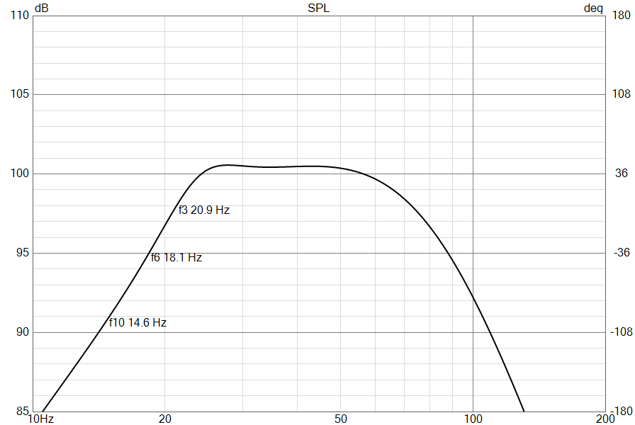

If you would prefer not to include a series capacitor, then we can go the alternative route and use a peaking high-pass filter set 20Hz and Q=2.0. This can produce the following response. This isn't quite as extended as the previous solution, and it has a faster roll-off below the low-frequency −3dB point. The amplifier needs to have at least a 400W re 8Ω capability, as it's doing all the hard work.
Wow, thank you, but I'm sorry to inform you, you probably just threw some pearls at pigs. Pigs being me. I dont know what a Linkwitz Riley is. Boy oh boy, I'm assuming that the 2000µF series capacitor is something I'd add to the amp? But I might be extremely wrong there....
I could make the enclosure a bit bigger, in fact I've been told that making it less cube shaped could be a good thing, so I was thinking about making it taller. Would it help? I'm really trying to avoid doing some soldering... I've heard that the CSS sdx12 is better for range and being in a relatively small box. But I don't think Ill be able to get one of those on the used market and they're pretty expensive. Whereas, the Ultimax drivers are plentiful in the used market in the US.
If you want to explain me what these things are I'll pay good attention. If you can't be arsed I understand that too.

Oh my, we are really jumping around here! We've gone from an 18-inch driver to a 12-inch driver in one fell swoop. The SDX12 XBL2 is quite well suited to a smaller enclosure. In a 75-litre sealed enclosure, that 12-inch driver produces a −3dB point of a somewhat high 45.6Hz (see below). That's not really subwoofer territory, and it requires some EQ to get it working in that domain.I've heard that the CSS SDX12 is better for range and being in a relatively small box.

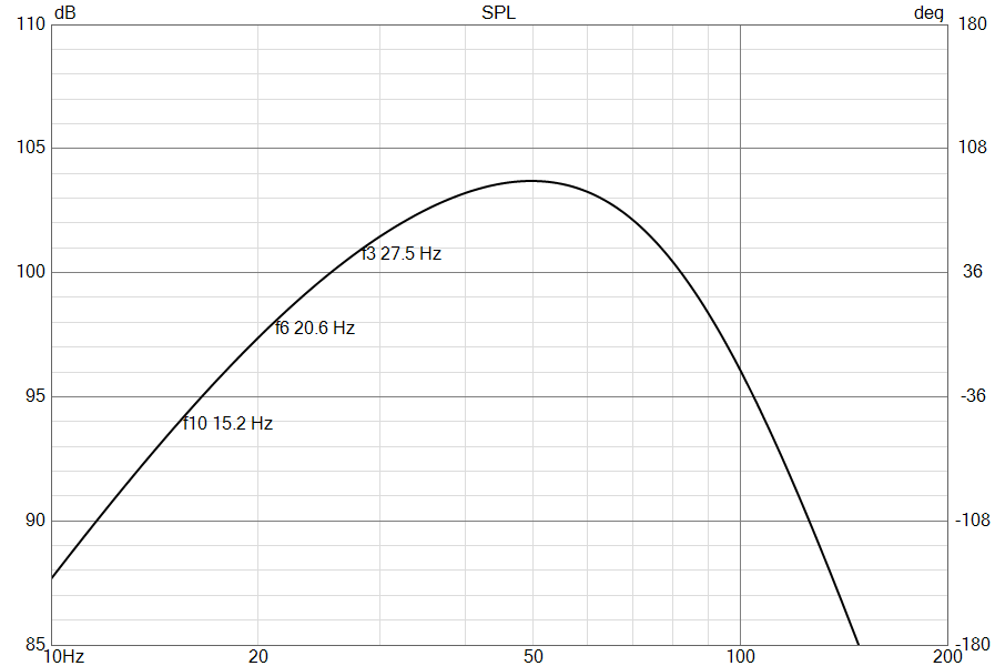

What happens if we add a 4th-order 80Hz Linkwitz–Riley low-pass filter? This is typical of the low-pass filter that will likely be introduced by your AV receiver's bass management system.
With that low-pass filter added we obtain the following response. Note how we have "magically" lowered the −3dB low-frequency cut-off point from 45.6Hz to 27.5Hz. However, note that at 80Hz the result is only about −3dB, rather than the desired −6dB (the response is −6dB at about 93Hz.). This is due to the naturally falling acoustic response of the woofer in that region.

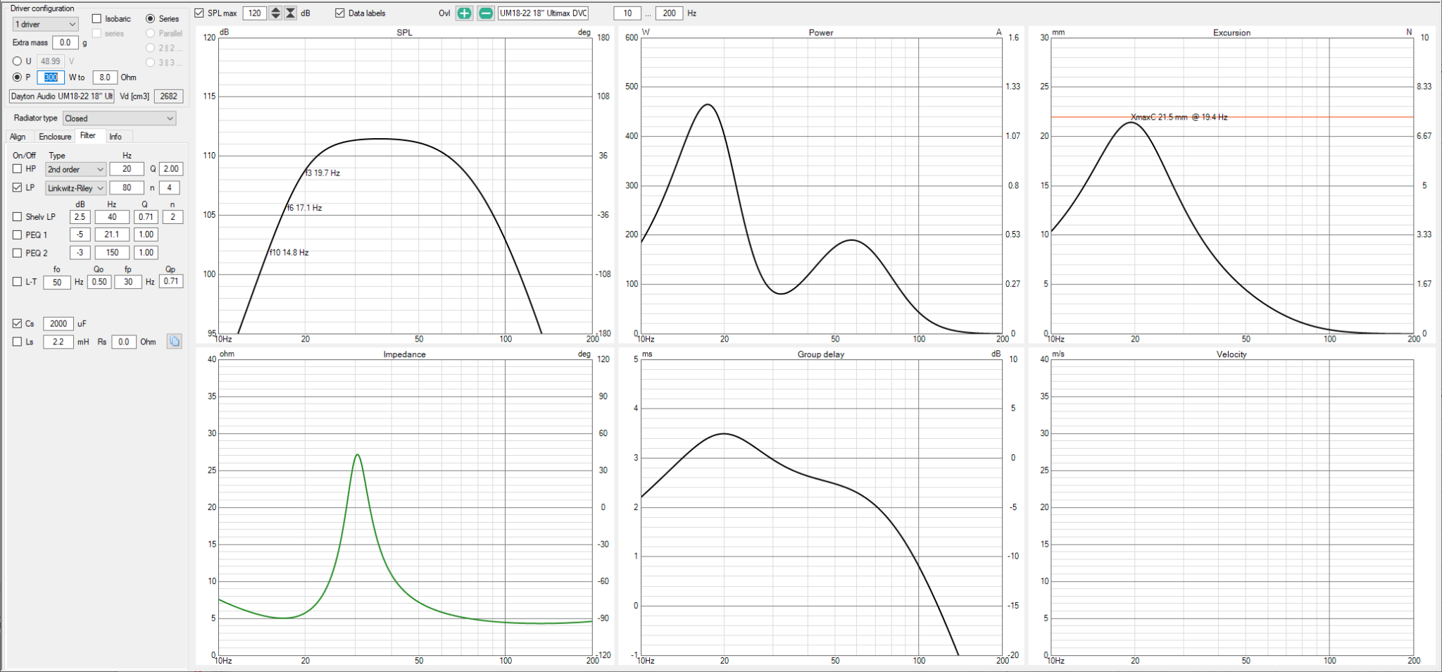

What happens if we add +4.5dB of parametric EQ at 24Hz with Q=2.0 to the above response? The results are shown below. This was obtained for a nominal power input of 40W re 8Ω, and we reach the driver's Xmax limit at around 22Hz at that input power level.
If we don't have any PEQ facilities available, we can add a 1300µF series capacitor to produce the following response. We now have a −3dB low-frequency cut-off point of 17.1Hz, and the driver's Xmax will be exceeded just a little at 18Hz at this power level. The downside of this design is that the maximum response level is down by about 3dB, but that's just typical of the trade-off between the maximum output level and the low-frequency cut-off that can be achieved by a driver of a given size.
Let's investigate the possibility of a somewhat larger enclosure for use with the UM18-22 18" Ultimax DVC 2 Ohms/Coil driver. For example, we can choose a sealed enclosure that has an effective volume of 200 litres. If we add a series inductor of 1720µF, and include the 80Hz 4th-order Linkwitz–Riley low-pass filter coming from the bass management system on the AV receiver, we can get the following response for an input power of 200W re 8Ω.I could make the enclosure a bit bigger,...
In the above, the −3dB point is 17.8Hz, which is nice and low, and we have a 3rd-order roll-off rate, which is still quite good for ensuring a good transient response. At this power level, the driver is being driven close to its Xmax, and we have a maximum output level of 109dB! You can't get that with a typical 12-inch driver with a more conservative Xmax, that's for sure.
It's worth noting that the series capacitor is acting as a high-pass filter below about 13Hz, which helps protect the driver from large power inputs/excursion at infrasonic frequencies below the system cut-off frequency. Being a closed-box system, this design also has no port chuffing at high SPLs.
The software is called VituixCAD, and I am using its Enclosure tool for the above simulations. The software can be found here: https://kimmosaunisto.net/

DSP certainly isn't crucial, going by the potential designs that were previously explored, but it does offer a lot of flexibility. Of course, there would be a learning curve to navigate on the road to implementing DSP-based designs.How crucial would you say a DSP is for my use case?
The external amplifier option is quite workable, as long as you have one that can put out reasonable power into a 4Ω load. Of course, how much power you need depends a lot on your desired listening levels.I mean, I'd give up on the external amp thing if it's really favorable.
I was a bit surprised by the 17.8Hz cut-off when a suitable series capacitor value is chosen. The driver is capable of very high SPLs if powered up to reach its Xmax, that's for sure. It seems quite capable of dealing with the LFE channel and its 10dB boost when watching movies.I can certainly make the box 200L by making it taller and maybe a little bit deeper (I'm assuming a sealed sub has no issues with being fairly close to the wall, right?). 17.8Hz F3 looks fantastic to me. Better than I anticipated tbh! Will it look weird?
