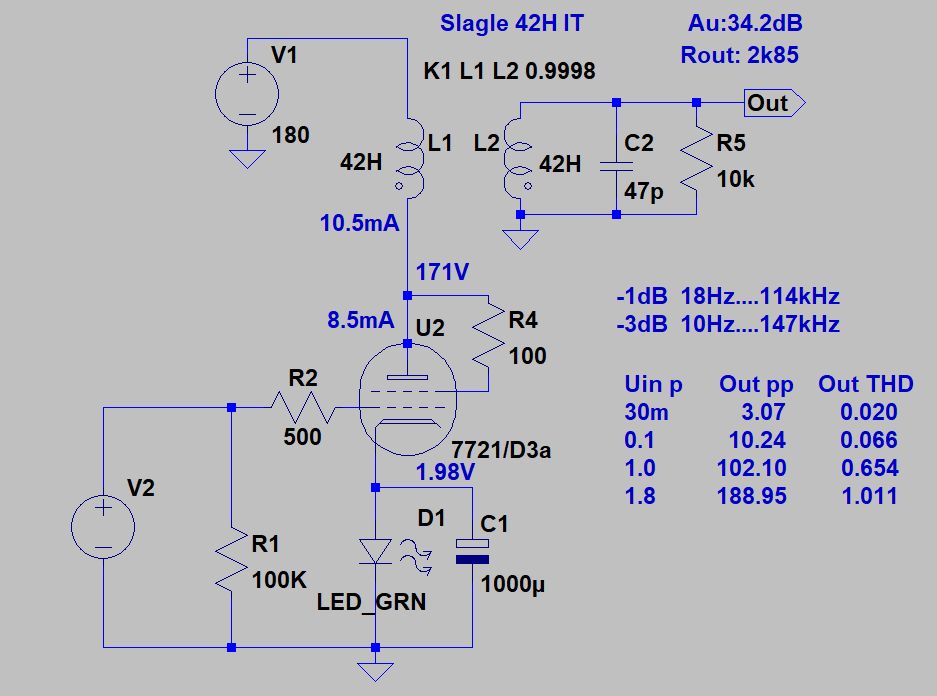

Are you sure?
Trioded D3a has tremendous gain.
I regularity use it as VAS device in amplifier/s/.

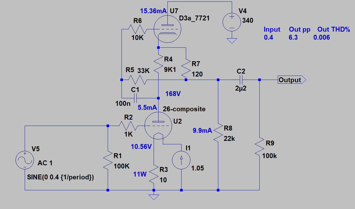

mu of 70 in triode mode, doing a line amp will be hard work, you will need to reduce gain from about 35 to about 5 using plate to grid feedback, in an inverting configuration and that may not sit well with some audiophiles...
hint: look at the Camp Amp topology...
It just had the thought that i could use a stepdown transformer after the tubes what do you (opinions from others are also appreciated🙂 think of that idea?
I use D3a with 2:1 stepdown. I note that euro21 sims with ~Lpri that I have; same winder.

The only sensible way to build a line stage using D3A is with a step down transformer. I have done something similar using c3g and is not bad at all. Balanced with permalloy UTC LS-51.
Yeah, but the difference is that a D3a has a gain of 70 in triode mode compared to 40 of a C3g wired as triode...but I think that with a different stepdown trans that reduces the output even further I would be fine

With sources with such a high drive level, D3a can not be driven directly!
With 2 Vrms = 5.6Vpp you will need a triode biasing with at least -4V which is impossible for a D3a. The max you can use will be something around -2 to - 2.5V, better would be -1.7V with a max drive level of 1Vpp.
See the triode curves in D3a datasheet.
A solution would be to have a 4:1 step down input transformer or a resistive voltage divider to reduce drive level. As an output transformer you will need at least a 6:1 step down (2V -> 0.5V -> 20V ->3.3V).

You are making some excellent points. The only way this topology would make any sense is if you insist on using a 600R attenuator after the input transformer. Which may have some merit.
The entire idea of using a high mu valve in a line stage is just wrong. I think AN do this in some models but i cannot see the point, unless Qvortrup got a super cheap deal on suitable transformers.

Is there a compelling reason not to try a bit of plate to grid feedback? Very easy to undo if you don't like it and almost no expense to try.
Not really..
I surely will give it a try if I have enough parts lying arround but I won't buy much for this test other than a couple of resistors and caps. I think that I should have enough to test this idea though...but even than I'd not need 18 D3a's so if anyone is interested in trading 10pcs of them for other tubes I could use more of, that I mentioned in my last post, feel free to send me a dm (even if you have other tubes than I listed because maybe I can put them to good use someway).
