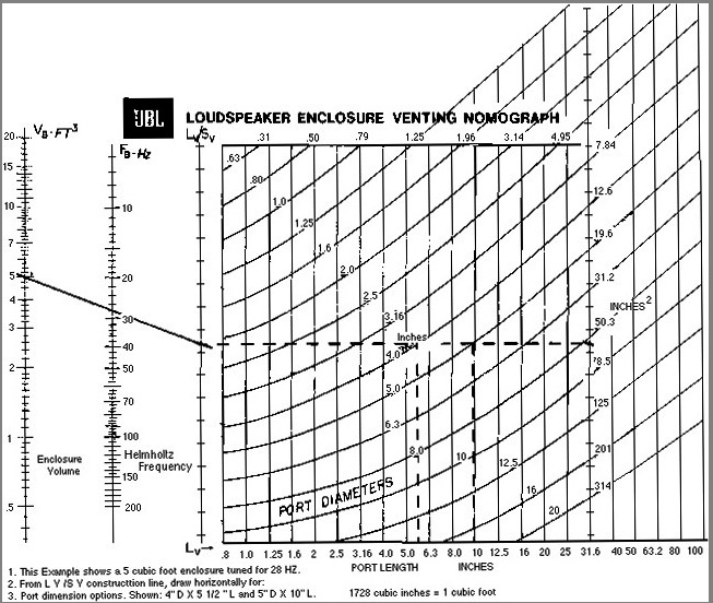

Ok, so after a few more hours of thinking and talking with le wife about what she's ok having in the living room, I've decided that I want to make an enclosure similar to the JBL C36 cabinet. If I can, I'd like to keep each side of the enclosure below 24", with one port. 15" driver will be mounted at close as is reasonable to the top, and then my econowave guide will be given its own baffle and attached to the top of the woofer cab.
So if anyone would like to jump into this project with me, I need help figuring out specific measurements and what size/shape my port should be. I have a few enclosure emulation programs but I'm still learning how to use them so I don't trust any of my findings. Within the parameters of less than 24" per side with 1 port, how can I tune a cab for D130 15" drivers?

1) No, but flat response to 45 Hz won't be happening with a box less than 4 cubic feet with a D130.1)Is reaching down to 45Hz really dreaming?
2)Within the parameters of less than 24" per side with 1 port, how can I tune a cab for D130 15" drivers?
2) You can tune it however you like, the lower the tuning, the steeper the LF rolloff will be. There are a number of online port calculators available, or you can use the old JBL nomograph below.
