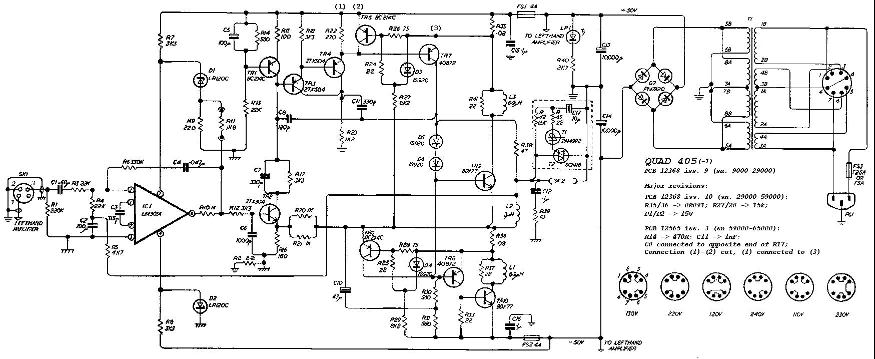

I have been surprised that the driver in a Quad 405 I had for a while a home became very hot.
If you mean the buffer on the opamp, that is in class A and gets hot by design. My point is that the Quad design does not depend on sensor transistor thermal tracking or the use of exotic power devices with built in diode sensors to avoid run away
It remains the most original circuit of all the solid-state era.
As far as I remember, it is Tr7 which becomes very hot, it is in class A and provides all the current to linearize the output stage where BDY77s Tr9 and Tr10 work in class C..
It has about 50mA through it so 1W. For some reason the 306,606 etc changed to a discrete voltage amplifier and TR1 to a LM334 2mA current source. My simulations show an issue there as the LM334 mis-behaves at >2V/us slew rate. This is easily exceeded when the dumper devices activate
