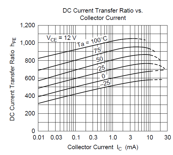

I don't have data for BC550B, but here is data for 2SC1775. Your simulation model does not have change of hfe vs temperature.

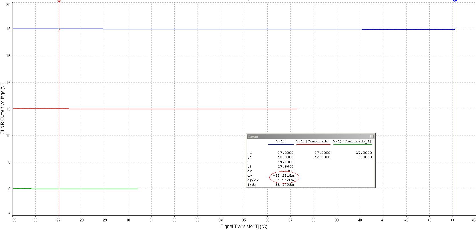

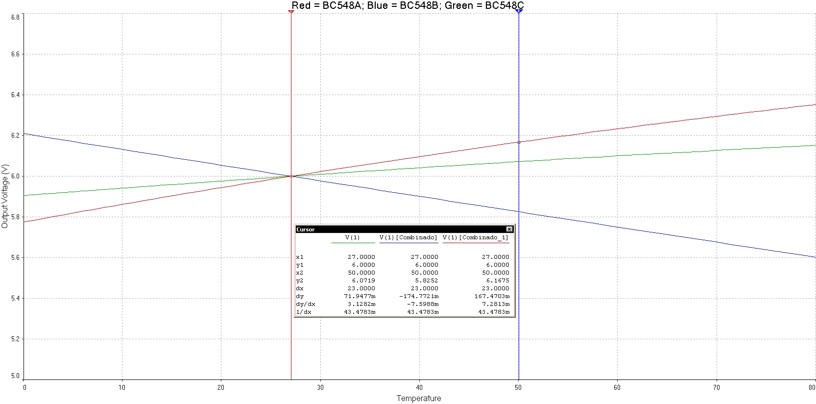

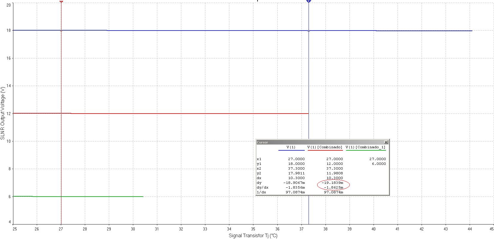

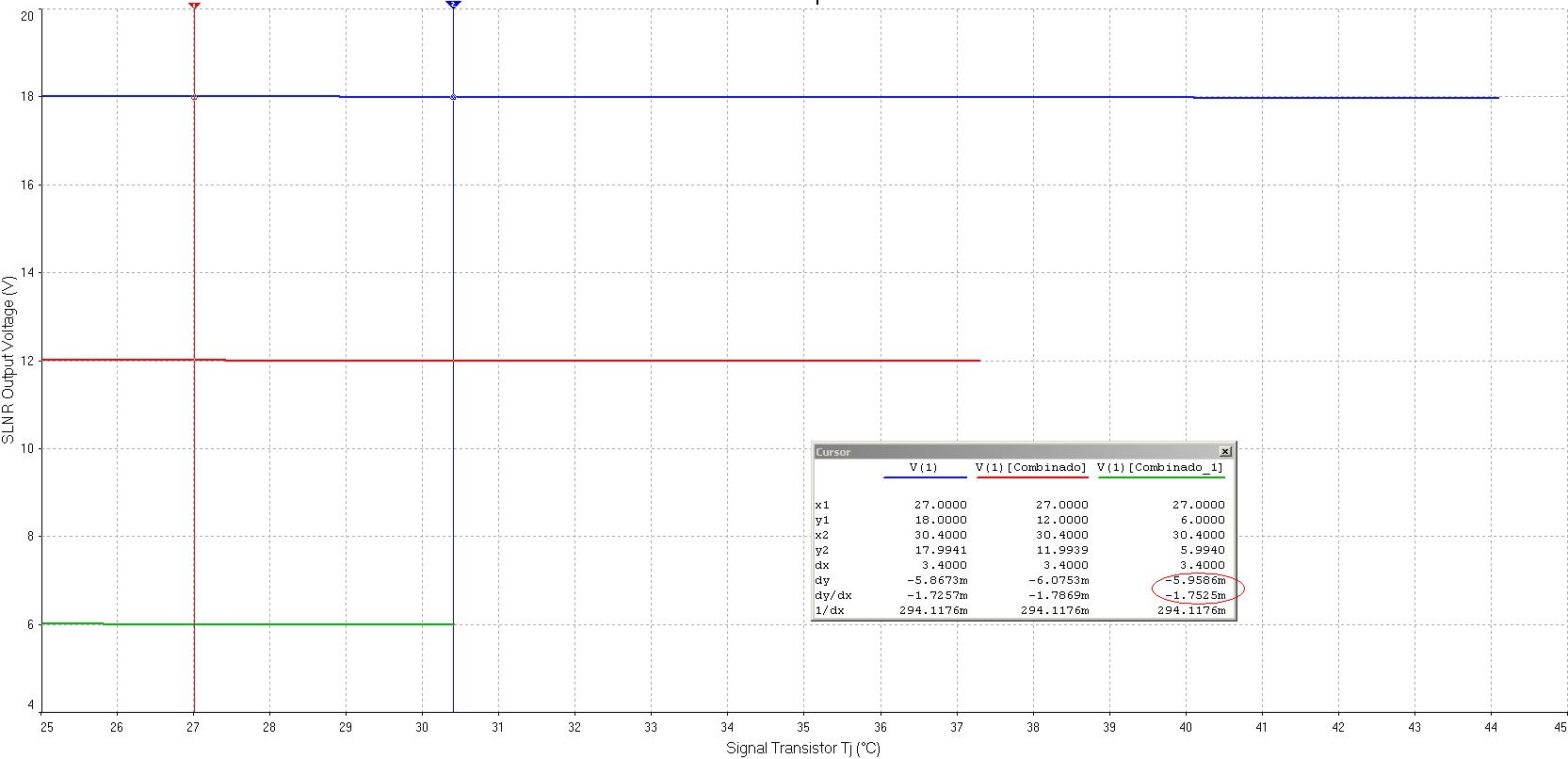

This new version is more a cap-multiplier on steroid than a regular voltage regulator.
The output voltage will change heavily, depending on the exact transistor used (not only the type # or even the selection), and it will further change with temperature.
If an accurate voltage is required, a trimmer is unavoidable
The weak point is the variation of Vout with temperature, which is not far from - 2 mV / ° C for the vast majority of transistors that I have simulated.
It is attractive for its almost extreme simplicity and the fact that it does not present overshoots in its output, something that both denoisers and dienoisers suffer.
Another point that adds up is that it is possibly stable for both types of regulators, although it would have to be tested.
There are no perfect solutions throughout the entire range of parameters.
All variants suffer from something.
Best regards

Stay calm. I understand very well the problem that this circuit has. They will be factors that will have to be observed, chosen and adjusted.
Best regards

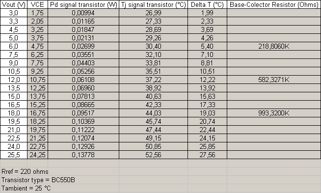

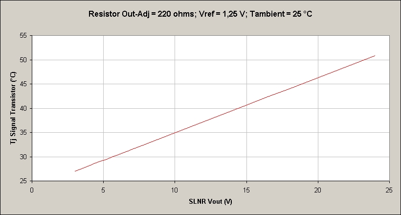

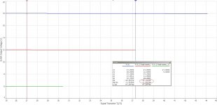

For a 15V application, the signal transistor will dissipate around 78mW, with Vref ratings for the LM317 of 1.25V and with a 220 ohm resistor between the output and adj pins.
Thus, the Signal Transistor Tj would reach about 40.6 ° C, with a Tambient of 25 ° C. That is, 15.6 ° C above the Tambient.
attachment.php
Best regards

No. That last graph defines what temperature the junction reaches according to the programmed output voltage, considering that the collector current of the signal transistor is approx. about 5.68 mA (1.25 V / 220 ohms), neglecting the Iadj.
That is, for an application where Vout is 15 V, the power dissipated in the transistor would be about 78 mW. (13.75 V x 5.68 mA). With that power dissipated and an Rthj-a of 200 ° C / W (typical of a BC550), the Tj would reach 0.078 W x 200 ° C / W + 25 ° C = 40.6 ° C.
So they are only 15.6 ° C above the Tambient of 25 ° C. Assuming that a coefficient of - 2 mV / ° C can be adjusted and strategically chosen (according to transistor), they would imply 31.2 mV of variation from when the power supply is connected until its temperature stabilizes.
And so I define the graph for each output application voltage.
Best regards
