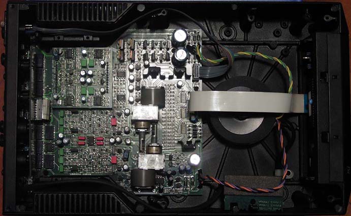

Hi Chris,
Thanks for your help.
Attached please find the picture of the circuit board. I try to adjust the volume using the remote and seems that both volume did move. However the one near the centre do not move smoothly like the other one which near the edge. I guess this volume switch is in question.
There are some alphanumeric characters printed on the switch. Both switch got "531t 20KDB".

Hi Clement,
Turn the unit off and unplug it. Try to turn each control by hand. Does the one that turns intermittently feel rough?
It's possible that it's a mechanical problem or a lubrication issue.

Hi Chris,
Since both volumes are sitting very close, it is difficult to turn by my fingers. I use a pair of tweezers to turn them. Seem both can be turn by same amount of force.
If it is a mechanical problem or a lubrication issue, can I fix the volume switch or I need to get a replacement part?

Hi Clement,
What I would do at this point is remove both controls and test them outside. This means checking for mechanical issues by hand and running the motors with a variable DC power supply. You may find something simple that can be corrected, or this may lead you to look at the driver circuit for the motor. It's possible the section for positioning needs to be cleaned.

An old thread indeed, however let me share my experiences.
I picked up a Pre with this problem as well.
It turned out to be one of the motorized pots.
I have no idea where to get them (note that for a single channel a double pot is used, with one log and one linear characteristic: log for the actual volume setting, the linear part for feedback of the setting)
I dismantled the pot completely and found the wiper of the feedback pot loose.
Glued it back in place, completely cleaned the pot, lubricated the mechanics and it is working fine again.
