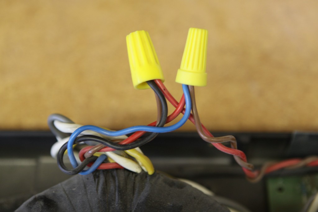

If this helps I did re-wire a Cyrus PSX to 120V from a UK Model, Cyrus had left the dual voltage leads i just had to figure out the wiring
I took the Brown and Black wires coming out from the transformer and wire tied them to the Red wire to the power switch
Then take the Blue and Red wires coming from the transformer and wire tied them to the Brown wire to the power Switch
Then if using the PSX and Cyrus II together you yank out the fuses from the Amp and do not even plug it in to the wall (unless using the phono stage that is)
As far as I can tell the Cyrus II did not have the dual voltage transformers, maybe due to size restraints inside that cramped shell, the PSX has plenty of room.
