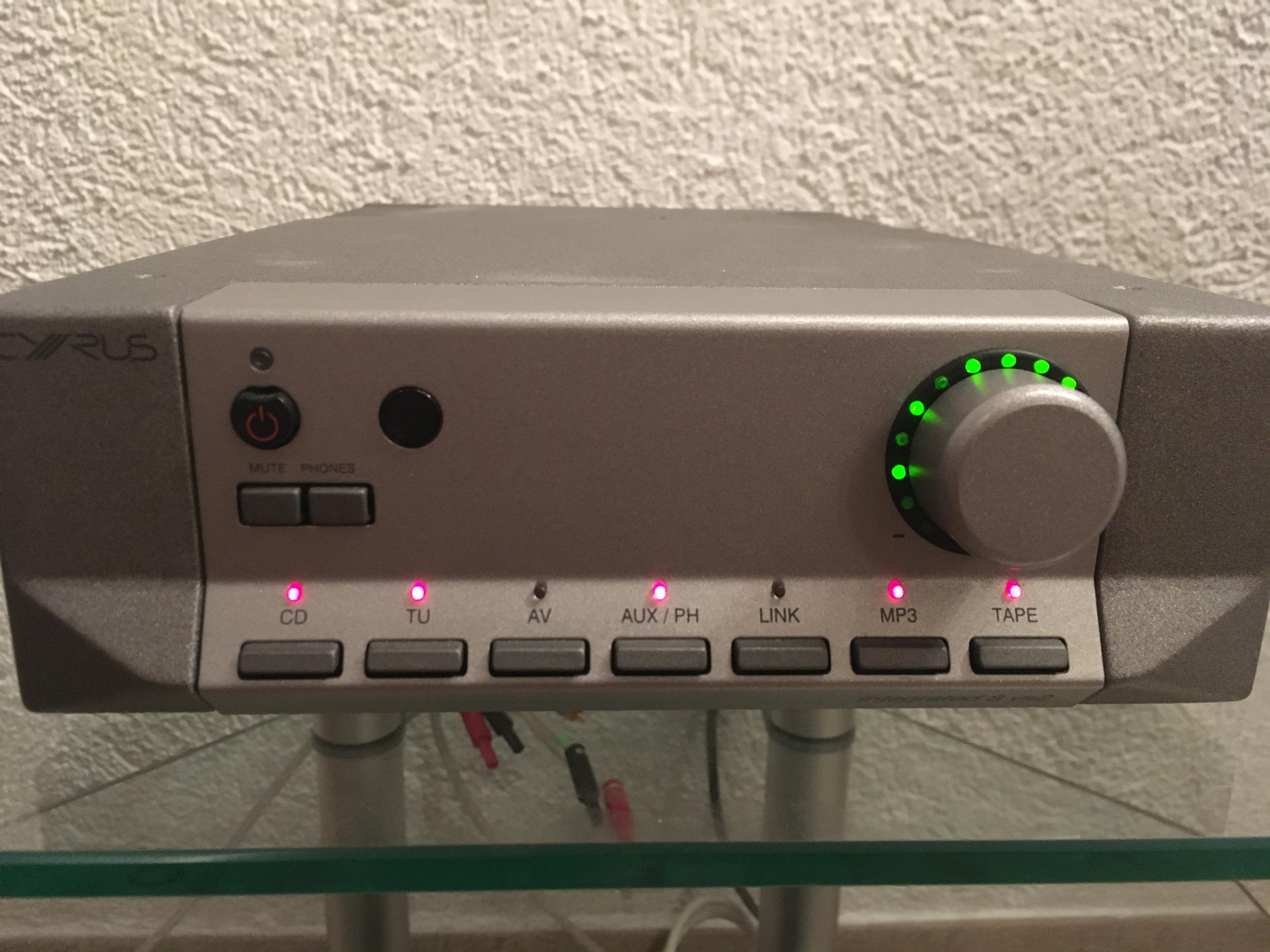

Hello chaps, I've been reading some of the other threads on this forum with interest to see if anyone had had a similar problem. I didn't really find anything so I hope you don't mind me asking for advice. Some electronics experience here but a beginner with audio systems (except for plugging in and listening).
My Cyrus 8 (vs2) has been misbehaving. It was happily running for years then occasionally it started displaying the sequence of lights shown in the attached picture. Then sometime later when it was switched on it would only display these lights with no audio output, except for a small pop when the output was enabled.
Then I took it back to England and had a professional look at it and annoyingly it worked perfectly there and for a few more weeks it ran fine here. Then back to the strange sequence of lights and no output.
Cyrus gave me the very helpful response of "sounds like a needs a service". Do any of you have experience with these types of amps? I'm just looking for advice about where to start fault finding so as not to break anything. Thanks!

If it's an intermittent issue, I would open the box and check the PSU Voltages or a broken solder pad or connector.
Tap the board with an insulated screwdriver or similar in order to find the fault.

Seems like for some reason the micro has gone nuts. There is a small chance it is related to PS or interface issues, but i am not holding my breath.
Otoh, it can make a cute micro or even Arduino project. All it does is reading the buttons, the encoder, the IR receiver and the protection circuit and controlling a bunch of lights, a few relays, an electronic pot and from what i remember turns the bias on or off when the power button is pressed.
Certainly not worth wasting time for a repairman but if it is for fun and self-education, why not?

You have to start learning AVR programming language, usually C or Assembler. There is also BASCOM (Basic based). It's not difficult. I've done it for decoding DMX in lighting projects. An AVR has inputs (where You link Your buttons) and outputs (Where You link source selection and Leds). It's just a matter of putting a few lines together in a loop testing the button status and activating the corresponding outputs and leds. I would add also some debouncing code for the button routines (Imagine You press 2 or more buttons at the same time)
As what the remote concerns, You'll have to decode the protocol in order to mimic it, or use some other type of well known remote.
You can find also code written for this. A scope connected to the IR detector would help here.

Does the uP have any kind of backup supply like a SuperCap or a Nicad battery?
The micro is always last on the list of suspects for any kind of fault like this.

Check the uP crystal connections or its corresponding decoupling capacitors.
Power up Reset circuit can also play havoc.
Find the reset pin and try to perform a manual reset (pull high or low according to the datasheet) Does it work now ?

Check the dc supply associated with this digital circuit. Sometimes a weak electrolytic filter capacitor may intermittently cause disturbances resulting in erratic behavior.

A leaky electrolytic in the reset circuit (usually employed for time delay) could do very much the same, leaving the micro stuck in reset and not doing anything.
