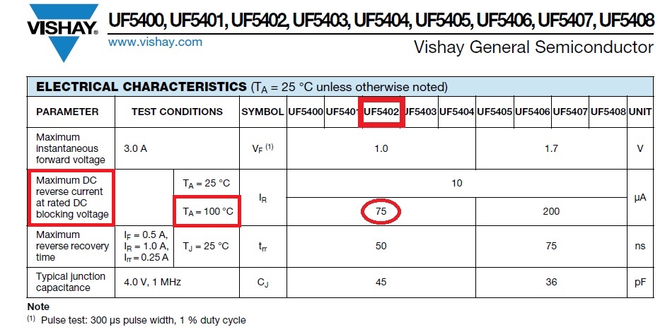

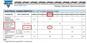

I've found an ultrafast soft recovery diode, a Vishay UF5402 to replace the GI852 rectifier diodes in my Cyrus 2 amplifier.

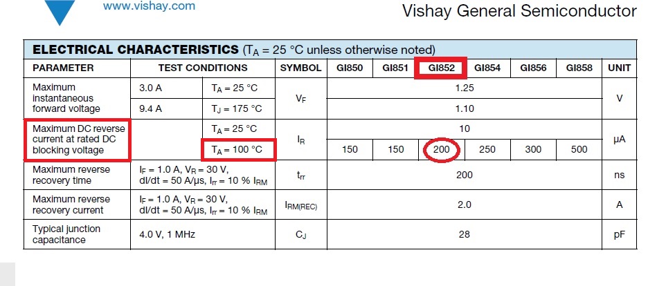

looking at the datasheet of the UF5402 and found that there is one difference between the 2, I would like to know please how important the marked parameter in the attached datasheets?
Can the UF5402 diode can be safely replace the GI582 diode?
