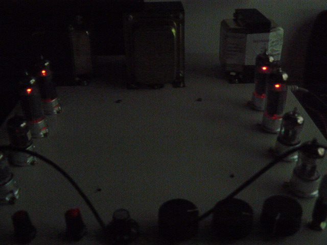

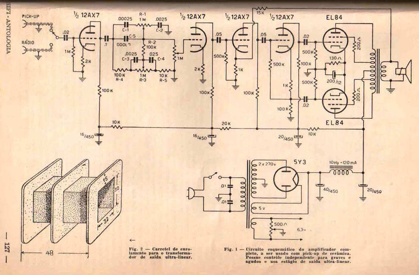

This week I finished my amplifier. The basic schematic is attached.
I built a stereo amp with two parallel monoblocks and one power transformer.
The amp is running very well.

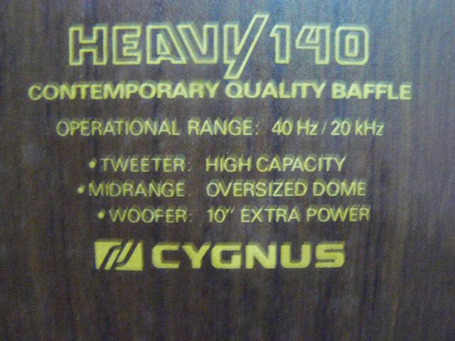

I have two ducted accoustic (three ways) box cygnus heavy 140. Each one is 0.6125L.
The ducts are diameter 48mm and lenght 40mm.
We can see the speakers here:http://www.audiorama.com.br/cygnus/caixa_acustica.htm#HEAVY 140
and here
and some characteristics are written on the baffle (see peciture).

Correction the internal dimensions of the boxes are 0.7m ; 0.35m and 0, 25m
Total volume is Vint = 0.6125L.
Other thing is: The midrange loudspeaker is sealed.
