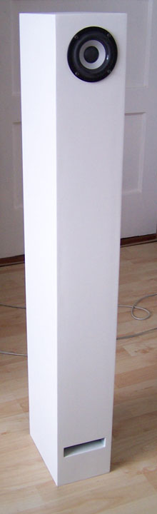

Hi I've got the Needle W3-315SC + notch filter, and they sound great. They do tike a while to break in, but when they are, there allmost as good as a speakerunit worth many times they money you'll pay for this unit.
They sound crisp and really fast. You can hear all the instuments in their own spot. Really nice speakers for a lot of music. (Except for Metalheads) See picture for my finished Needle-w3-315SC.
