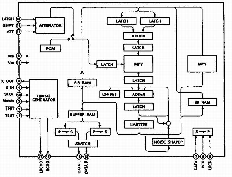

The last thing I can offer you (for the moment) is a picture of the CXD2554M.
Not exactly what your looking for but maybe a bit of help.

X-in on the CXD2552 is pin 39. The frequency is 45.1584 MHz.

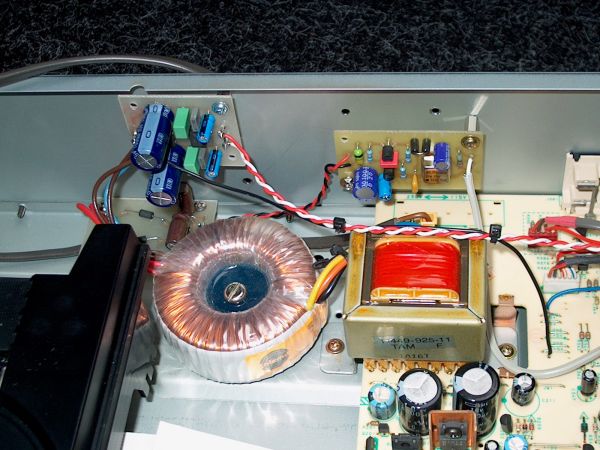

Just dismantled the CDP-591 and it has CXD2552Q indeed. The board has a CXD1244 as a digital filter in contrary to the spare board with the CXD2554P I have. The boards are interchangeable.
Thanks for the information.
This is why I asked. It had to be cheap so I used the things that were laying in my drawer.
Extra +/- 15 V supply for the output opamps ( now OPA2604 ) and a low jitter clock with a separate 5 V supply from a separate winding of the Talema transformer ( junked from an old printerswitch ). The +/- 15 V PCB is an old PCB with XR4195 for those that remember it. Better "old" regulation than none at all 😀
The shielding of the low jitter clock isn't finished yet, hence the drilled holes just behind the clock PCB.

Hi Jean-Paul,
So I helped you with the installation of a Guido Tent clock in a Sony player? I find that very funny!
BTW the clockoutput lead is way too long. Should be as short as possible.
I had some troubles with a extra supply in my combined player-DAC. When my discrete opamps were separately powered sound with the TDA1541 in the player was harsh. When I powered the opamps from the +/-15V from the players 7815 & 7915 sound was not harsh. I am a bit puzzled by this. I just pass it on. Maybe somebody knows why. I connected the grounds of course.😕 😱

Hi Elso, glad you think it's funny ! I still want to build your clock as time permits but Guido's won since it occupies so little space. The output cable is rather long but what is the problem with that ? With 45 MHz clock frequency I think the only way to avoid stray RF is to route the cable like this. BTW the cable is shielded of course. The clock can stray RF when not shielded as every clock module will. I will open the player again for mounting some extra ferrite rings on supply lines to the clock. It is it's first test-round this evening and I wanted to listen first before going any further.
Did you also change "polarity" of the second transformer ? Or did you use extra regulators connected to the existing transformer ?
In this player I choose to use a Talema transformer that has 2 x 14 V and 1 x 9 V to feed opamps and clock from separate windings. Ground for the clock was only connected at the ground near the CXD2552Q, the opamps ground is the small black cable on the picture and is connected to one of the branches of the more-or-less starground in the Sony. No rubbish on the lines now.

jean-paul said:The output cable is rather long but what is the problem with that ? With 45 MHz clock frequency I think the only way to avoid stray RF is to route the cable like this. BTW the cable is shielded of course.
Jean-Paul
Hi Jean-Paul,
How about reflections at the end of the coax cable as it is not properly terminated (with 50 Ohm for a 50 Ohm cable or with 75 Ohm for a 75 Ohm cable?)
No I did not use extra regulators to the excisting transformer. One way or an other it did not harmonise i.e. the opamps with its own supply and the DAC (TDA1541) powered from the players electronics.😕 😱
Hi Elso, reflections on such a relative short length of cable seems a bit over-cautious. It could be shorter in the final version. BTW it isn't 50 or 75 Ohm cable I used in this one ( for the time being ). It was a quickie and a cheapie as I said. Just curious what I could press out of this old Sony.
Anyhow, tonight was the first test-round to hear what progression is made and I just finished listening to it.
First impression ? Very good compared to how it was before.
Second impression ? It needs some work, have the feeling decoupling could be better ( BG ? ) and some ferrite beads will be tried. There was not a single cap on the mainboard replaced till now, they are all original except for the ones on the new boards. Output caps are still 47 uF 16V electrolytics. I ordered some 4.7 uF 50 V N series BG that I want to try in this player's output. Maybe a significant difference as other experiments with BG indicated till now.
So overall it is a lot better, despite of the slightly "metallic" character the CXD2552Q seems to have. Can't change that I guess, to me most 1 bit systems have that in them. Stereo imaging is OK and there finally was depth in the image.
