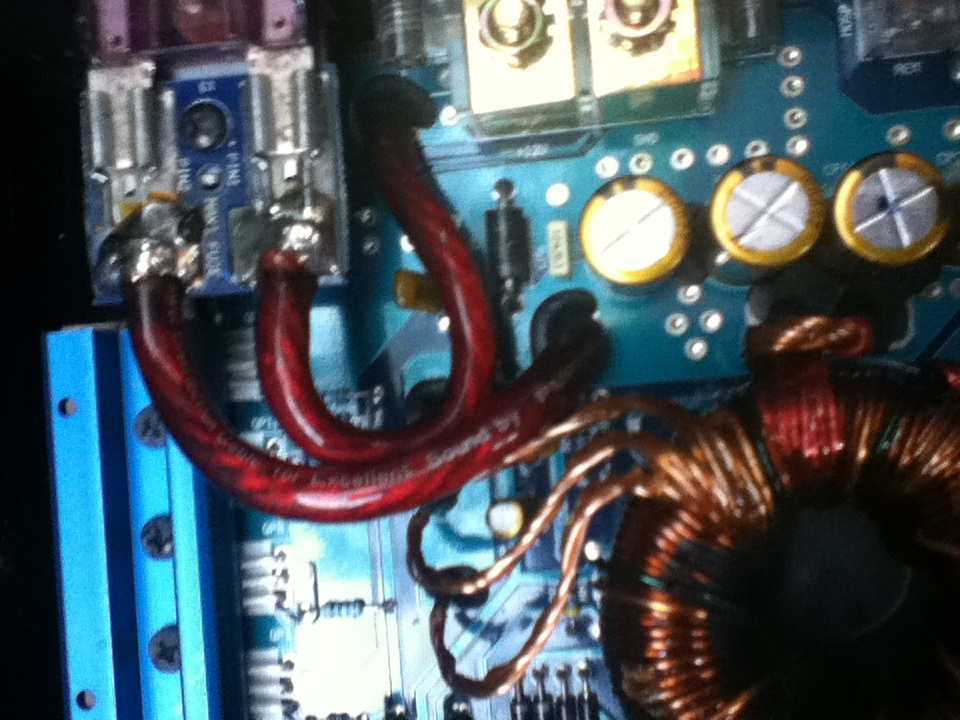

Cx 1200 D stuck in power protect mode.
I have 2 amps stuck in power protect mode. This happend while trying out different subs. I have 3 of these amps. The other amp never went into protect mode because there was no sub hooked up to it at the same time. I have a extra battery which leads to Pyle millennia capacitor which powers the amps which power their own sub. Any help????
I have no tools to check the wave pattern. When I touch the positive side of speaker output and remote together the speaker pushes up. I'm new to this and the one person who american bass referred me to said this amp is too old for him . He told me to retire the amps and buy some from him. I refuse to believe they are too old.
Ok I have read up on perry babin and his website. He also
Helped another guy on this site with the same model amp. I will get get wave patterns in the near future. And is it that hard to find 5 ring resistors. On Perry's site he mentions that those resistors are rare?
