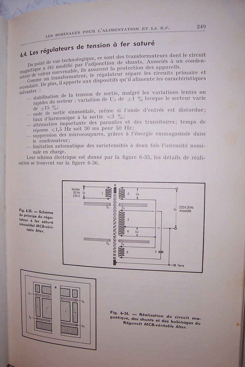

Is there anybody here skilled in the art of reckoning or repairing or designing or... CVT's, or ferroresonant stabilizers? I want to stat trying one of such devices, for low power and for may personal use only (not for commercial purposes) I have read some Sola patents from Google patents, but I would want some stuff more specific, with more details if possible.
Many thanks in advance.

I want to start making and testing it, but I have little info or data about them, no more than some US patents.

Also they have good voltage regulation with no SS, this (probably) will be the PSU for an amplifier under development. I see some battery chargers using the principle of functioning, as they have inherent current limitation and ar shorcircuit proof.
It is yesterday's tech, and there are little details to be found about the implementation because a lot of know-how was necessary above the basic theoretical information, and it was kept more or less confidential because lots of experiments and trial-and errors were necessary to arrive at a workable device: it was a trade secret
Nowadays, with modern design techniques, the design could be much more efficient and deterministic, but nobody is interested in it anymore, because of the poor efficiency.
You could experiment with saturable inductors in LTspice: the advantage is that it costs nothing except your time. When you experiment with real iron and copper, each step is time-consuming and costly.
A good starting point for real tests would be a microwave oven transformer: it already includes the magnetic shunt required (once you arrive at something satisfactory, you can change the turns number) .
SOTA regulators were much more complex than just a transformer and a cap: they were capable of providing their good, pure sinewave output for up to 1 second after the power was interrupted.
I must have documentation about MCB regulators somewhere, but it is in French, and does (of course) not contain any design-usable informations
I'm not sure of their very pure efficiency, but the other drawback I think is material consumption - large amount of copper and steel. Modern things, to be sold, have to be made from plastic and only small portion of copper or aluminium.
Here are some details about a state-of-the-art regulator:
