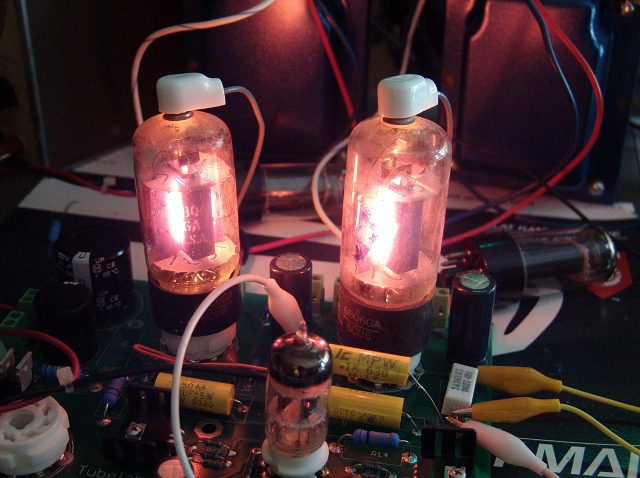

Trying to resurrect this thread, my sse is functioning in basic mode, ul, and with cfb. I've rolled a bunch of compatible tubes and all work.
I'd really like to learn what modifications are necessary to use this tube in my amp. It's a CV345 also known as 12e1. It is pin compatible with a wire from pin 3 to the topcap.

I understand it's a tetrode and has a 300v limit on screen grid. Can anyone explain why this would cause problems? In a previous post I was told it could cause issues with other parts like cathode bypass caps?
Any time you go out of the parameters the designer intended, you have to be prepared to experiment and live with the consequences, good or bad. Some work. Some don't, spectacularly.
I don't know anything about 12E1 - it looks like it might have been intended as a pass element in regulated power supplies. I couldn't get your data sheet to download, so I downloaded the attached sheet.
Looking at the last pages for a triode connected tube, it looks like the bias voltage gets really high - they don't bother charting it past 300 volts on the plate. The SSE is cathode biased - the negative grid voltage is derived from the voltage drop across the cathode resistor. If your SSE has a typical plate voltage of 450 ish volts, just dropping this tube in without more could make a cathode voltage of 70 volts or higher, and your current may well be more than 100 ma / tube, or more than 40 watts / tube.
What is the voltage rating on your cathode bypass capacitor? 63 volts? This is why tubes like this can explode the bypass capacitor fast. You probably need a significantly higher cathode resistance than presently installed, which will make the voltage drop even larger, thus an even higher voltage bypass capacitor is needed.
I use weasel words like could, looks, and probably, because apparently no one has done this on an SSE and you will be blazing ( hopefully no pun intended ) a new trail.
If it were me, and I make lots of mistakes, some expensive and painful, I would approach this tube with caution - I would try it as a triode; I would use a rectifier like 5R4 to minimize the plate ( and screen - since they're tied together ) voltage; a 100 volt bypass capacitor; and I would probably start with a cathode resistor of about 820 ohms, 10 watts, with meters on everything to see where I was at. Once you get a feel for what this tube does, you can go on from there.
The mu is kinda low, it will need more drive, might not sound as loud.

I'm using a phone so l can't go into the details now but this tube will likely blow the cathode bypass cap and possibly the resistor. The 6BQ6 and 6DQ6 also share the same pinout.The 6BQ6 can be made to work, but no so well. The 6DQ6 blew my board. This tube looks more like a 6DQ6.

My B+ is 425v
Not sure I'll have to look at the board as I bought parts and assembled the board 1.5 years ago with a major move in between. I only started testing this now as I finally found the transformers that were packed away recently. Lol

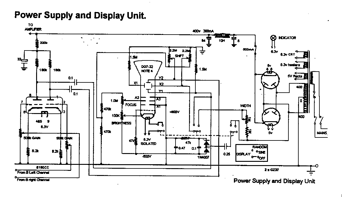

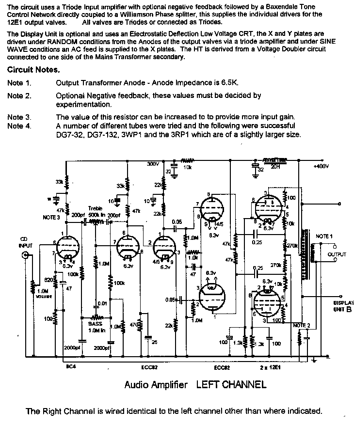

Found this one on the Triode DIY homebrew amp page. Though searching for 12e1 schematics turned up more, I originally searched for CV345 as that is the boxes I have. I'll report back on bypass caps and cathode resisters shortly.

Your 12E1's have a maximum screen voltage rating of 300 volts. Your B+ is probably in the range of 420 to 450 volts. The 12E1 isn't going to like this.
The SSE uses cathode bias, sometimes called automatic bias. G1 is grounded. There is a resistor and a bypass cap from the cathode to ground. Current through the tube goes through this cathode resistor causing its voltage to be several volts positive (25 to 45 volts in an SSE). This makes G1 more negative than the cathode. If the current through the tube rises, the cathode voltage rises causing the apparent G1 to cathode voltage to be even more negative, reducing the current through the tube.
Applying 430 volts to a screen grid designed for 300 volts maximum will cause a lot of current through the tube. This will develop a lot of voltage across the cathode resistor in an attempt to reduce this current. If this voltage is high enough, the cathode resistor, it's bypass cap, or both will die! Simply sticking in bigger parts may subject your tubes and transformers to more current than they were designed for causing damage...... this can get expensive quick.
I ALWAYS experiment with expendable parts (especially transformers) until I am satisfied that stuff won't blow up. I use adjustable lab power supplies on everything so I can find out where I can ignore some ratings, and where I can't. I have been doing this for over 50 years, and I still blow stuff up!
Back to the SSE with 6BQ6's. Those sensitive screen grids (175 volts max) really didn't like 450 volts. The tubes glowed like light bulbs....for a few minutes. I connected a variable power supply to the screen grid, and fed it 150 volts, and the tubes did work, but they needed more drive than the usual audio tubes, so you couldn't get full power from a CD player.
The bigger 6DQ6 caused the cathode voltage to rise into the 80 volt range leading to the death of the 63 volt bypass cap.

This IS an audio amp design. It also includes some type of crude oscilloscope to display something resembling audio. It however can't work right, if at all as it is drawn. A quick look shows two major mistakes. The connections from the amp to the oscilloscope have about 400 volts on them since they come from the plates of the output tubes. They connect to the wipers of the input pots on the "scope." Turning the input all the way down will short out the B+ really frying some parts. The design also puts the tone control INSIDE the feedback loop. This is a good way to make a very loud oscillator. It also violates the 300 volt screen grid rating of the 12E1. I doubt that this was ever built.
I agree that the 12E1's would be best used in some sort of push pull amplifier. They would probably make well over 50 watts per pair too.
Ok thanks George for that great explanation, I think I'll pass on trying to stuff this tube into the sse. I did find a bunch of other designs after searching for 12e1 schematics so perhaps I'll look for one of those to play around with.
