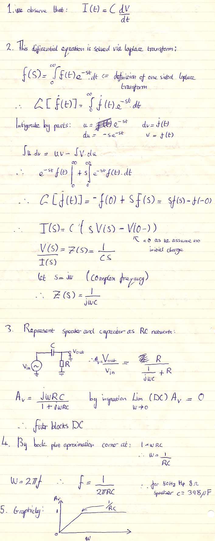

How is this calculated?
Like a normal filter. You just use the input impedance instead of the speaker impedance.
It's also called a PLLXO.

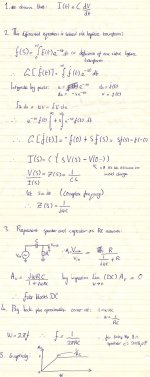

by much maths! see attached. The formula at the end is probobly the only bit of interest but I felt like showing why this works. Disadvantage of first order filters are there very slow roll off (-6dB/octave).
higher order filters must be constructed out of inductors and capacitors to be practical or be at line level.
