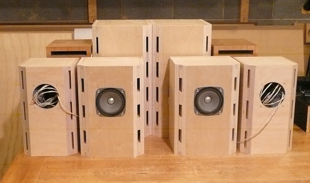

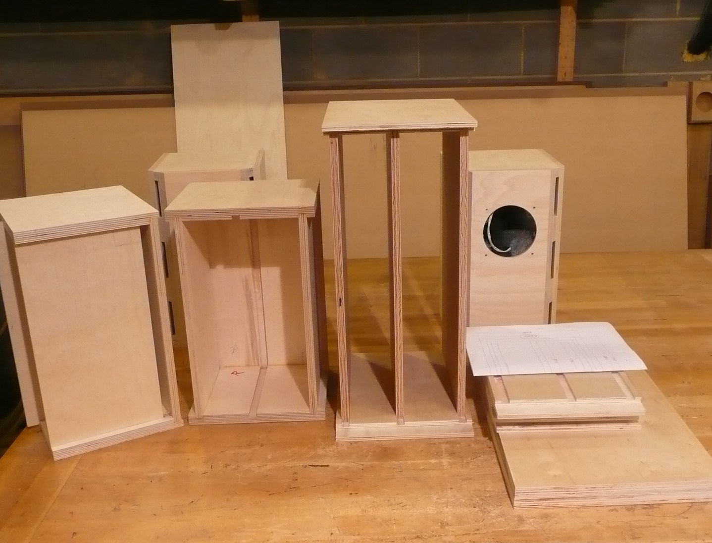

I hope kornnylike won’t mind a few “off topic” pics on this thread… These are called Fonkens and Onkens
I’m finishing up a pair today.
[Wish I was down south today; old man winter is rolling in here today]
