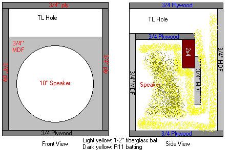

No idea on the speaker (a 10" from some console), so consulting you guys wouldn't have much effect, so I hear (though I did once try measuring free-air resonance, something like 40Hz). So I went about it arbitrarily, myself.
I took a 12" square of 3/4" particle board and cut a 9" hole for the speaker, front piece. 12x15" back panel, same board. The rest is 3/4" plywood: two sides 13.5x15", top and bottom 13.5" squared.
The TL part is formed by the front falling 3" from the top; a baffle extends into the box, perpendicular to the front, to form some 'line'. I slapped on a 2x4, perpendicular to the baffle, and attached to its end, to bend around the line a bit more and add overall stiffness.

I can make a scale drawing in Paint, however any photos will be months off due to Dad being very lazy in developing the film..

If it's not long enough, maybe that's why it seems to peak a little around 100-200Hz (SWAG). Maybe extend past the 2x4 to a few inches from the bottom?

Updated diagram attached.
