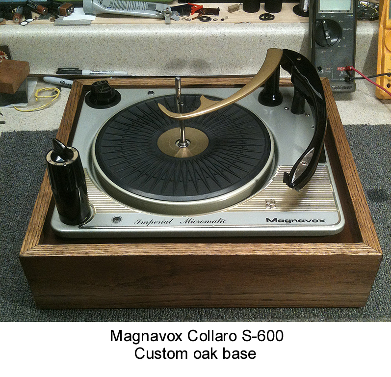

About two years ago, I sold off a nice Imperial Micromatic 600 to a customer.
Naturally, I completely overhauled the machine, which came on an oak veneered wood base.
I chose a Pickering cartridge tracking at 3 grams for it, re-wired the tonearm with ultra flexible shielded wiring.
The mechanism was in perfect condition, lubed, adjusted, etc, and with new drives and rubber was utterly silent, speeds dead on with the synchronous motor. (the Imperial versions used synchronous motors).
The customer loved it, and even sent me pics of it in his house.
I'm sure it'll give him good performance for decades - the Collaro's are well built British changers.

About two years ago, I sold off a nice Imperial Micromatic 600 to a customer....
Beautiful! Yes, my impression is that they are built like tanks, with the same quality seen in Garrard and other venerated changers.
