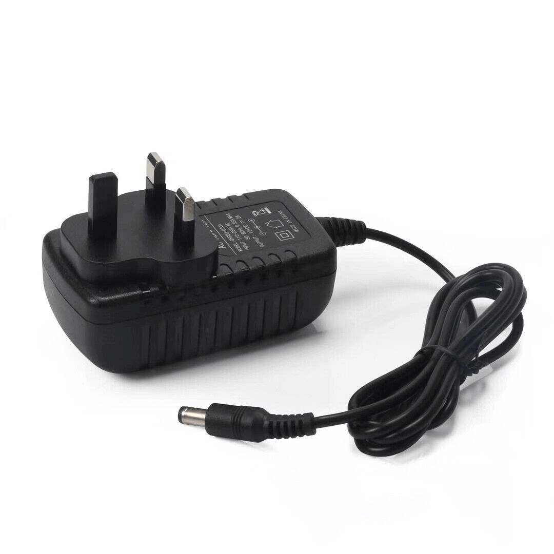

The power would come from a AC-AC wall wart, like this or this so, for instance, windings would be primary 0-24V, secondary 2* 0-9V and 2* 0-18V
First of all, is it even doable? I've never seen this mentioned as an option, and I've read several threads in this forum.

The picture shows DC on the output. Dots under a solid line... Not to mention it's switching, not linear.
Maybe there are more than one type for sale in the listing.
In any case, if you don't want to "touch the mains" I suggest you use an off the shelf SMPS and make your design work with 12VDC
