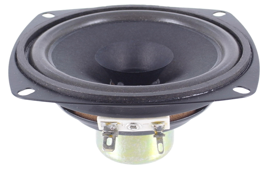

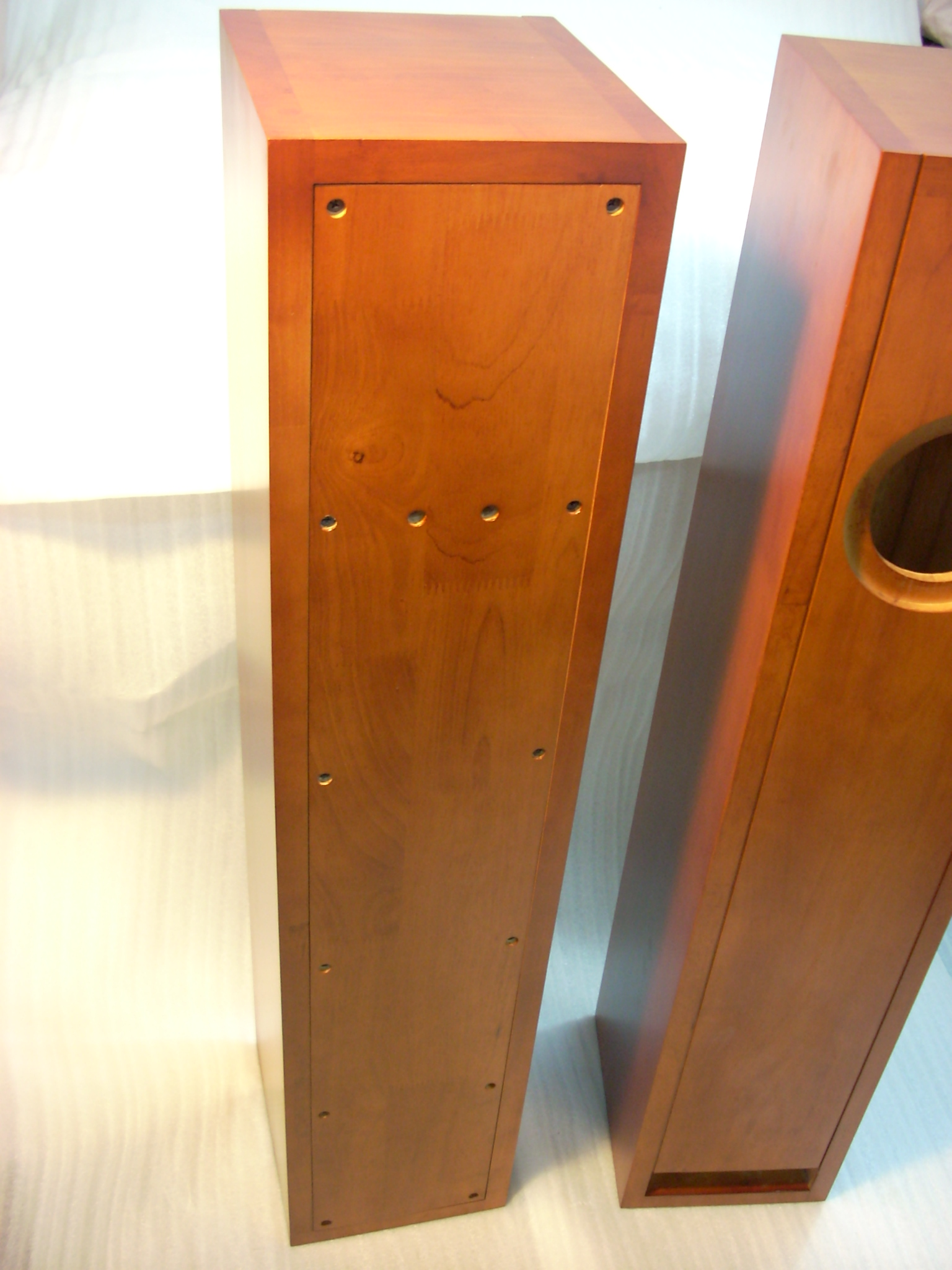

Tony,
This is the driver I have got, it's not the 4" one, instead it's the legendary 3" aluminum driver. ;-)
https://www.madisound.com/store/product_info.php?cPath=45_241_282&products_id=83
First of all, this is a sealed cabinet.
Secondly, the hole inside is not meant for driver mounting, instead it's just a hole on a board for bracing to strengthen the cabinet, so only two drivers (one on front baffle, one on rear) will be used. Sorry for the misleading drawing. I just want to make sure the cabinet is as acoustically dead as possible.
This bipole design eliminates the need of baffle step compensation and are force canceling and the benefit of doing so is to get rid of coloration due to slightly off-valued resistor and inductor, and to minimize vibration.
12mm MDF should do, but if the price is similar, will it be better to get plywood, especially I want to have the hole around the driver routed like the one in this thread: http://www.diyaudio.com/forums/full-range/62801-aurasound-ns3-193-8a.html
I would also like to rear-mount the drivers like the way it was mounted in the thread mentioned above.
Finally, can I get it painted in high gloss white (piano finish), and how much are the cabinets going to cost?

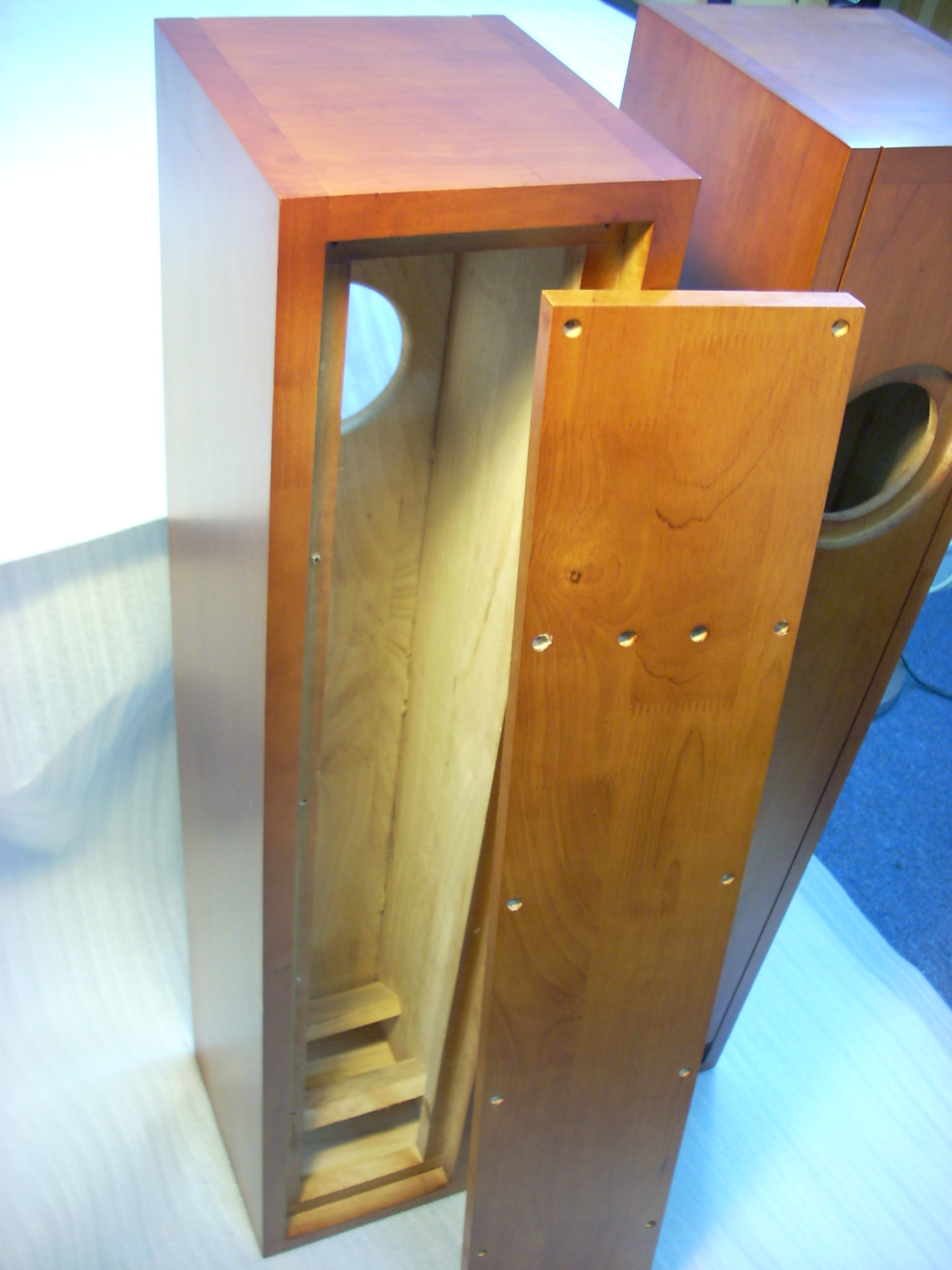

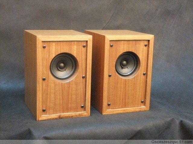

Hi Boris,
Undstood what you mean.

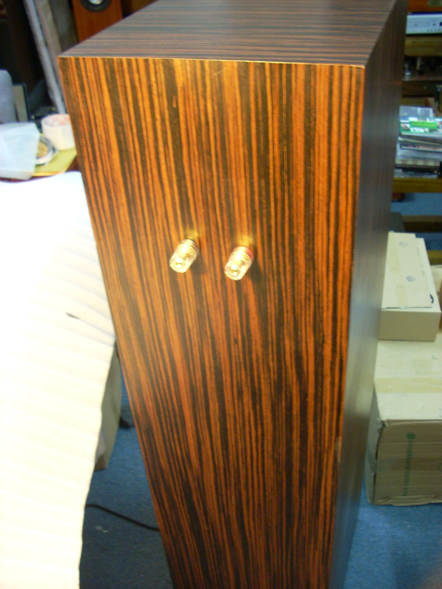

I'll ask the MDF/Plywod maker whether he has 12mm plywood board. Rear-mount the drivers should like the picture attached.
MDF/plywood with veneer are available only now. The picture is MDF cabient with ebony veneer.
Please send me the drawing in detail.
