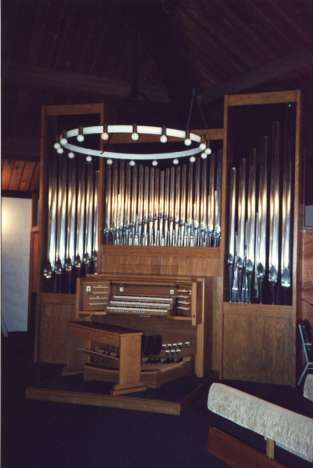

I would disagree with the use of animal glue. Having built pipe organs for over 30 years, I'm very familiar with animal (hide) glue. In pipe organs we use it for applying leather and other things that will eventually need replacing because the glue can be easily removed with window cleaner. Titebond (alphatic resin glue) is used by over 90% of instrument makers.
Photo of one of the many organs I built.
