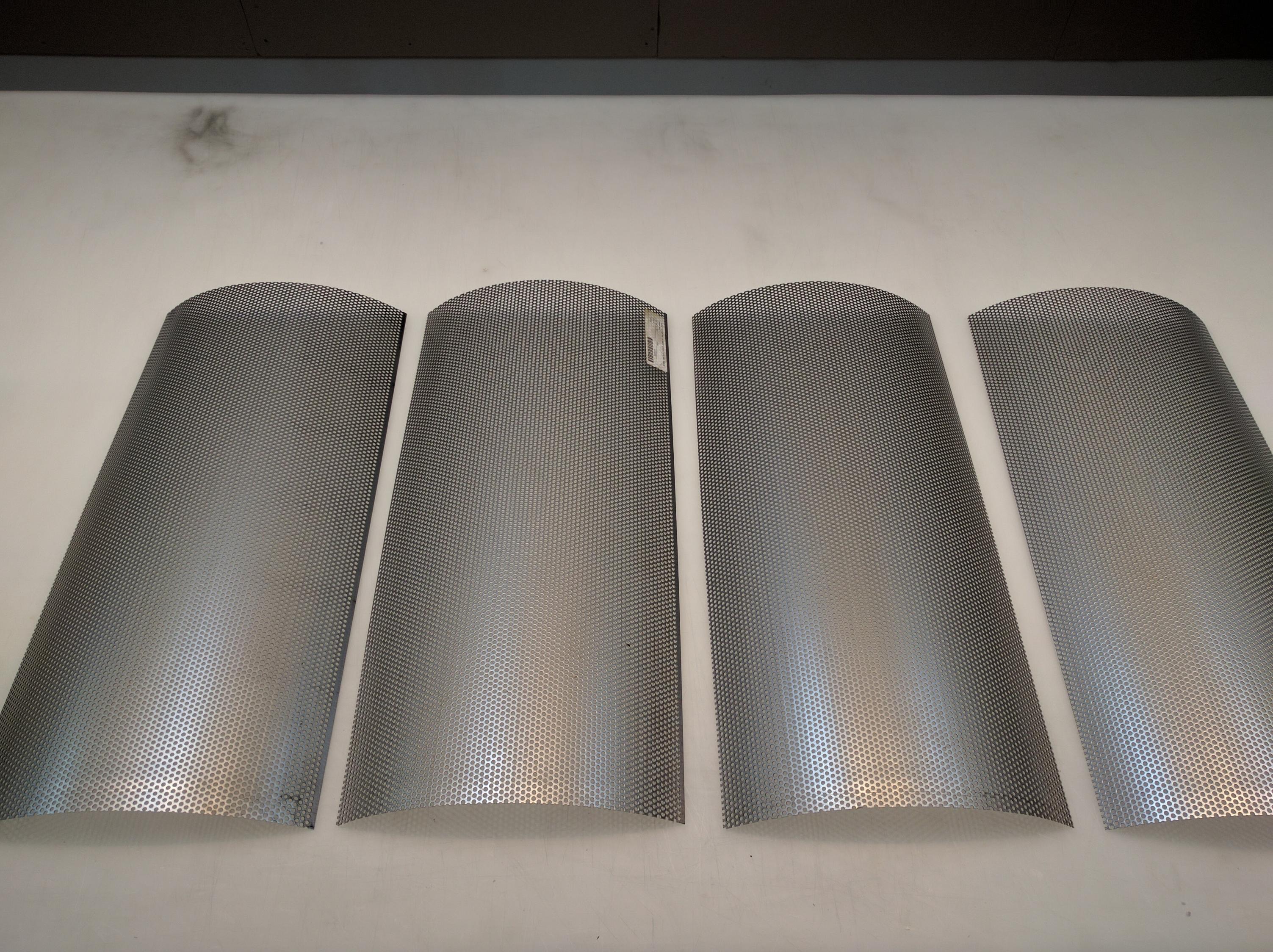

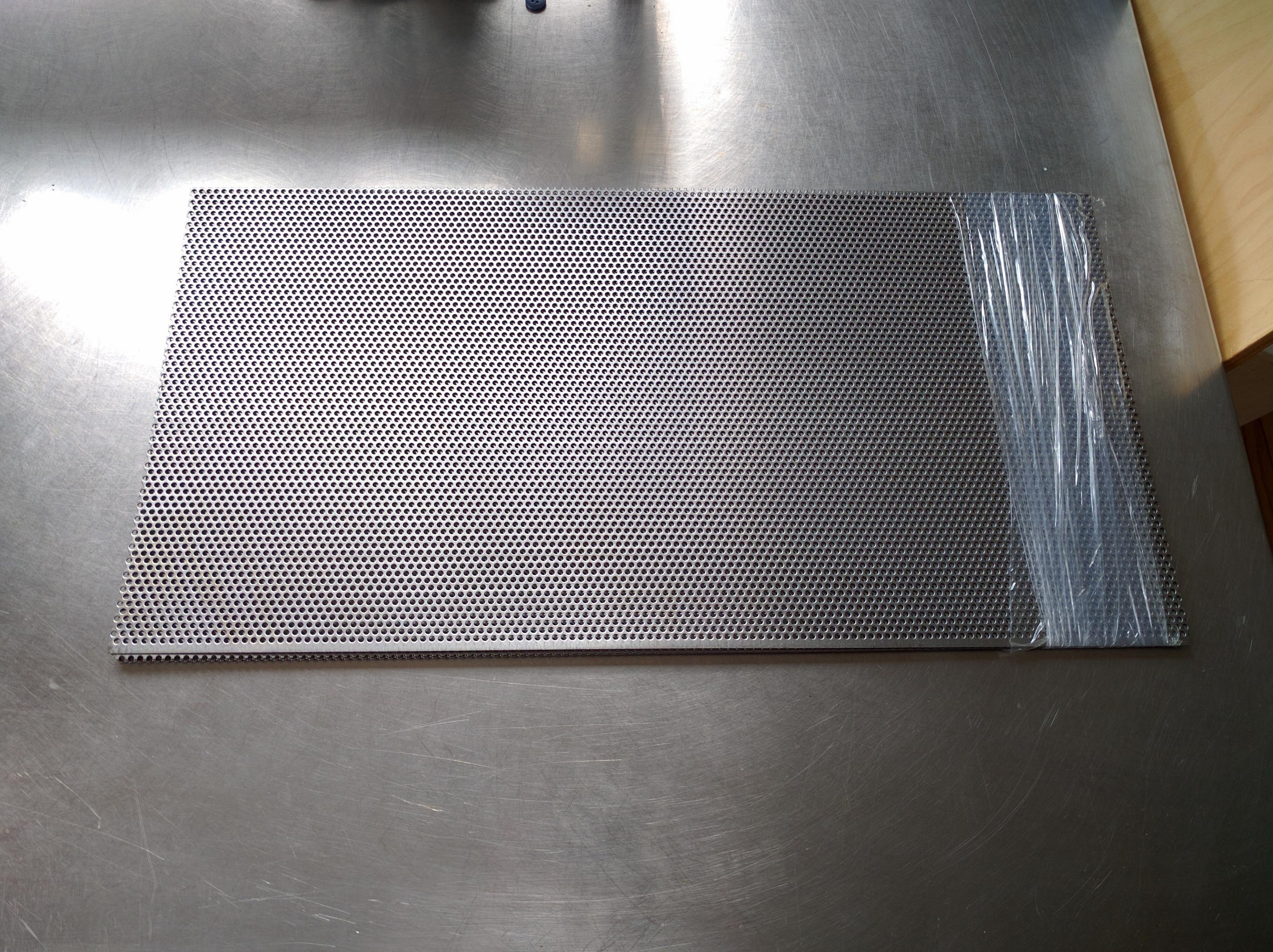

I received the sheet metal about a month ago and I just got to rolling it last weekend. I don't know exactly what the curvature of the metal is but no doubt it will be better than a flat panel in terms of dispersing sound. I've attached some photos of the flat metal and the bent metal.

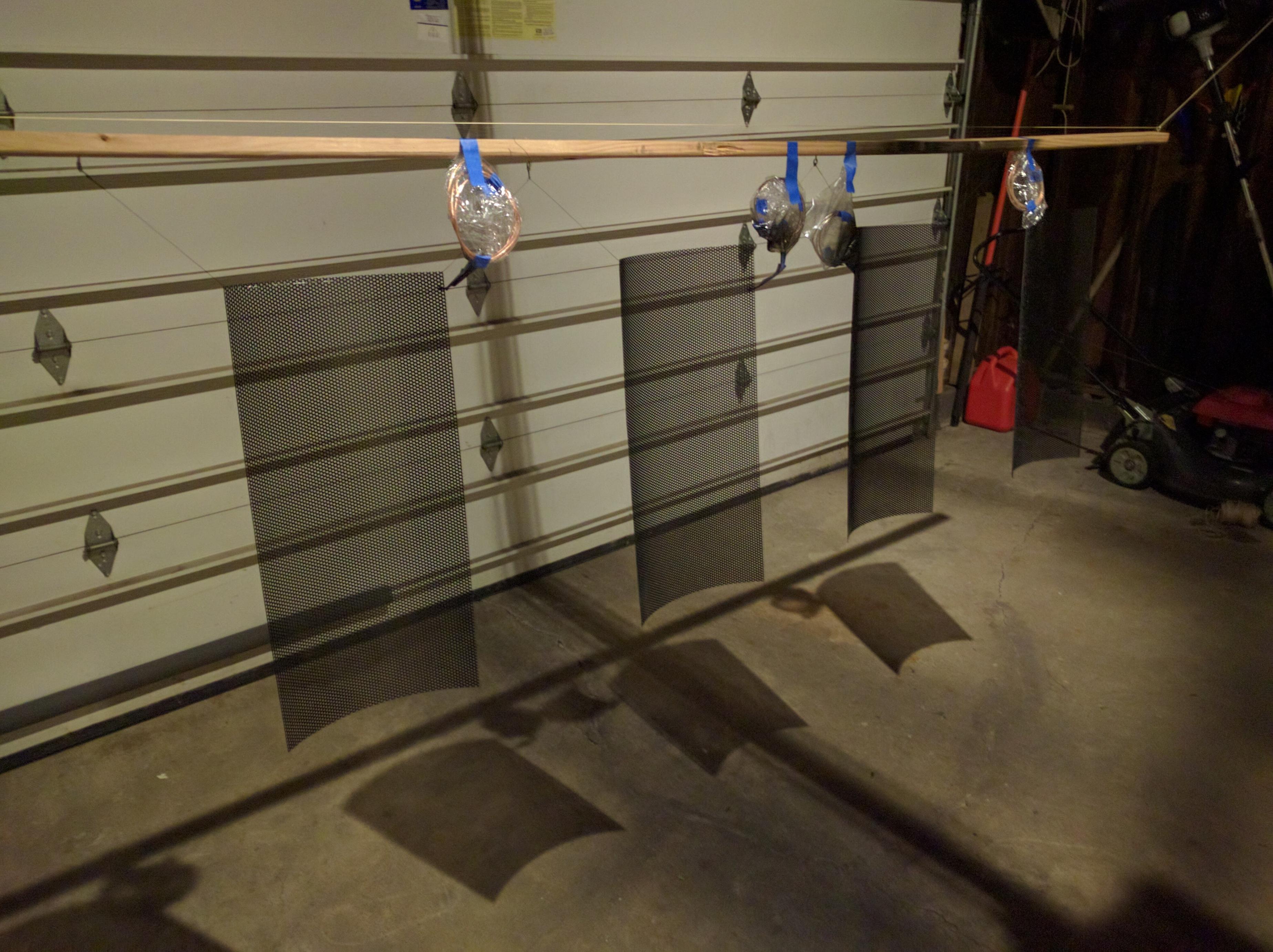

After soldering the wires onto the stator I hung the panels up for some coats of primer and a just a few coats of black polyurethane spray paint. The black paint is super economic at less than a dollar a can from Home Depot. I just started painting today and should hopefully be finished by the end of the week.
You did a nice curvature, though a little too much for my taste.
It'll become difficult to tension the membrane.

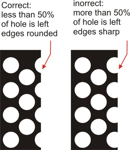

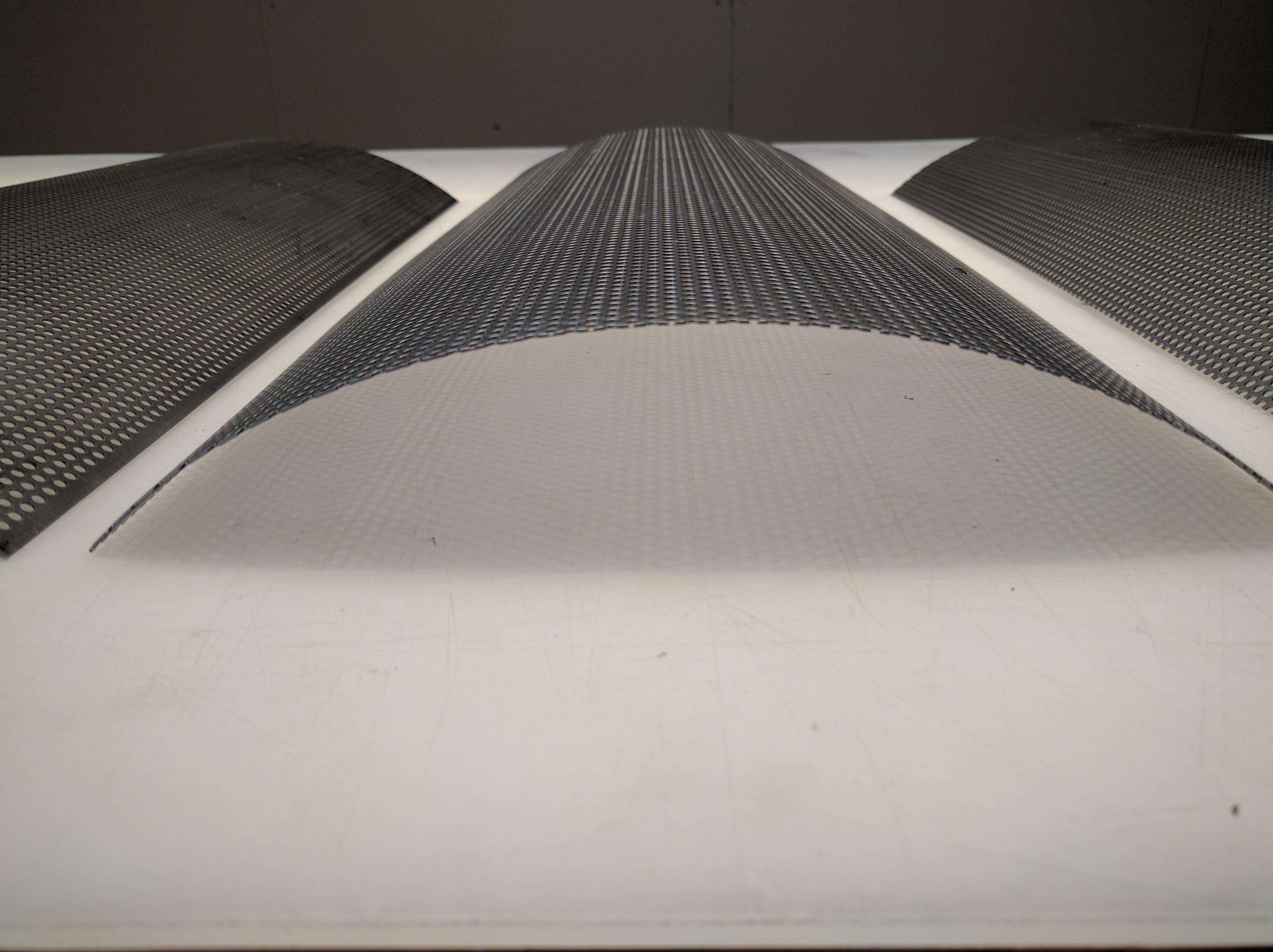

Also it looks as if the cuts in vertical direction are not done well.
In the first pic the left edge (top or bottom edge of the panel) looks well cut with no sharp edges.
The side edge though (upper edge in pic) starts quite smooth from the left corner and becoming more rough towards the right corner.
The sharp pin-like structures that appear when less than half of a hole is cut are prone to flashovers and should be avoided as they are also difficult to insulate properly.
Best would be of course a solid rim like the one visible at the lower edge.
Besides insulation issues a solid rim is also advantageous regarding glueing spacers and the membrane to the stator.

I hope things will go well, but I'm afraid Your panels required a bit more pre-painting preparation.

Many layers of laquer are not neccessarily the way to go, as a thick layer builds up only around the pin structure where it is not only not needed, but may alter the d/s value (with low d/s hybrid panels think in 1/10mm precision range rather than 1mm range).
The buildup at the peak structure itself may still not suffice if its a very sharp pin as the field strength is the strongest here.
Even if the flashover treshold of the insulation is high enough at the beginning, it may age faster and lead to a premature breakdown.
A layer of tape is a good measure to raise the flashover treshold and to protect the edges, but of course should rather be used as an 'add-on' detail, not as a neccessary part of the 'prime' insulation.
Clear singlesided PVC or PP tape (e.g cheap package tape) comes in well tolerated thicknesses around 0.1mm (PP also has self-healing characteristics) and is mechanically quite strong.
Spacers made from 3Ms foam and VHB tapes stick well to PVC tape.

Top and bottom rims need to take considerable amounts of (shear) forces which require a sufficient glue joint area.
The forces are in fact so high, that ML and I also use additional glue area in that we fold the excess membrane back over the rim to glue it on the outside of the stator too.
You have to consider that as Your stator sheets are not solid, but punched up to the top and bottom rim, the glue joint area between stator and spacer is small, i.e. it can take less force.
jauu
Calvin
Don't know about the chances of success, but just that it becomes more difficult and requires even higher levels of precision and possibly a number of additional test runs, before the proceedings fit.....but will it be too much to make a successful panel?
jauu
Calvin

never tried Your putty idea, but I don't see a reason it shouldn't work.
It'd be too much effort for my taste, as a slightly larger amount of taped area will do the job also.
The folding back of excess membrane is a very effective trick to increase glue joint area and to handle the shearing forces without reducing the 'active' area of the panel.
Almost all punchers I contacted -even the very large ones- offered to punch Your hole pattern from 4-8 sheets on for reasonable cost, not much more than cutting strips from larger pre-punched sheets.
I'd rather spare the effort and order sheets with solid rims ... which also guarantees that the hole pattern is the same on all sheets, so that the holes of the two mated stators align well, giving best optical transparency.
You can also ask them to use fresh tools, so that the hole edges are less pronounced and less sharp.
Takes less effort to sand them down.
And some can even bend the sheets for You.
jauu
Calvin
