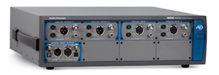

AP uses a number of blank front panel subpanels that are replaced with new options.
Jan
Jan
It's a nice idea. But this probably won't be physically big enough for that to make sense. Also sanity checking to see if we should modularise some of the bits inside (the enclosure at the moment is around 230x175x60mm), even if just for serviceability - keeping a keen eye on the Bill-Of-Materials here.
