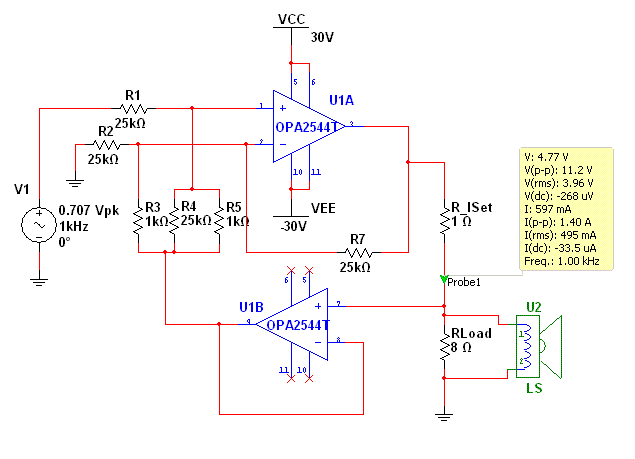

Been there, done that a year ago. I've got a LM3886 amp in a classic V-I configuration. For best results, you need to ensure the speaker impedance is as flat as possible and/or use a series crossover. I use a fullrange driver with mine with a zobel to level out the impedance and avoid the complexity of a crossover. Watch out for the impedance spike at resonance frequency, it can cause clipping.

Dear fenris,
Do you mind sharing a bit more on the details of your circuit. Did you just put the speaker in between the output and the -inverting input. And a 1 ohm between the inverting input and the ground? Or maybe an additional voltage divider?
I actually planned for it for woofer use in an open baffle, so it needs plenty of equalization anyway. The additional boost attacks resonance could come in handy since I need a bit of boost at fs anyway.
I am just thinking the phase relationship between woofer and the fullrange will be better.
How do you like the sound compared to normal voltage amps?

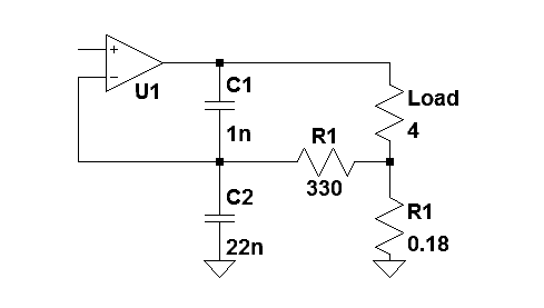

I'm using specifically shaped output impedance to drive transducers for quite a while now as the answer to the old question of wether voltage drive is better than current drive. No simple answers here.
Not necessarily pure current drive is the optimum for any given transducer, neither is standard voltage drive (driver terminated with its own Re) nor full feedback (driver terminated with something as low as Re/10 by setting an output impedance of -9/10Re). Rather, one usually can find a complex drive impedance profile (DIP) that gets the most out of the driver in the given situation.
For any comparison (and any working solution) you *must* EQ either the feedback signal or the input signal to obtain identical SPL responses no matter what DIP is dialed in via the feeback network.
I tend to do this pre-EQ with DSP processing for convenience, forcing the driver's terminal voltage to common target regardless of any impedance tricks employed.
BTW, For current drive (with chipamps), Howland current pumps are not required unless you *must* reference one terminal to ground for some obscure reason. A shunt in the ground return does exactly the same thing from a circuit analysis standpoint.
I've been using circuits as simple as shown (not showing Zobel and Load stabilizing networks). It gives a Zout equal to that of a small series capacitor (2uF) which is close enough to "pure" current drive. At 10kHz |Zout| is about 8Ohms, increasing 10x for every decade you go lower in frequency
