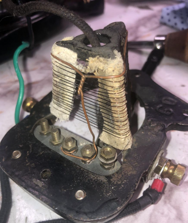

The AC motor is from a 1940s desk fan. There used to be a speed coil (I guess something similar to a wire wound resistor) but it is gone now. I want to add at least one speed to the fan so that's why I was thinking of using the current limiting resistor. But I am open to suggestions for something else that will work in this case. I will research the triac regulators.

I do have measurements from the same fan in working condition so I know that the original speed coil had two resistance values 10 Ohm for medium speed and 15 Ohm for slow speed. I can get both resistors and try. I may only wire the 10 Ohm for medium speed if the slow speed generates too much heat. Afterall, the resistors are going to be in the base of the fan that's fully enclosed.

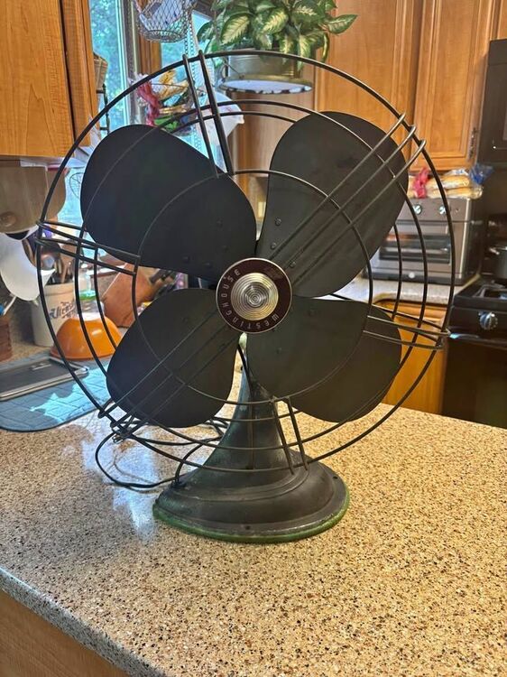

Please post pictures of this vintage fan.
Say 2x15V secondaries for full speed & 2 slower speeds.
Fan

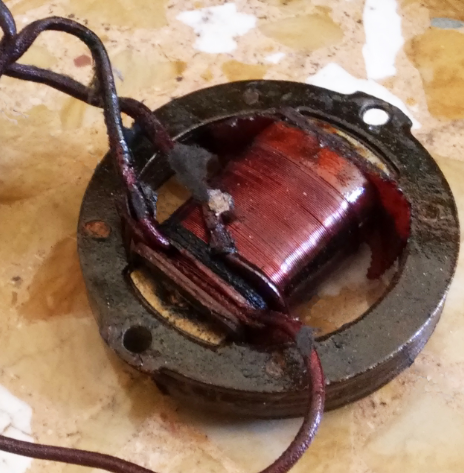

And here is the AC motor. It only has two leads so the speeds are controlled by dropping the voltage.
