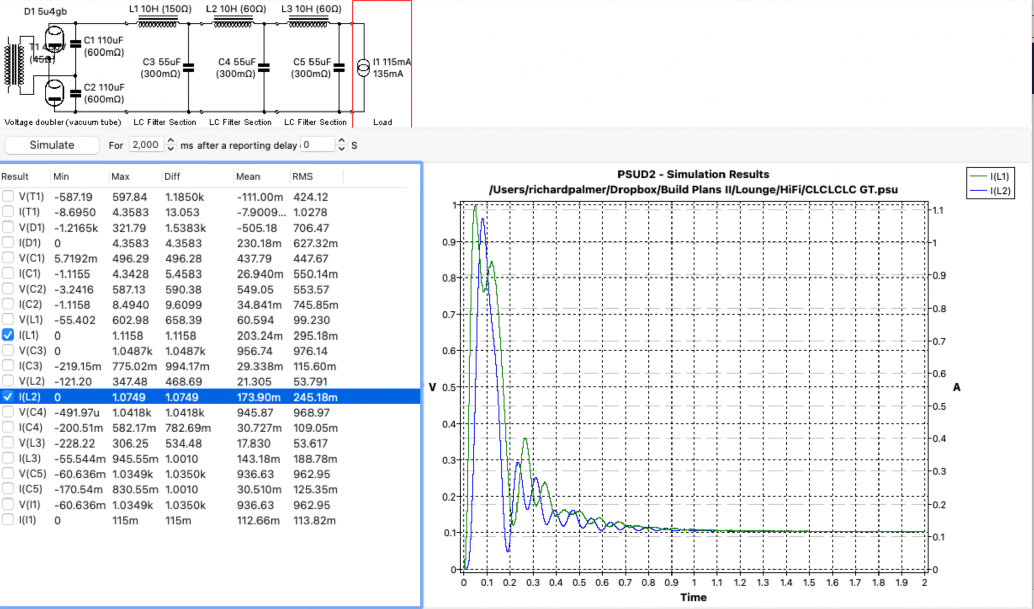

Hi, I have an existing PS using multiple chokes in the DC filtering for B+ supplies, that is fed from a valve rectified supply. The rating on one inductor in the circuit circuit is 60 mA and the circuit is at about 30mA steady state and the other is 150mA rated and has about 110mA steady state. So all good, and in the circuit they have been having no problems for about 20 yrs.....
So Why the question? Well I am changing some elements of the PS and some values of capacitors and the layout and on my new designs I see some large peak currents on start up modelled in PSUD2 with these new designs (and also actually the old designs)
So my question is should I just ignore these peak values as fake news (or irrelevant transient peaks that should not trouble the inductor) or should I pay closer attention to them?
The rectifiers are 5u4GB for the PS in question.

Here is an example of the existing system modelled for inductor choke inrush current and this has been working fine to date (20 years!) hence my question when I remodel as to the ability of a choke to take these sort of short term currents, assuming the software is fine and accurately predicting these large transient currents. By deductive logic yeah it's fine but, it sort of feels like it deserves a discussion with more experienced builders.
What happens during turn-on doesn't directly relate to amp audio operation, but could be of interest if you were modifying or adding protection parts like a fuse. As evidenced by the 20 years, it is not damaging the choke, and the 5U4 has a 4A transient peak rating so again no issue.

There can be linear and nonlinear transformer/inductor inrush currents. If you are concerned about turning an inductor or transformer into a blown-fuse due to more or less linear expected inrush current, that might be one question. If you are concerned about nonlinear turn-on transients that can intermittently occur and which can sometimes damage some types of circuitry, that might be another question.

I also had an email exchange with Pers from Lundahl and he confirmed that he was not concerned about the inrush into the chokes.
at power up, chokes are open circuit under transient conditions, opposite that of an uncharged capacitor....this is basic knowledge afaik....
We might say for some particular idealized series circuit model, when an idealized switch is closed at t=0, the instantaneous initial current in an un-fluxed ideal inductor would be i=0.at power up, chokes are open circuit under transient conditions...
However, a physical inductor and power source may or may not be well represented by that model depending on the particular problem or question at hand. For example, there will be some rise-time when a physical device is first powered on. Also it might matter how long inductor current would stay reasonably close to zero. Even in an idealized model the 'open circuit' way of thinking about it is only exactly true for an infinitely short period of time. Physical inductors also have parasitic parallel capacitance, self-resonance, some practical breakdown voltage, possible residual core flux, etc. Such things may or may not matter, depending.

Thanks guys, I was after a view on the reality of a circuit that could have a short potentially damaging level of current if you believed the simulation. 🙂
