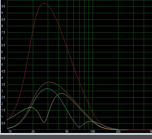

I think I have a solution. As it happens, I have an RS265HF on the shelf. So a second one is less expensive, lowering the "domestic distortion" factor. The 12 inch CSS is nice, but If I believe the late Paul Klipsch who demonstrated efficiency and distortion being inversely proportional, and my own measurements showing how excursion is a non-linear driver for distortion, my goal to lower real distortion is as low apparent amplifier power and as low excursion where the most content is expected. I figure far more content between 50 and 100 than 20 and 50. The later being mostly effects and having a larger masking. I wil say, price no object, a pair of the 12 inch CSS would be outstanding in all respects. Their motor is amazing.
The following graph has enough added filters the response as expected in the room after the AVR does it's thing for eq. so the solutions are comparable in-use. Actually probably light on room gain so the below 50 is probably pessimistic.
So , a pair of the HF's Several solutions.
Red: Existing single 10 inch Titanic sealed. Clearly anything is an improvement.
Orange: two HF's sealed 4 cu ft. and still not critical Q. Barely exceeding 1/3 x-max so actually probably not a bad choice for simplicity
Yellow: 2 HFs in a ported 4 cu ft. A good start.
Blue: 2 HFs BP-4 It is a BIG box. 5 cu ft. Probably have to build modular or I could not lift it into place. In theory, not being a direct radiator, the front chamber will filter some of the harmonics making the actual HD lower. I have not measured this myself.
BP-6 is not shown. It has potential, but port dimensions were not workable.

Yup. 2 10's BP-4 do have sufficient displacement to be an advantage over the Peerless 15.
I have just about 5.5 cu ft total so just enough to do a built-in including driver , amp and ports. Says 2 4 inch faired ports have low enough Mach number, but I might go bigger if I can find some made.
Settled on a solution using BP-4 with a pair of RSS 10's. Larger drivers would not get me a high enough crossover and I don't need the lower extension. 4 cu ft total, and the tuning ratio came out as 5:3. A pair of 5 inch ports or maybe a slot to keep Mach under .025 @ 110 dB. 12's or a 15 could not cross high enough for the AVR crossover to be in charge.
I was able to tune a BP-6 but after adding the filters for "as used", no advantage and a 45 inch port is not too handy.

On advice from others who have built them, I was alerted to the issue where a peak will amplify any HD that falls in that range. One thought was to shift the peak to the low end where there are no harmonics to excite it, but would be venerable to IMD. So, reworked yet again. Only 2 dB ripple in the pass band. Not as low excursion as the highly peaked version, but compared to my current single Titanic, 1/6 the excursion @ 80 Hz. A difficult port length, but can be done. Getting a flatter response or shifting the BP lower required impossible ports. ( 2, 105 inch long 5 inchers for one very nice efficient flat band. ). No room for PRs. Same problem with BP-6. If I had about 8 cu ft, it might be easier. Almost tempting to build it in the attic and use those insane ports.
