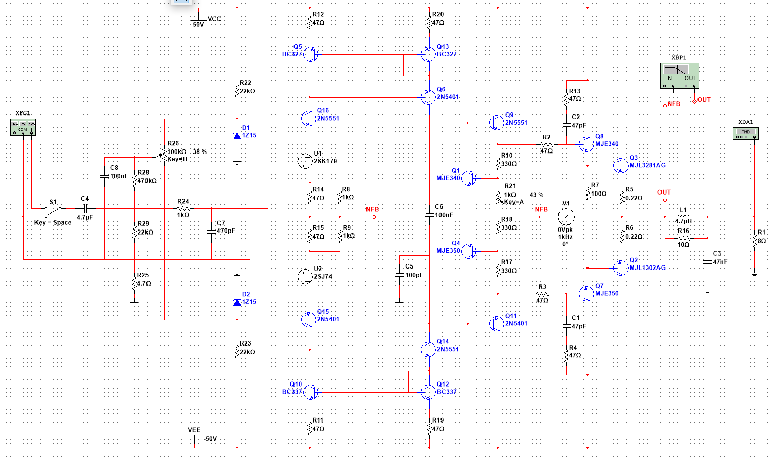

FET input is my new standard of all my designs. LSK170/LSJ74(A or B) are perfect here.
-91dB THD with 10Vp 10KHz output in my simulation.

1. Is C4 better than a servo?

No. I turn blind eyes to the DC offset right now. Later, I tend to add a trim pot to address DC offset instead of a servo. I like the simplicity.1. Is C4 better than a servo?

The circuit doesn’t prevent you using lower voltage. I would say +-25V would be the minimum. Lower than that you need to remove the cascode, Q15 and Q16.+/-50V is high.
I don't like that.
In my case, the VAS has no current gain. The compensation is through a single shunt capacitor C5 at VAS. Mismatching NFB paths is less an issue here.I dont like the idea of having separate feedback loops for the upper or lower half.
Have you analysed what happens when R8 or R9 is 1% larger?
Do that with generator and oscilloscope. I am interested in how the signal current or voltage in R19 or R20 will change.
In audio frequency, the input stage and VAS would both work in class A, as the EF3 puts very little load on the VAS. I doubt you can measure any current changes on R19 and R20.

I have removed C4 and added a trim pot for DC offset. I have updated the schematic in OP. Get 3dB better THD when the offset is minimized.1. Is C4 better than a servo?

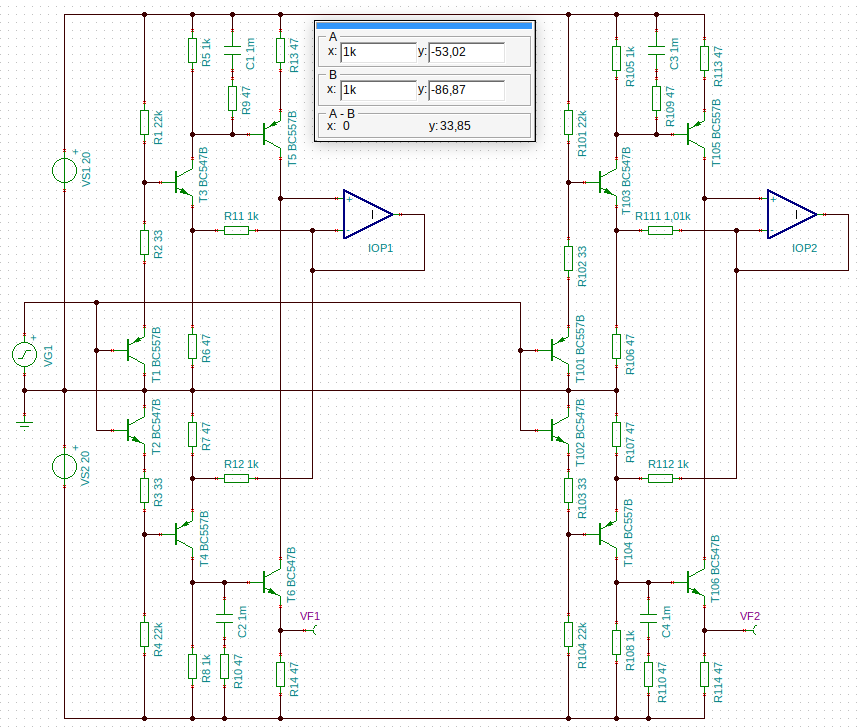

I have a memory of a disaster i made many years ago with 2 parallel feedback loops.
In order to avoid it with this amplifier that i find really interesting i made a simulation.
It is a diamond buffer but with near 1x current amplification. Followed by an ideal op as current amplifier. I believe your 3 EF is near that.
Anyway in the 100 schematic the open loop gain is almost 34 dB less.
Yep. I had bad experience with 2 parallel feedback, too.I have a memory of a disaster i made many years ago with 2 parallel feedback loops.
The issue lays on the choice of the compensation. Miller compensation doesn't play well with 2 parallel path. The way to address that is to avoid Miller compensation. Thus, I simply use current mirrors to drive the VAS, so that I can just use shunt compensation. The voltage gain can be written down like, Rout/Rf, where Rout is the output impedance of the VAS, and Rf is the current feedback resistor. The higher the Rout is, the more gain it has.

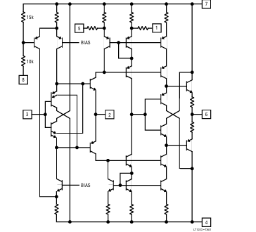

BTW, I was looking for the "Blameless" topology for current feedback, until I found the internal topology of the current feedback opamp LT1223.
We can just swap out the output stage to scale it for audio power amplifier.

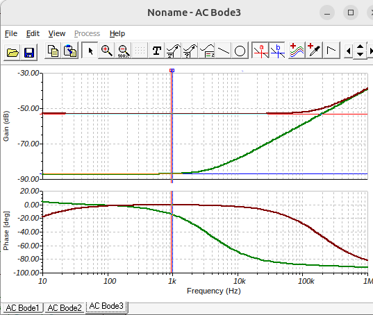

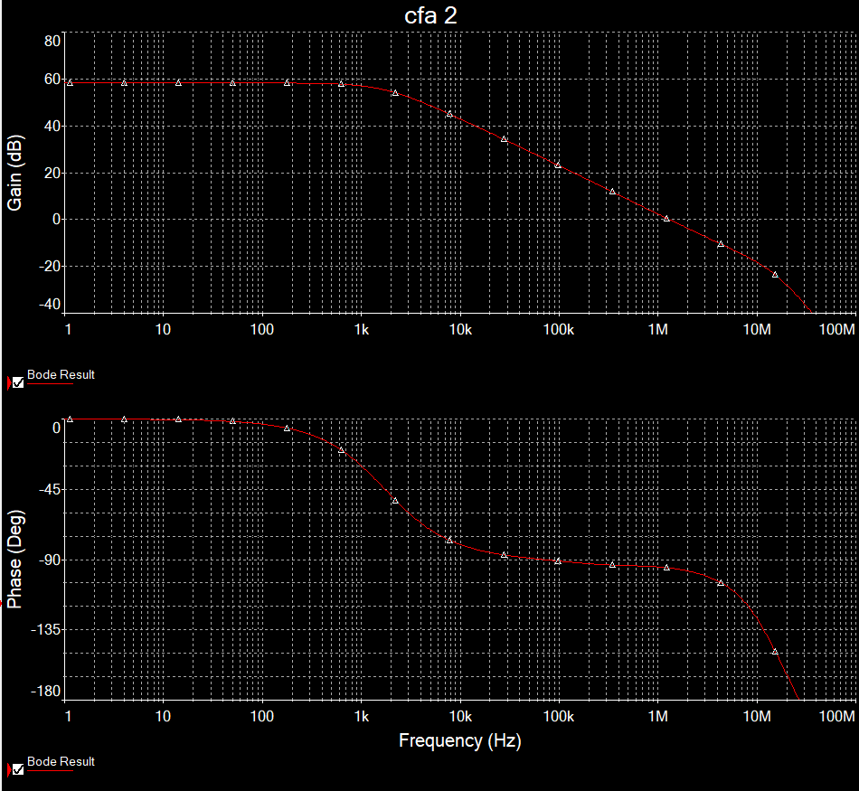

With a 60dB open loop gain to 1kHz...?my new standard
And a horrific phase plot.

It was caused by the enormous input capacitance of LSJ74, about 100pf.And a horrific phase plot.
To fixed this, basically the C7 from the low pass filter has to be >> 100pf, so that C7 could be dominate.
I upsized C7 to 470pf. I have updated screen shorts in OP.
